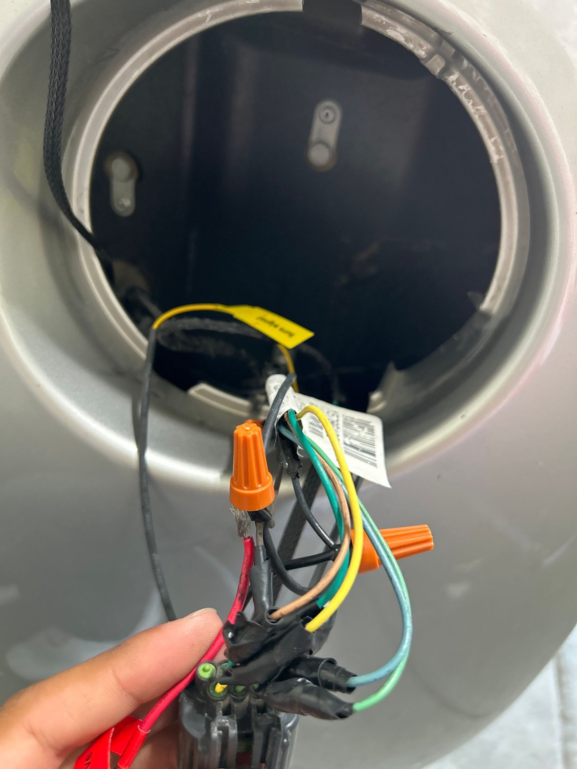

Help! I bought these (Striker) Taillights used. The red wire is connected to dark brown wire and Black wire to Black. Ever since I installed them my battery has died every time I turn the car off and I have to jump-start it. Should I just run the black and red wire to the battery or what wire can I connect red to? TIA!

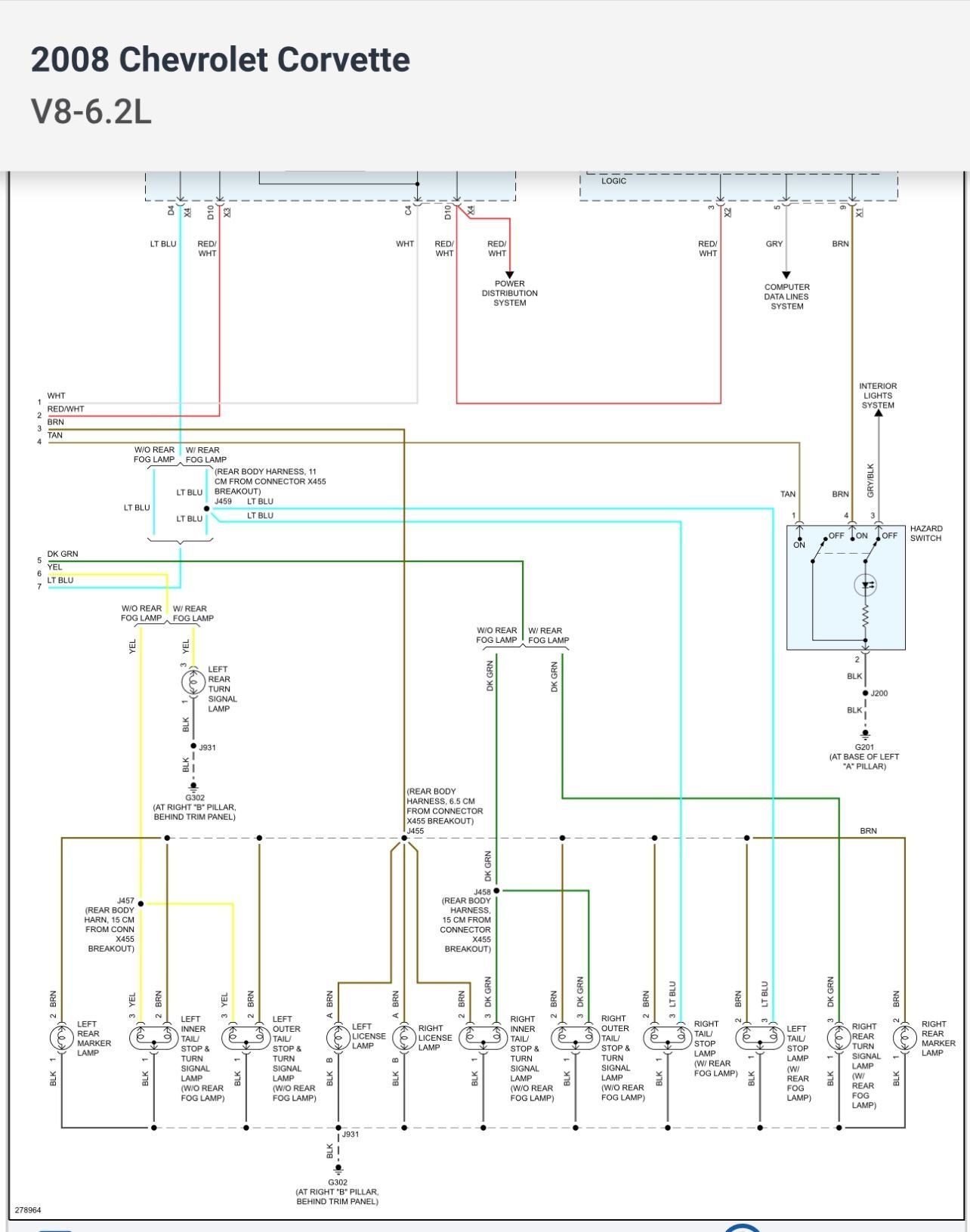

First off what year is your car ??…I don’t think that’s the OE connector but wiring diagram is below for an 08…looks like the person you bought these lights from was an electrician !!
I have a 2005 Base C6, thank you for the diagram!!
