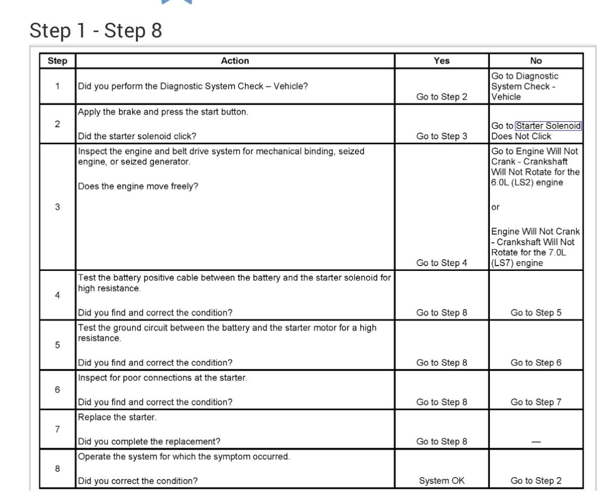

So is it the starter solenoid you hear “click” ??…I don’t know if you have any mechanical abilities but you may have high resistance in the starting circuit…do you have a 12 volt test light ??…if not and if you have high resistance on the negative side of the starting circuit take a jumper cable and connect it from battery negative to a clean spot on the engine block…see if the car starts…if you have the test light connect it to battery negative and probe the engine block while attempting to start the car….the test light should NOT illuminate…unfortunately we can’t diagnose this for you…if this testing is over your head find an auto electric shop in your area…highly doubt it’s a blown fuse.
