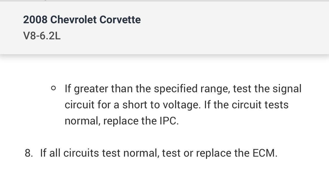

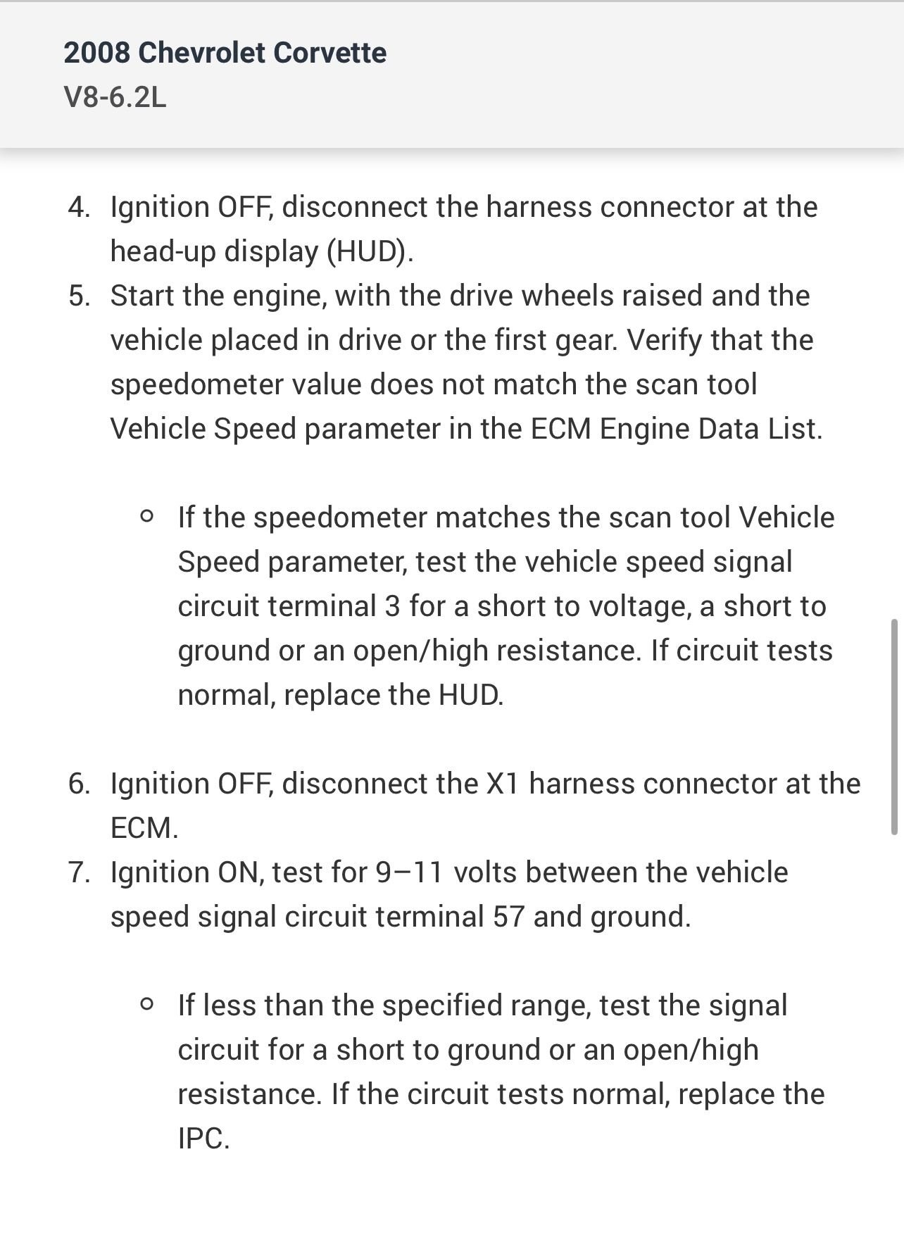

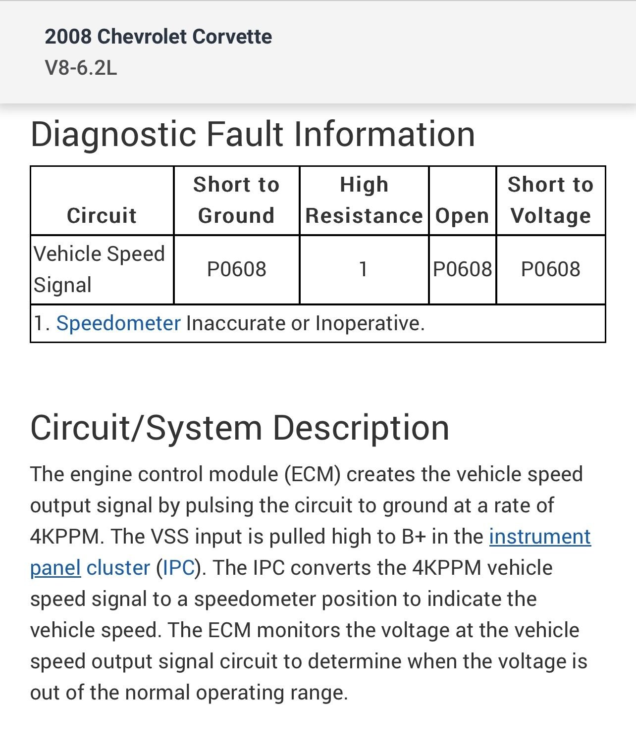

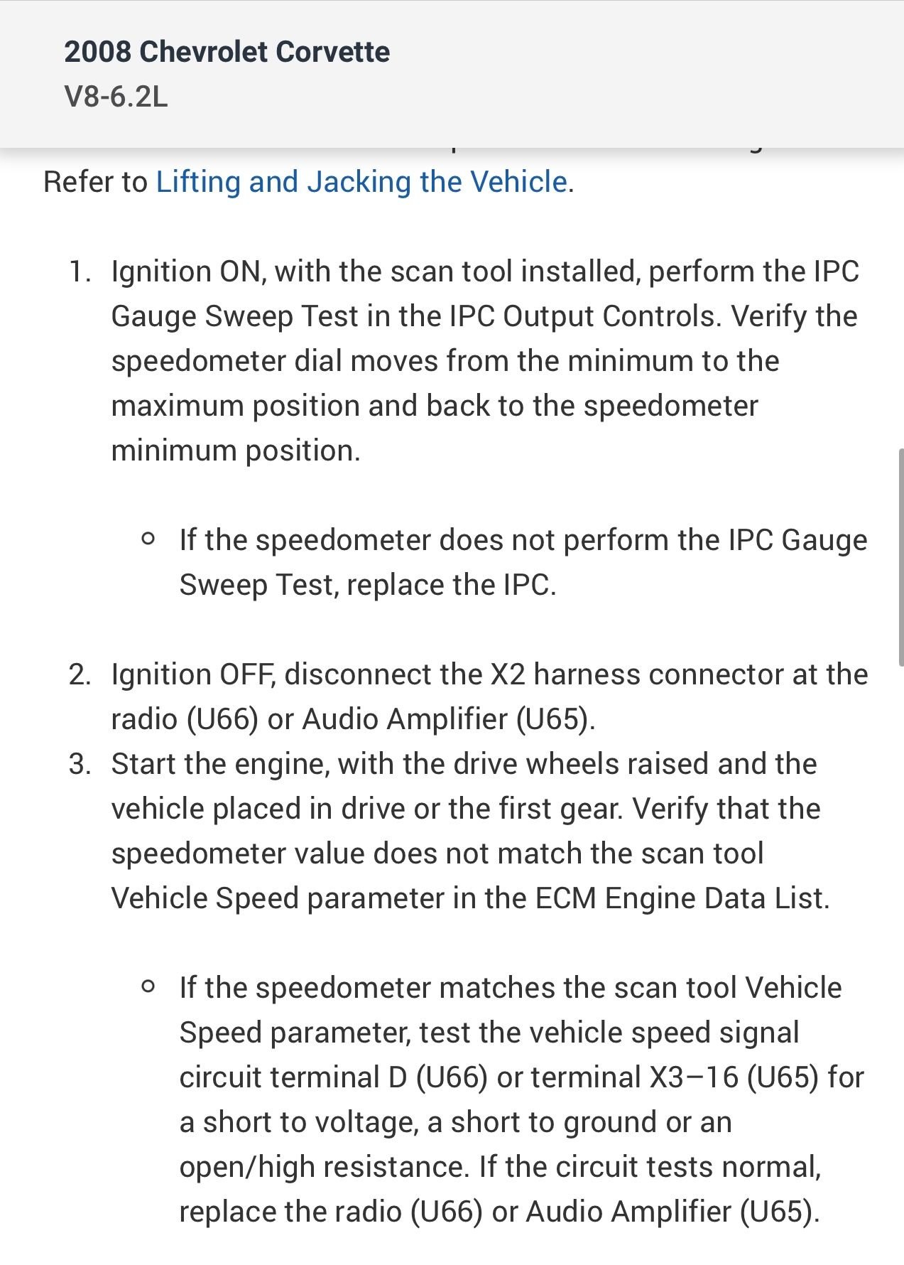

Here is everything you need to diagnose your speedometer but unfortunately we can’t do it for you…having a factory level or equivalent aftermarket scan tool along with some electrical experience will help in the diagnosis.
