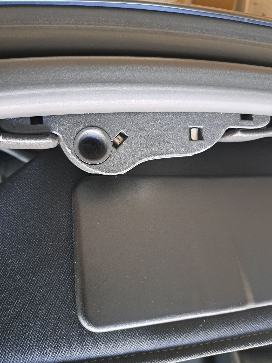

Just took a photo of the top front left latch just above the sun visor of my 2005 coupe and not only does it not look like the picture provided in this topic, it definitely does not contain a sensor....
What is the difference or am i just looking at the wrong position?
There are two metal tabs but these just hold a metal plate beneath that latch. And the roof doesn't have metal pins on that location so these are not to make any kind of connection.
Confused.....

The latches i have shown on my 2005 are clearly different than the ones posted before.
Does anyone knows were the sensor is located that detects if the top is on or off (if present) on my car, as it seem not to work.
Did you figure it out?
The picture from Dani is the latch area from a C7 I think. I vaguely can see the shifter and it looks like a C7. Yours looks like mine which a C6.

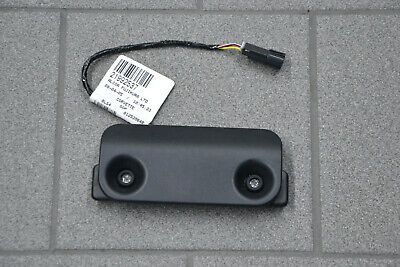

No picture available now but on the top of the front windscreen just above the rear view mirror and inbetween the two sun visors there is a small plastic cap which has two sensors in it, about 3 or 4 inches separated.
I understand these are the two intrusion sensors which detects motion inside the car and are part of the anti theft system.
When i park my car with the top off and open the door the message "intrusion sensor on" lights up. This is odd as this movement sensitive sensor is supposed not to get activated when the top is off to avoid alarms going off due to wind, leaves etc.
So my car does not notice the top off.
After a couple of minutes the alarm does go off, very annoying. I have placed some tape over the two sensors and now the alarm keeps quiet.
I rather have the system working properly but if i cannot find what is causing the intrusion sensor to get armed i just disconnect it.
edit: this is the cap with the two sensors:
