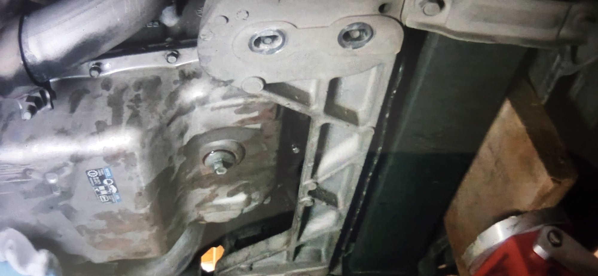

Since this operation is on my summer schedule a while back I grabbed this pic off the web. Seems you can remove the 4 rear cradle nuts and jack the trans/diff up slightly with a board (2x10?) just aft of the leaf spring and gain access to the difficult pan bolts. I imagine a swivel socket helps too. With this method you probably can still have your stands under the cradle.
Yes this is what I was talking about

I would not use the 2X12 method. Alternatively I would support the car frame at their locations and use the jack to control the cradle assembly. There should still be enough room to remove the oil pan bolts. It is a pita, its a shame the engineers didn't design this a bit better. One alternative going forward is using an aftermarket pan from LG Motorsports. What I like is increased capacity and easy to remove transmission oil through a drain plug. There is still a standpipe and center plug for getting the quantity correct. It is a bit expensive but for those of us that track our A-6's, it helps.
