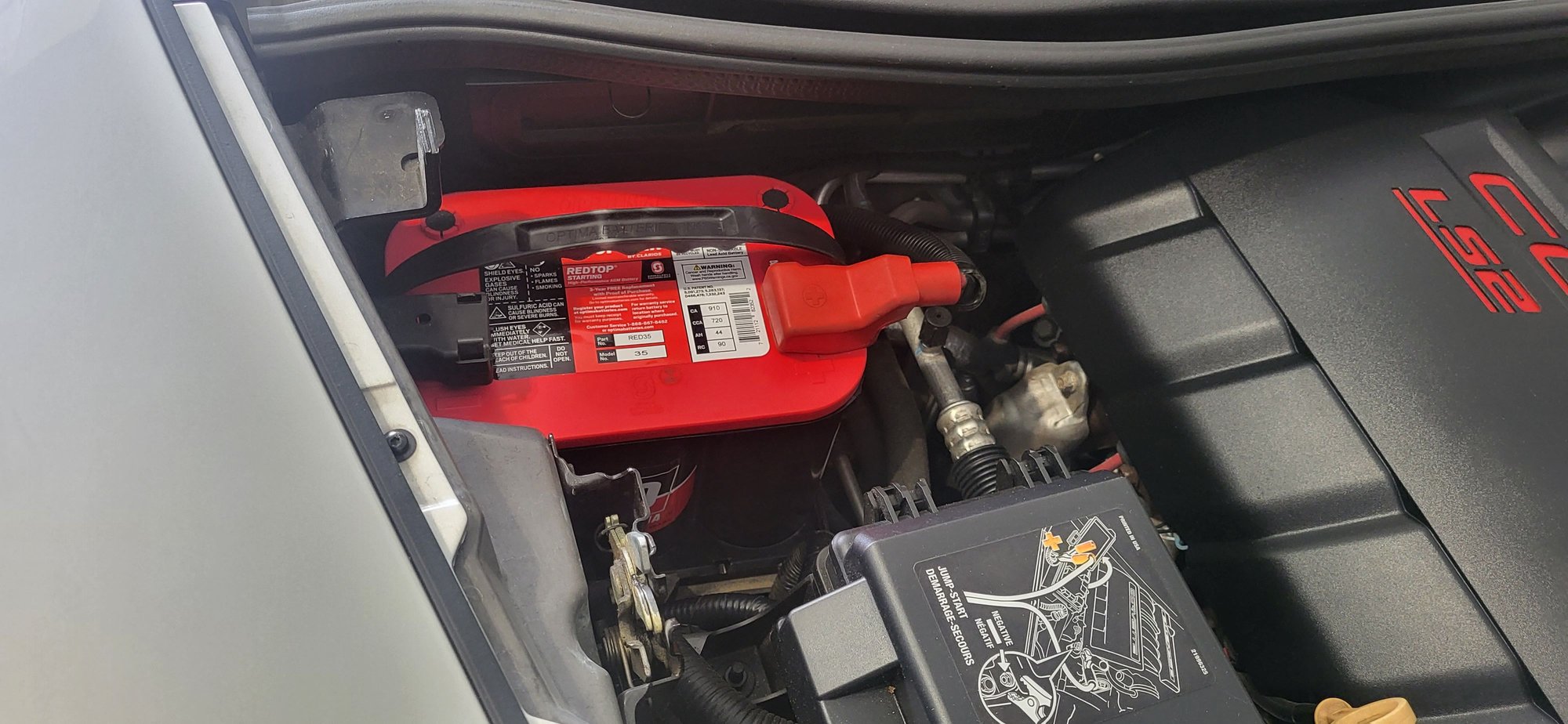

Battery replacement complete. Unfortunately the NAPA 35 dimensions are now different (taller) than what is listed on their website. . Went with the Optima due to availability (O'Reillys) and convenience. Keep in mind I traveled 1500 miles to accomplish this task and time is of the essence. Installation was straightforward. Fingers crossed it performs as good as it looks.

You won't regret the RedTop. I have one in my 2010 LS3. Keep receipt just in case you need to replace it under a couple years, for warranty etc. Our C6s have a lot of electronics that put some drain on any battery.
