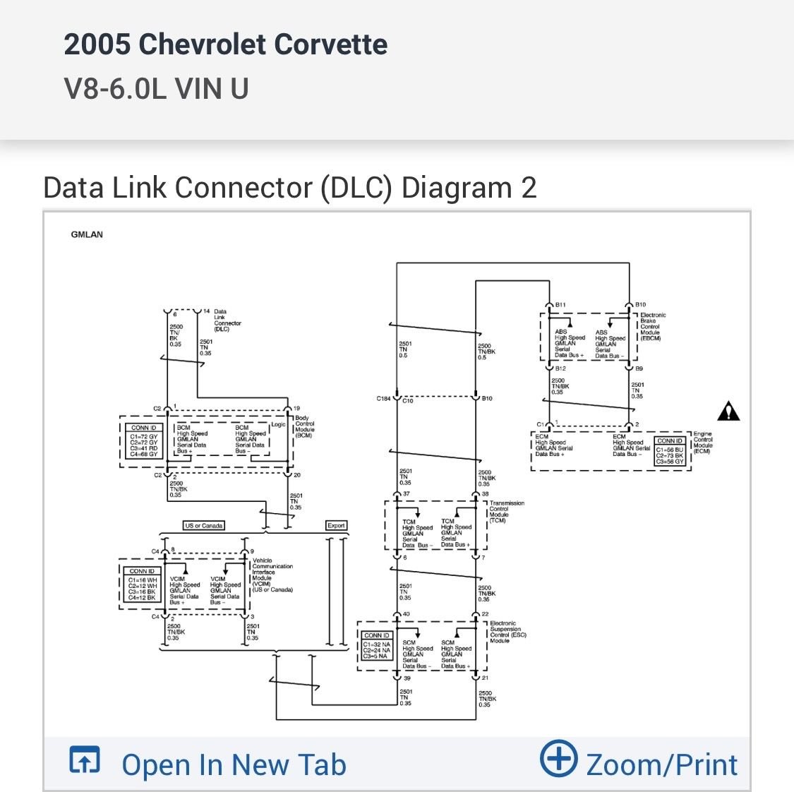

CAN bus information goes from terminals 6 and 14 at the DLC in and then through and out of each module…if the EBCM connector is not fully seated you will not have comm to it and then downstream to the ECM.

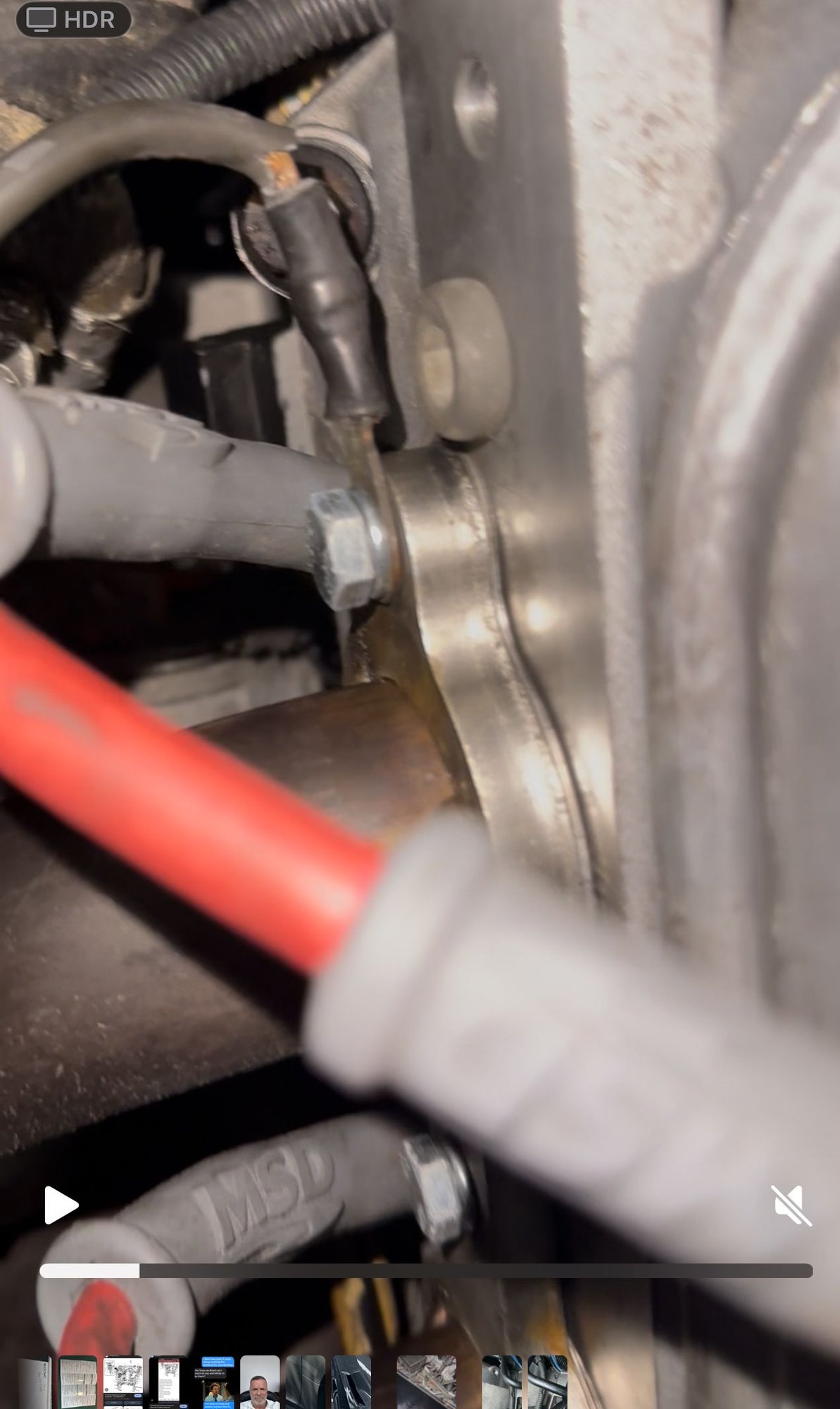

thank you !!! Definitely is a can bus ( ecm to bcm comms issue ) remote fob wont unlock my doors , but will recognize my name when slotting the fob into the glovebox. Guys at the shop put a lingenfelter box in it ( has a new 416 in it ) with a different reluctor wheel .
One of the grounds ( p side ) is on the number 8 header bolt . Chuck told me to look for stuff like this , Im assuming that ground should be on the back of the head not the header bolt , see photo .
There is no ground that should be attached to the header bolt…see where it goes to…if a shop did the swap let THEM figure it out !!…if you disconnect the battery and check resistance between terminals 6 and 14 at the DLC it should read 60 ohms and not 120…there are 2 each 120 ohm terminating resistors in parallel one at the BCM and the other at the ECM.

im working on it , returning the car to the shop is not an option. That bolt has an eyelet that is too small for the bolt opening at the back of the head . I just tried it . I have to find out where the other end goes to .

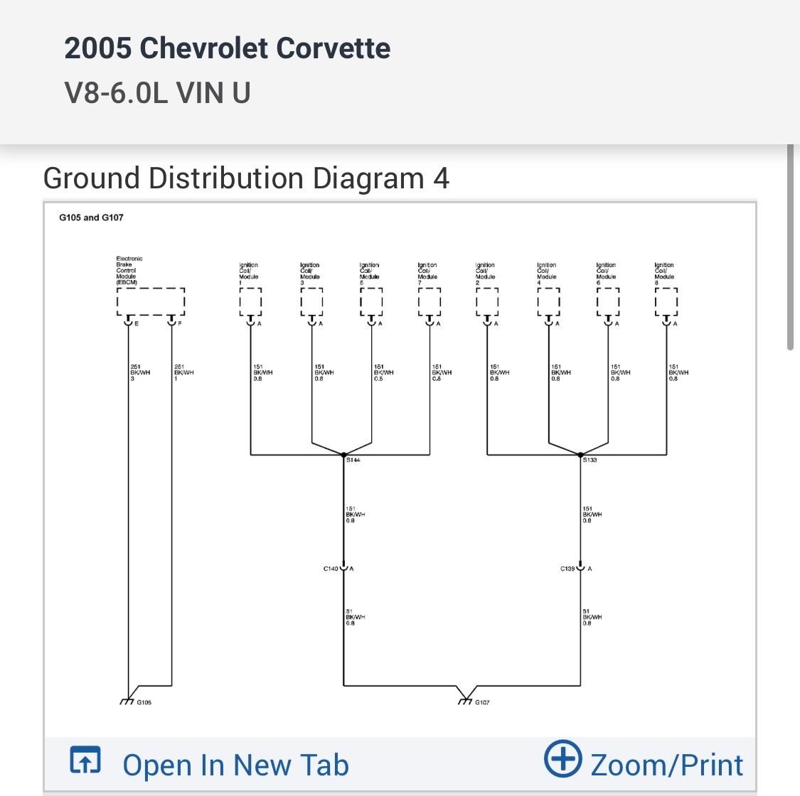

From: Cape Coral, Florida
There is no ground on the back of the block…G107 on the Drivers side is the ground for the coil packs and is the only ground that high up on the block.

This one is on the back side ( at least the eyelet ) is near the back of the p side head , wire looks to be around possibly 10 gauge , black and has a silver protectiv e sheath near the base where it goes into the loom

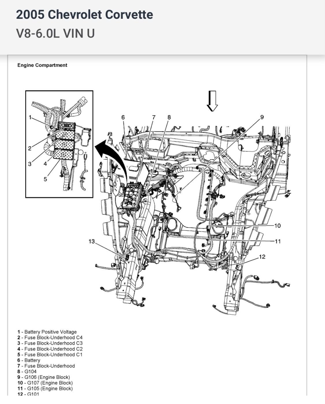

These are all the engine compartment grounds.

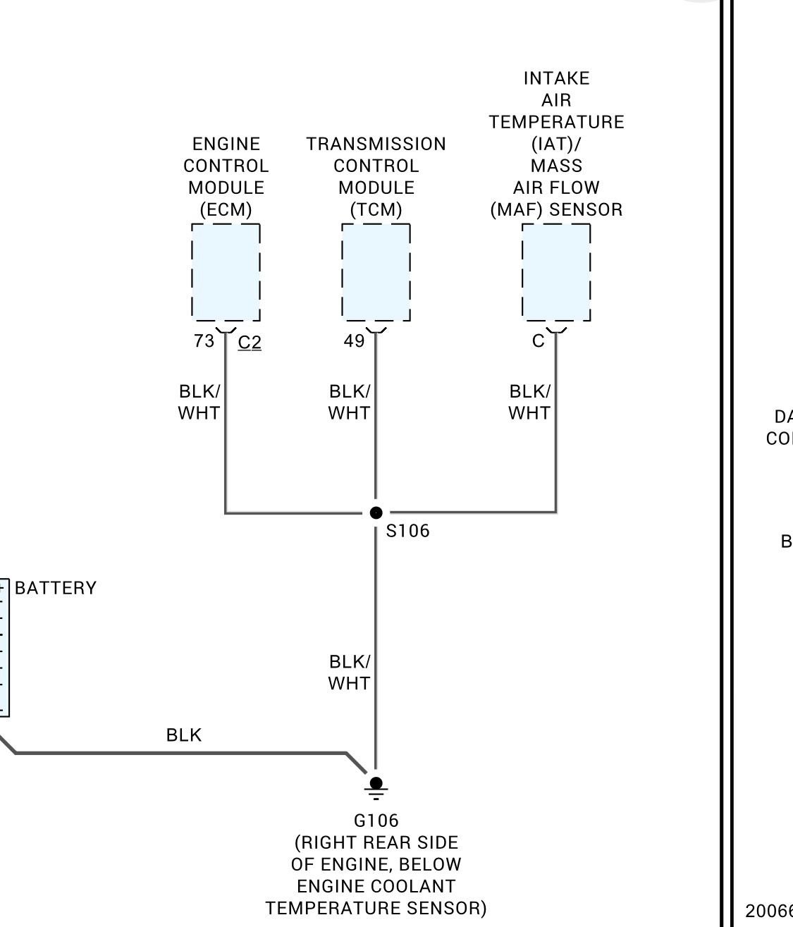

Its looking like g106 engine block ground , but its in the wrong spot . Probably causing the bad ground , will look at it again later . Sent you a dm . Thank you !!!
Old Dec 9, 2025 | 06:55 PM
C5 Diag's Avatar
C5 Diag
Moderator, Tech Contributor
Posts: 15,498
Likes: 3,999
G106 and its location shown below.
