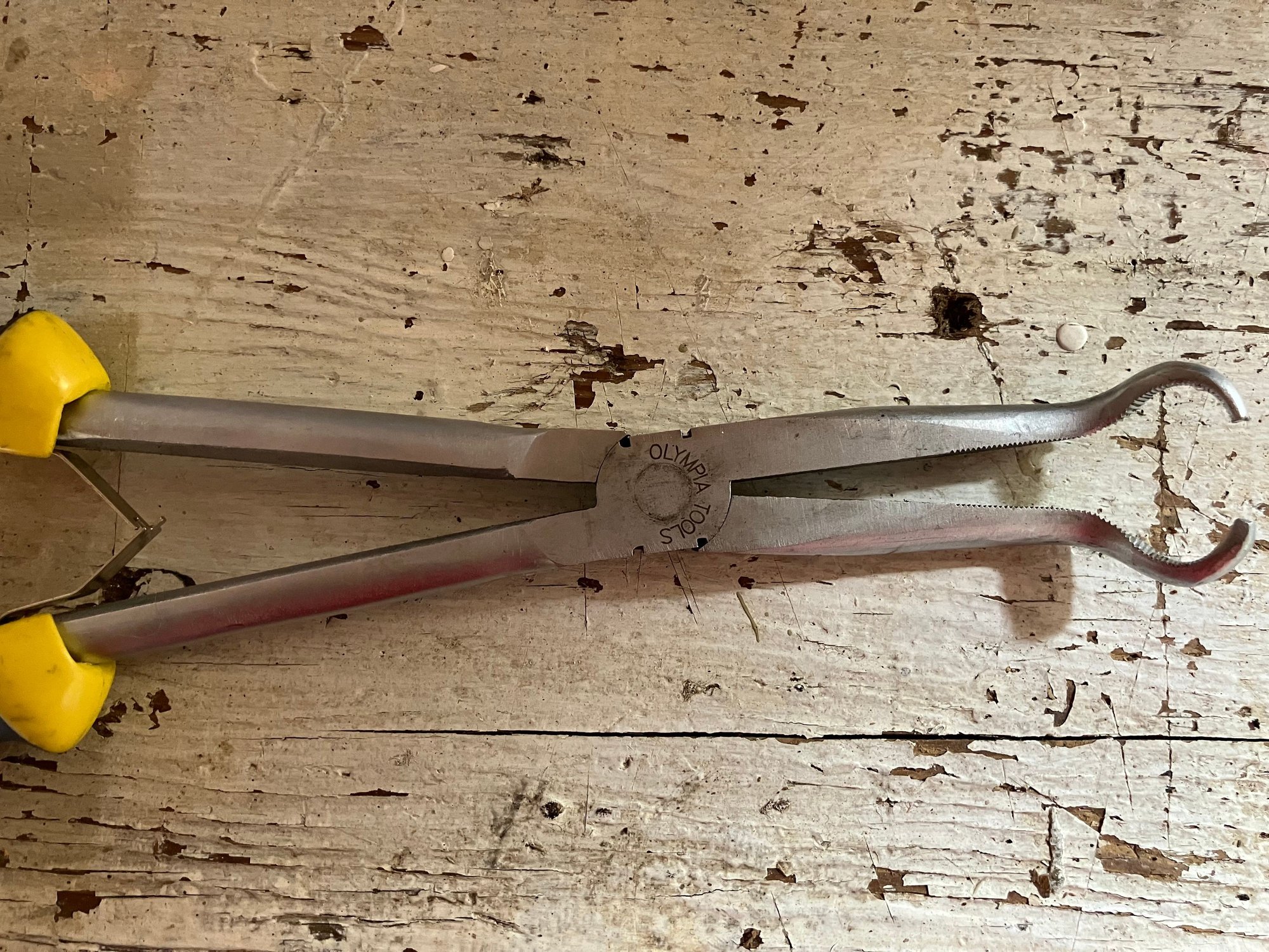

I use a pair of pliers that are curved at the end that follow the plug diameter contour. Let me know if you want a pic.

Here's what I used...

Thanks so much. I just got one and will try it soon. Thanks again.
