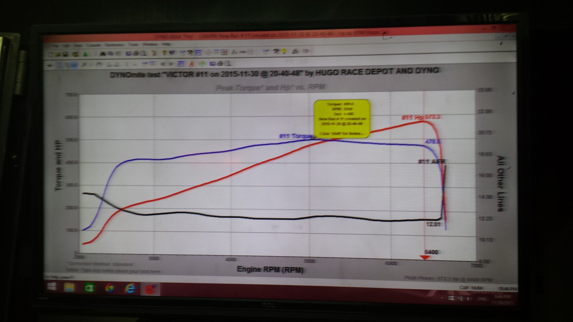

I have a A&A in my 2014 Vette Z51 with catted headers in this is my customer opinion:
Pros
The car gained almost 190whp with the basic 4in pulley
The power deliver is smooth and linear
It was my first experience tuning a C7, and I was able to make the car run like an OEM should do. However It took me 4 month to get it right. 2 days to make the power, the rest to make it run smooth. Sure If I have to do it again it would be way less time.
The supercharger is really quiet. No extrange noices.
The SC looks really nice on the engine bay.
Cons
It requires cutting your precious to fit the Intercooler.
The radiator heat extractor is forced against the intake tube
The ABS relocation requires some line bending.
No basic tune included.
Weighting all factors, I would go again with the A&A.

Some picture of my vette
