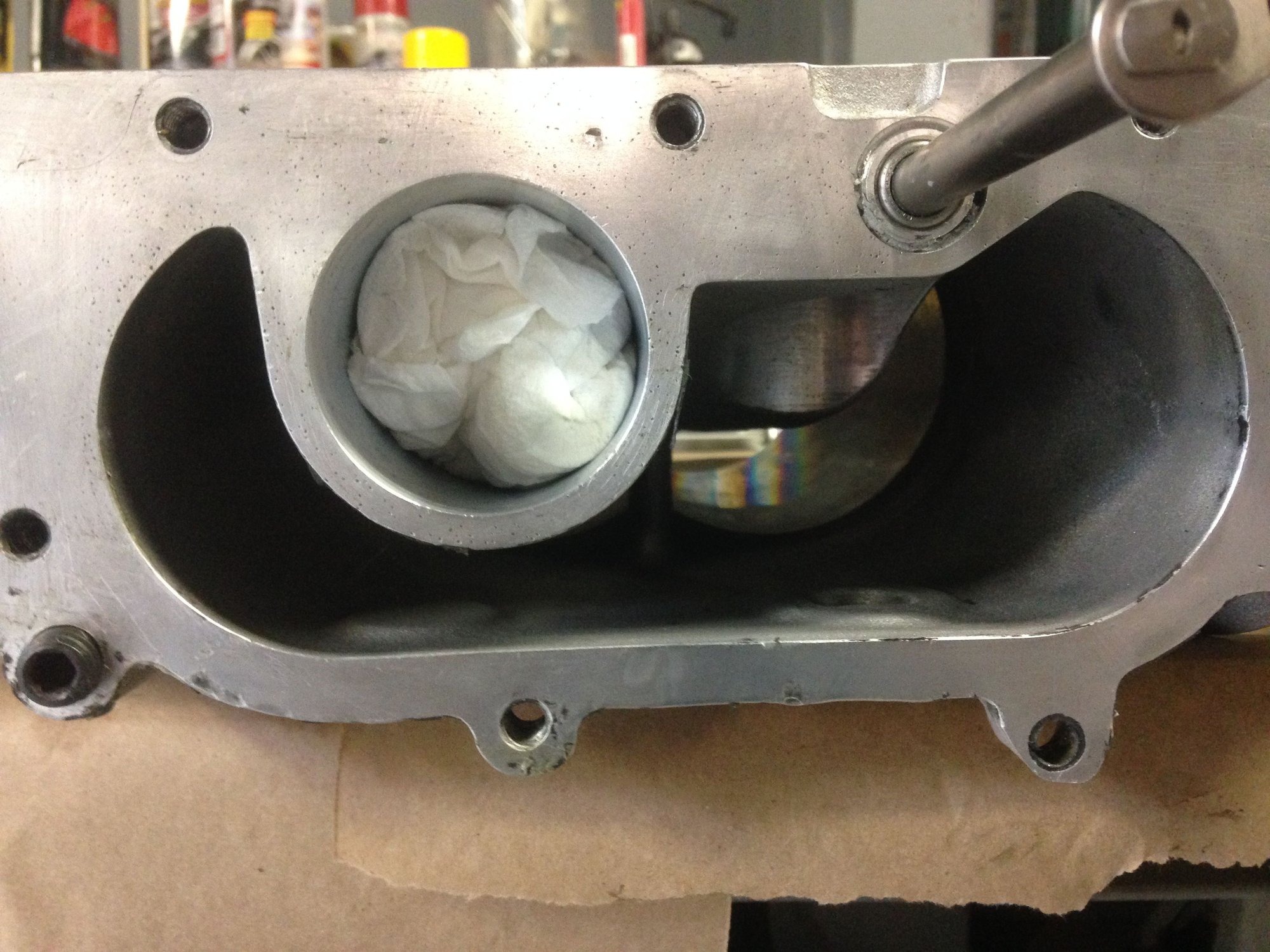

I have the part numbers for the pump, harness, and tank from edelbrock... Just have to look them up...
Here is quick comparison between the factory blower and the ported version I did..

Anyone have any questions on taking the blower apart, let me know, it's pretty straight forward...
I ended up porting the case, snout, runners, and just a clean up on the discharge area (mainly rounding it)

Nice I herd porting the blower only adds torque a good amount tho let me no if it's worth it or how the life on the blower will last
