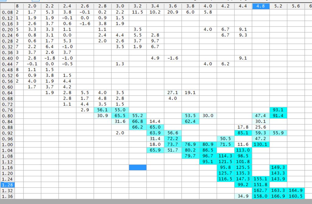

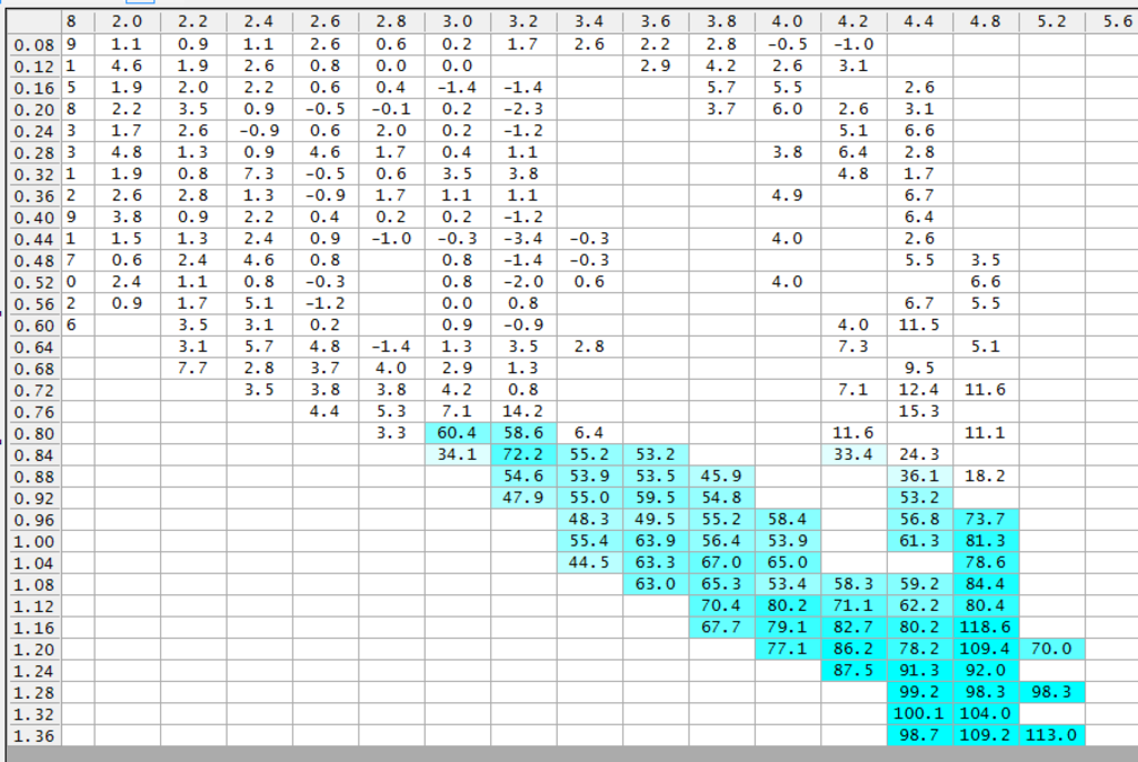

Old Jun 16, 2016 | 10:01 PM
schpenxel's Avatar
schpenxel
Joined: May 2004
Posts: 16,667
Likes: 1,209
From: Raleigh, NC
St. Jude Donor '15
The seals didn't fail on mine after a year, but the output pressure DID go down. I don't know if it was all at once or slowly over time. I logged it before and after swapping the pump (have a pressure sensor on the methanol system) and there was a real difference between the two.
Here are two screenshots of the before and after. Same day, same car, same everything except the pump.
