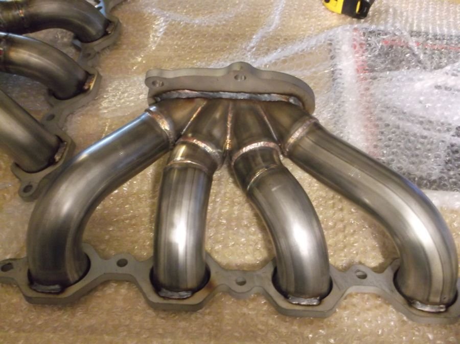

Figure I share my shorty header install in case someone finds it useful...
I've read several threads on the subject so I'm aware of the controversy. People are correct though,
it is a minimal power improvement for the cost.
Reason I went with them is cause I'm an idiot and want to avoid emissions test issues.
I had ESP, a local shop, install the Hooker Blackheart Shorty headers. ESP said there were no issues with the install so,
fitment was good. ESP did an awesome job BTW. Cost was 1400 for headers + install + 2 dyno runs. I paid 750 for the headers.

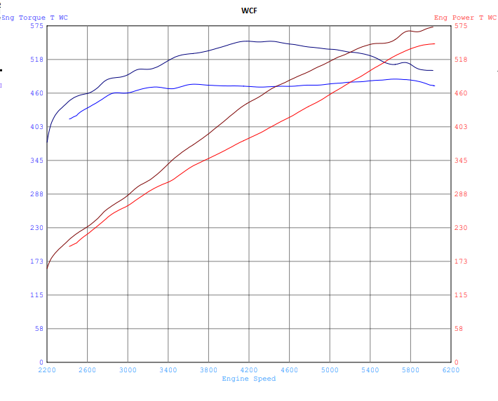

Didn't notice any sound change but dyno did report a power improvement. Pulls were done on a Mustang Dyno. Between weather
corrected and non-corrected, it shows something like 4 to 20 HP increase and 50-60 lb-ft torque.

The boost level didn't appear to change; still getting same 8-9 PSI. Actually peaks about 9.5 PSI.
Since the dyno runs looked good, trims looked almost the same, fuel was good (12.2 AFR), I didn't do anything with the tune. I
included the last dyno pull log for the technical/tuning inclined...
Here are all the dyno numbers and pics below....
Baseline Before headers (Very cool out, 45*F but dry)...
553/492 rwHP/Tq
544/484 rwHP/Tq WCF (WCF are lower because it was a cold day; was told anyway).
With Headers and new plugs (60*F, warmer but rainy/humid)...
557/534
573/549 WCF (Weather Correction Factor)
Performance increase....
4/42 HP/Tq
20/65 (WCF)
I'm guessing it should do about 600-625 on a DynoJet right? Which would be slightly better than the average Z06 so....Mission accomplished
Anywhoo...Overall I'm happy with them so far...
Anyone else try these out? Got better/worse results?

I didn't dyno mine but my results were similar. I had mine cerakoted before the install. The passenger side had the holes a little bit off and had to re-drill them. I couldn't get all the ARP bolts in and was afraid I'd strip the heads. I ordered ARP studs and that's when I found out it was the header. Drivers side worked with the bolts and then the studs. When I got it all back together the drivers side, where it connects to the x-pipe, was tucked up a little tighter to the bottom of the car than before.
I didn't notice any difference in sound or power but I didn't really expect to on the street. I did it to lose the 22 lbs at the front and that mission is accomplished. I put the DEI sleeves over the wires but I'm not sure they're necessary. I got the titanium cerakote and the titanium sleeves so it all looks the same.
One thing for sure I'd recommend is the ARP studs. They are money well spent. They also make it much easier to hang the headers if you're alone.
While I had everything out I also put in a Tick performance clutch slave bleeder. It's a really tight fit but with everything out of the way it can be done with the clutch and engine in the car. Then it's easy to bleed the clutch.
