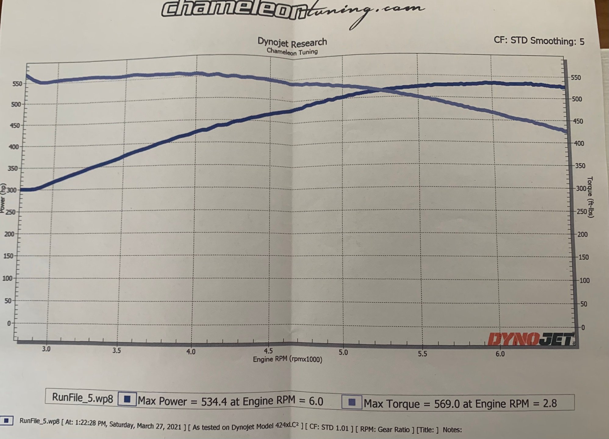

Not as much power as you LT1 centrifugal guys but not to bad.

That chart looks pretty good. You might want to buy some sticky tires 😃

Yeah but it pulls like a freight train from the second you put the foot down. Thats the beauty of a roots style. Good numbers BD.

It’s got a 95mm TB, TSP 1 7/8” long tubes, and meth just for cooling and playing it safe on 9psi. I’d like to make more power but I don’t want to do pistons so I guess this about all I’m getting out of it. Lol

Yeah I’ve had it on for years. The dyno sheet in the first post was after I added TB/headers and meth. The dyno sheet below was a different dyno with only the E force and a Borla X pipe, no other mods (but with 3* more timing then todays tune). Pretty close whp but flatter, with a flatter tq curve up 32wtq today.
