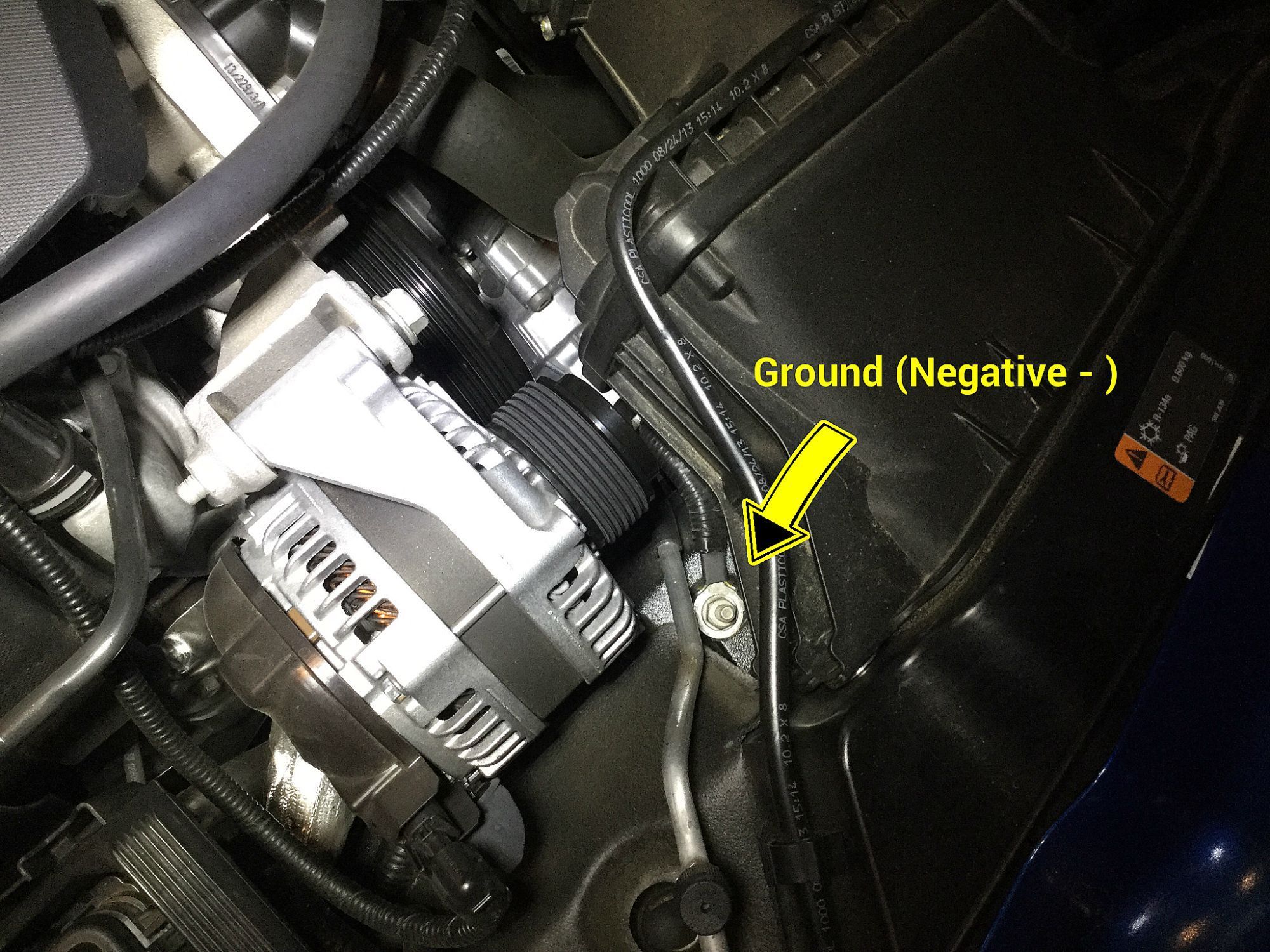

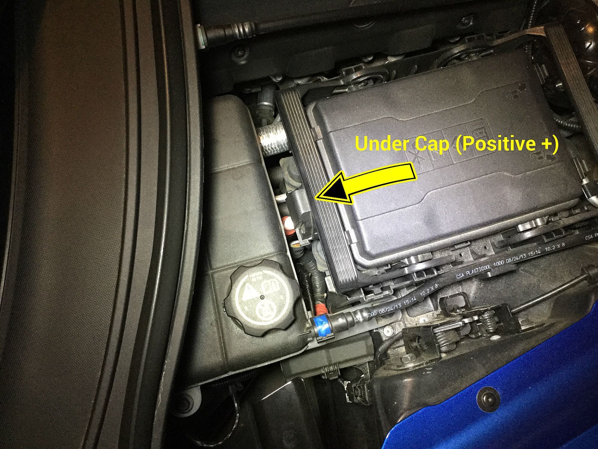

Funny, I just hard wired a maintainer to mine this afternoon. Because my C7 will sit on the hoist a lot this winter I ran the wire to the bottom under the front bumper. The charger is mounted on the hoist arm and plugged into a outlet on the hoist. I used the ground pictured above but used the positive feed terminal on the alternator.(under the rubber boot) I would have used the terminal on the fuse box but I would of had to lengthen the harness. Remember, if you are hard wiring, fuse and secure the harness as if it gets damaged it has full battery voltage to short out. I don't like draping a cord over the front fender, the spoiler, or rear fender.

Originally Posted by StevieK
The positive terminal is alongside the fuse box on the passenger side closest to the windshield. It's covered by a plastic cover which you can flip up from the fender side.
This is the positive terminal after flipping up the cover
Here's a good ground located on passenger side down and to the right of the alternator
As I heard that this is a good place to tap for power (charger, license plate show and go and front sensor) does anyone know the size nuts that will go over these lugs? I just want to connect over the top of these hugs and add an addition nut on top?
Thanks Jim
Old May 12, 2014 | 11:24 AM
  #43
Glen e's Avatar
Glen e
Posts: 11,825
Likes: 2,477
From: Ft Lauderdale
yes I've done it.... M8 13 mm

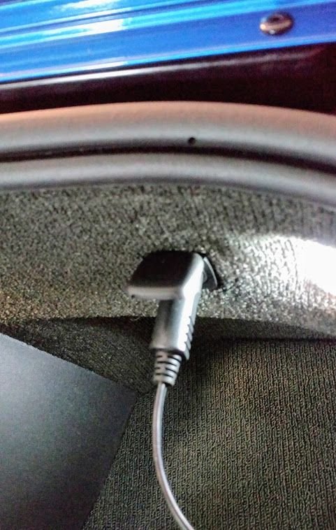

Originally Posted by mt. view
I took the lights out in the back, they come out easy and unplug easy, then I set the hatch down, run the cord down the side with some towel protection, then put the cover on..works great. I would never slam the hatch shut with the cord in there
I've mentioned this before and will repeat now. With your finger or similar, you can trip the latch in the receiver for the striker and the light will go out. Then just rest the lid on the rubber seal. When ready to close the lid, open the latch with the key fob or with the button on the rear bumper or the dashboard. Light goes on and your ready to close the lid.

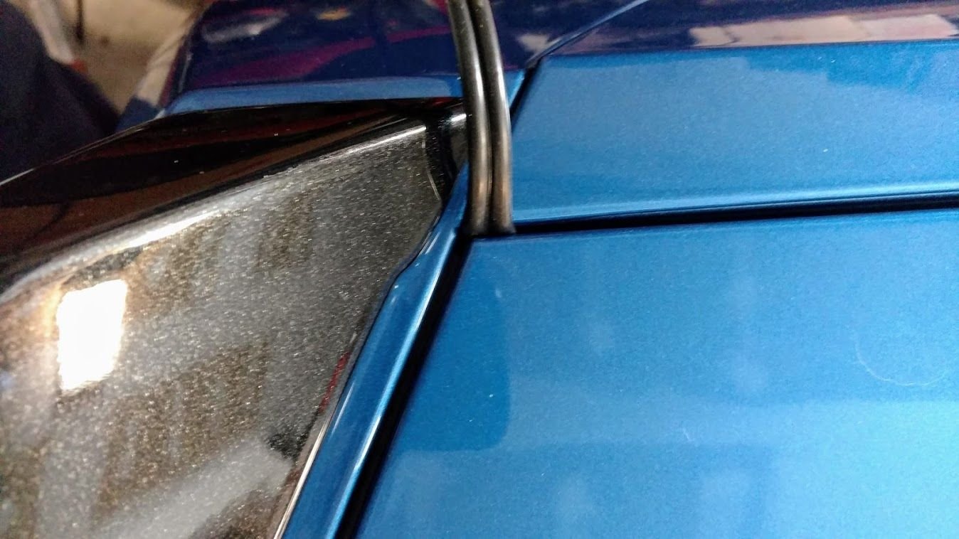

I am still using my $20 wonder from Pep-Boys. I used it on my C6 for 4 years with no problems. My tender has a fairly long cord to which I added and extension piece. I plug into the rear port, run the cord under the carpet forward and leave it behind the passenger seat. When I need to use it I open the passenger side window 1/4" and run the cord out to my charger that hangs next to the car. I adapted my C6 setup. I really don't like the idea of closing the cord in the weather stripping of the hatch. Eventually it may deform or damage the stripping in some way.

Originally Posted by mbaessler
For some reason I could not see these pictures. Can you send them another way please. I know this is an old post and understand if you don't have them anymore. I have a 2017 and was wondering where under the hood the + connector is. I would assume I have to find a good ground. Thanks
Both +/- are on the passenger side.
P.S. This is my '14 C7, I'm assuming this hasn't changed through 2017
