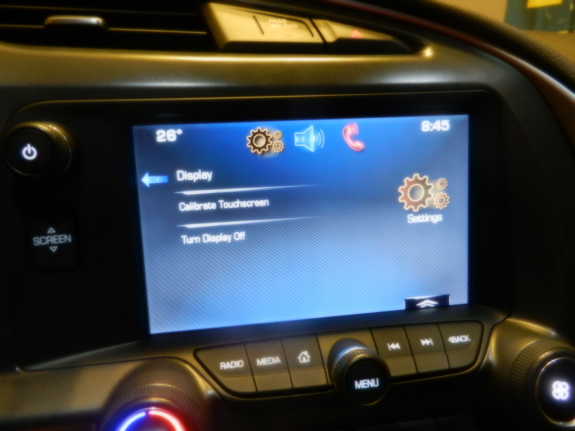

Definitely don't see Display/Mode (here's a pic)
I PRAY there is no issue with the DIM DISPLAY as that's the one that bugs me most.
Thanks for the info pals
The dim display is the instrument panel, not the center stack display for the radio. If you find that your dash panel gets dim for a period of about 30 minutes at dusk have your dealer install PI1101B. Depending upon the age of your car, it may not have it installed from the factory.

I know the dim problem is with the driver console only...that pic was to show I have no Display/Mode options

Got he auto memory recall on ignition fixed.
They say they fixed the "dim driver screen" problem.
I still "do not" see Auto/Day/Night for Display/Mode.....
Anyone with a screenshot?
Having tons of flicker screen issues so gotta go back and get screen replaced I guess.
