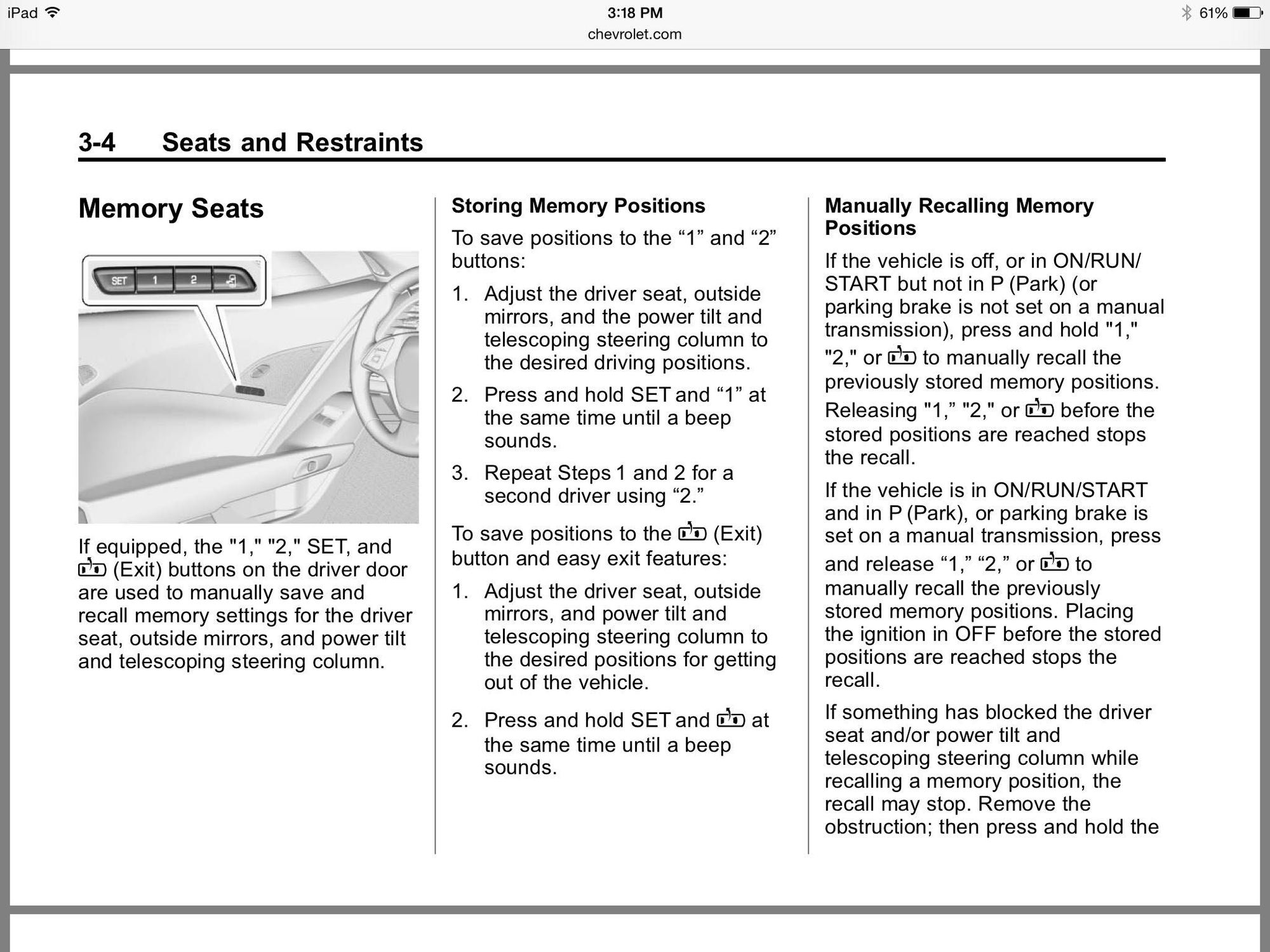

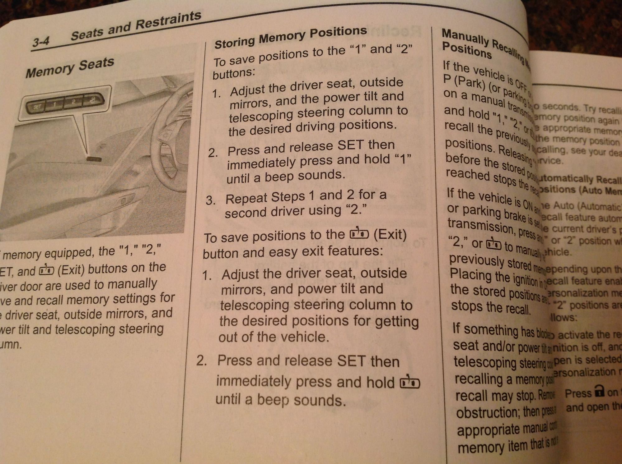

That's where it gets interesting. I went out and checked just to make sure and mine works with the press and release of the set button then the press and hold of the position button. I then went and looked at the printed manual (I know, why would I want to do that.... ) and this is what it says:
Then I pulled up the .pdf stored on my iPad, downloaded from www.chevrolet.com.
Obviously there are 2 versions of their firmware and I doubt it's documented how to determine what you have installed. No wonder this is so frustrating.......
