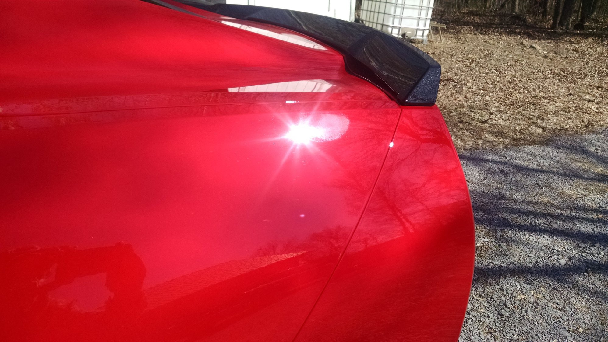

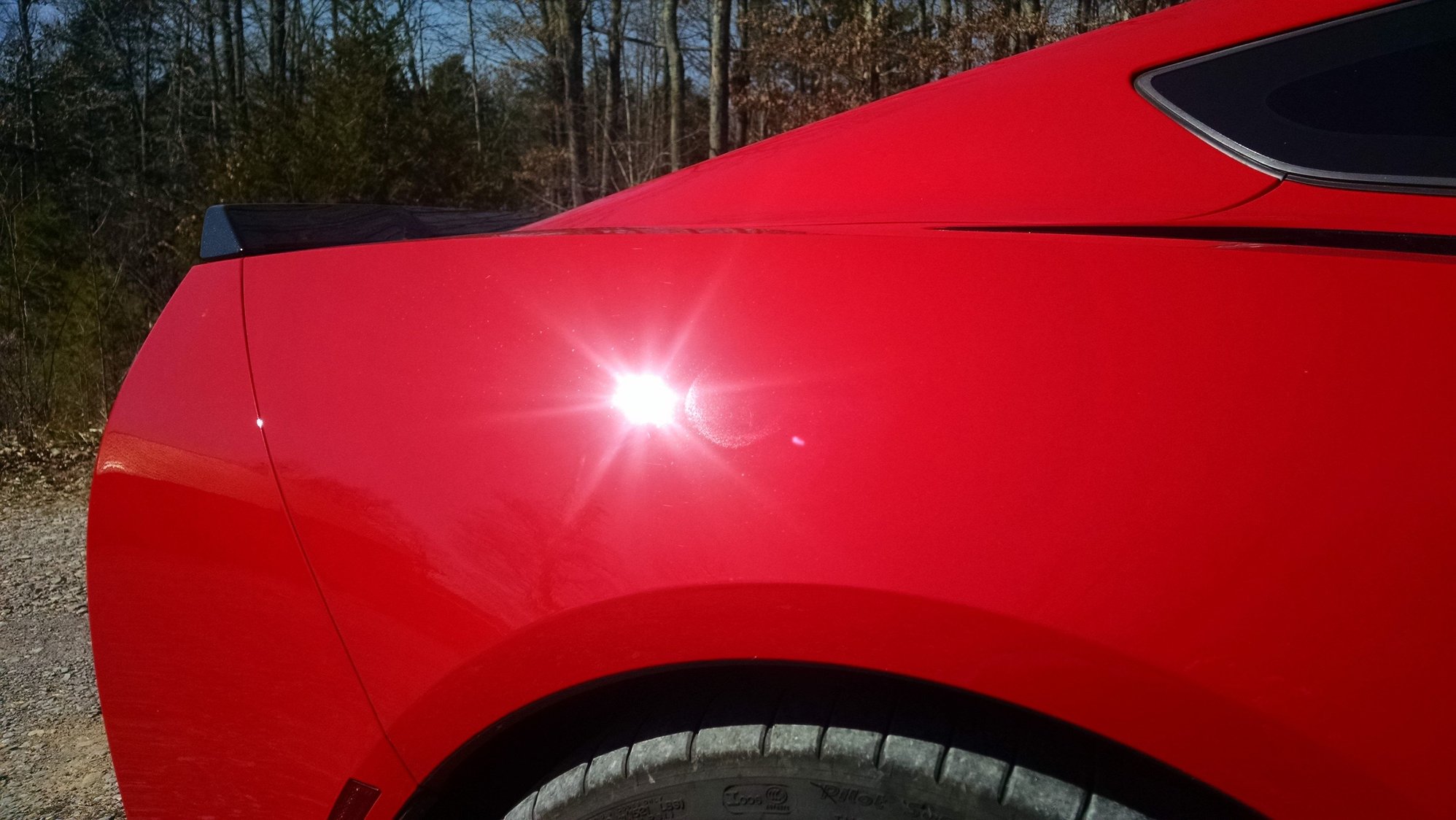

I have 3 places that look like frost in bright sunlight. Can't see them unless you have a lot of sun and your at the right angle. It was hard to take these pics in bright sunlight at the right angle when you can't see the phone screen.
Anyone know what causes this? I'm betting it was a repair at the factory. I noticed it the first week I got the car.

If it's underneath the clear, it'll need a respray and a lot of work. Pray that it can clear up with an orbital and some meguires 205.....what's the dealer say?

I didn't take it to the dealer yet because of the hassle and it's hard to show unless you have the sunlight. At the right angle it shows worse than in the pics.

My DSOM had the same thing you describing, a frosty look. I was able to polish it out, without too much work. My car did have some paint corrections done at the museum, in areas that became frosty looking. The frosty look didn't show up until got the car into the bright sun light. I hope yours is also an easy fix.

Im no expert but it may be that slight repairs were made to the panels before or after painting at the plant. They do fill and level here and there minor irregularities before sending them to the paint shop. I would try a clear coat safe scratch remover on a wax pad over the areas and after several treatments see if it looks like the spot improves at all. If not you are in for paint repair.

I had one area on my left front fender that looked exactly the same. It was caused by paint correction at the factory as evidenced by compound found under a trim piece on the fender in the engine bay. A two step polish with a orbital cleared it right up. I wouldn't let a dealer touch it.

Ours has the exact same thing. kind of a circular thing, one on hood, two on right front fender,one on rear hatch in front of spoiler. sure hope these buff out.

they will buff out
