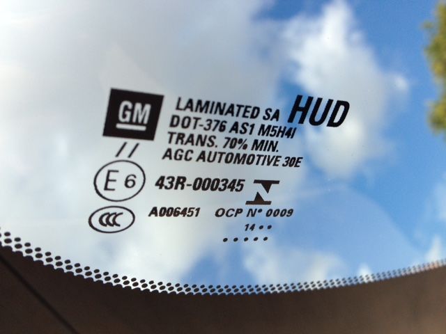

Originally Posted by rmorin1249
In most cases you are better off going to an experienced glass place rather than the dealer. Many dealers have little to no experience replacing auto glass. In fact, many good body shops farm out the glass work. USAA uses Safelite and I have had several good experiences. You may need to specifically request on OEM product in the case of a Corvette with HUD.
This is the OEM HUD part...
