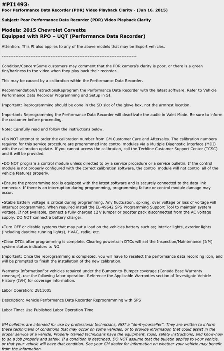

#PIT5383A: Various HVAC Issues (Reprogram K33 HVAC Control Module) – (Apr 30, 2015)
http://vitalysmobileautodiagnostics....let-gmc-models
#PI1473 A8:
http://vitalysmobileautodiagnostics....rolet-corvette
#PI1375C Entertainment System Update:
OP-Code 2880168 Updated programming 3880168.9 ma 0590 6589
http://vitalysmobileautodiagnostics....sb-issuesbluet

I had the PDR update done yesterday. Clearity is much better and I didn't care for the valet sound recording anyways. You can't use the voice in court in my state so that's why they removed it. Plus the fact that I live in Michigan and it's illegal to wire tap someone without consent of both parties so they can actually sue me for it.
Example--someone were to do something stupid in my car while on Valet mode(crash it, burnout,---misc), I would have a case against them with video. If I would record the audio portion, it would cause me problems and get thrown out. I would get sued for illegal wire tap instead of him paying for damages to car.
"Currently, about a dozen states require two-party (or all-party) consent for audio recording. The other states require only one-party consent, which effectively makes the Valet Mode PDR system legal to use as currently implemented. The states requiring two-party or all-party consent are: California, Connecticut, Florida, Hawaii, Maryland, Massachusetts, Montana, New Hampshire, Pennsylvania, and Washington (state); in Illinois, Michigan, and Nevada the matter can be complicated, depending on the context or circumstances."
PDR Update: PI1493
Op-Code 2811005 Updated programming 2811005.4 ma 0590 6589
Thanks BOBSZ06 for the info on it.
I also had the transmission clutch updates done too.
Trans shift update completed.
A8 Update: PI1473 (document ID 4162003) and is dated May 5, 2015.
Op-Code 2810175 Updated programming 2810175.5 ma9 0341 6589
