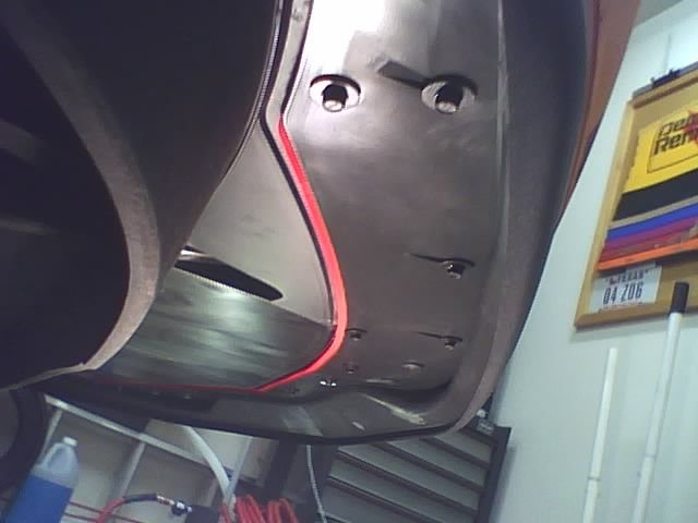

The OEM GM Front Splitter that is sold above comes pre-drilled.
When making the installation you will use about 6 of the OEM GM Washer Screws that already hold the front bumper in place. Then I drilled 5 to 6 additional holes to secure the middle of the splitter.
Instead of using the metal (aluminum rivets) supplied with the spitter, I drilled and used the 5/16th plastic scrivets that simply push in and lock down.
Some drilling is required to secure the splitter. It is an easy installation and much simplier than would be expected. Some other CF members as stated in the previous posts used a lock type fastener.
Takes about 20 to 25 minutes and can be installed by one person, but a wife, son or daughter can always lend an extra hand.

Yes, the same GM body screws that hold the bumper cover on, can also be used to fasten the front edge of the splitter, with the exception of the two center holes because there is no access from inside the bumper cover.
The factory screws have an unusual thread (M4.2-1.41 x 20 mm), so I used a 1 inch flat washer, and the GM U-nuts (to match the threads), and attached them to the screws from the backside of the bumper cover.. Easy to reach inside cover and put the washer and nut on.

Yep, you need to go ahead and attach the leading edge.
Remember the whole purpose of the splitter is to provide downforce, so over time it will start to sag.
Plus, if the leading edge sags, more likely you will drag it on something.

I just attached the existing screws and added 5 up front. Just drill and screw. Test drive at about 100mph and everything is fine.

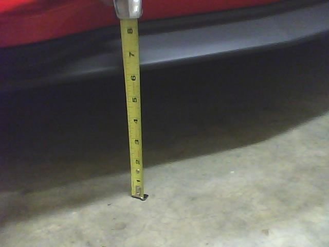

So I finally installed the poverty splitter today. So glad I got it. I decided to put some 2x4 on the ground and have the front tires roll over it to lift it several inches, enough to line up a power drill. The bumper was really easy to drill, like going through butter. The plastic is really thin. I messed up one of the rivet, so I'm actually missing one on each side. But the rivets look like they really secure the part. Some plastic bits expands a lot and secures the thing in place. I'm pretty satisfied with this $100 part. I took it on the freeway going 80mph for about an hour going from San Francisco to San Jose and everything looked perfect.

Height of splitter when installed still allows 6 inches of clearance.
