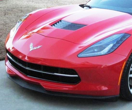

Likes: 1,304
From: Windermere FL
I just went through this. I came to the conclusion that the GM OEM Z06 Stage-1 splitter sourced off FleaBay for about $105 shipped is the best because it has some flexibility to it so it will not crack as easily as some of the aftermarket ones that are made of CF or fiberglass. Plus it is cheap enough to be considered a consumable and replaced if damaged. It really makes the car low to the ground but it does not seem to scrape at least yet for me. However, with all the construction trash here on the roads it is only a matter of time before it gets whacked.
I did attempt to paint mine Carbon Flash, and it really requires it to be sanded smooth first (I did not) if you paint it. But the results using rattle cans was pretty good considering the cost - it just would have looked better if I would have sanded it smooth.

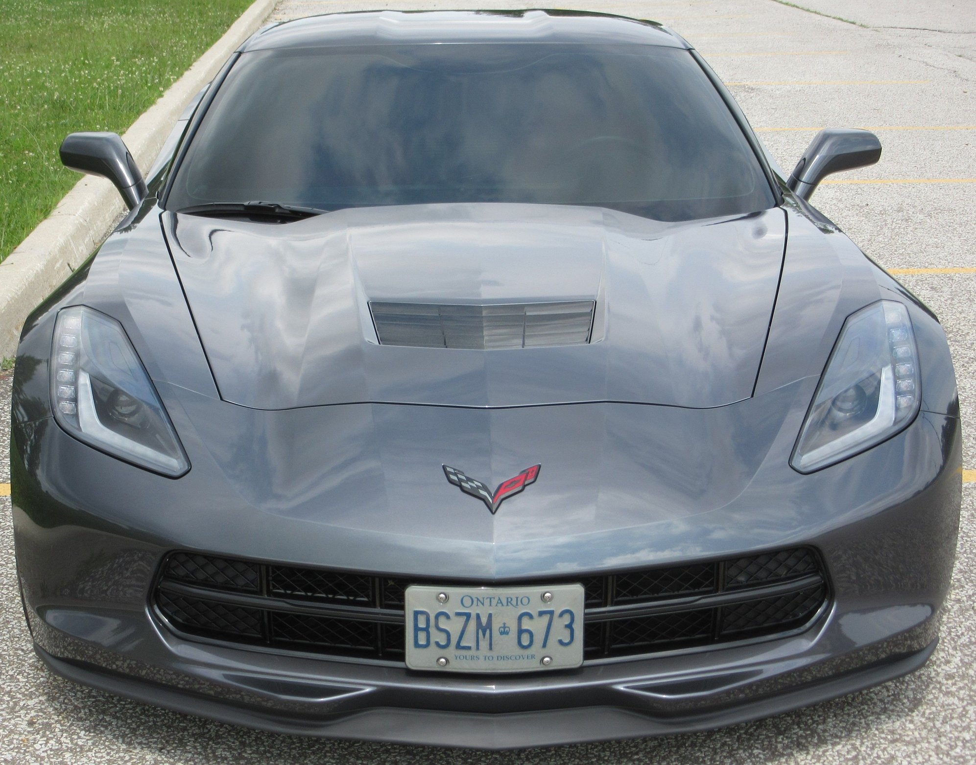

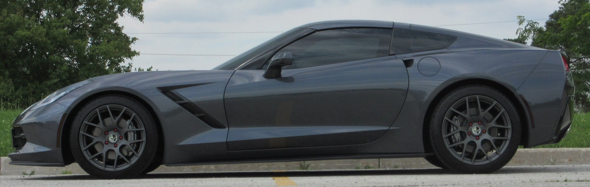

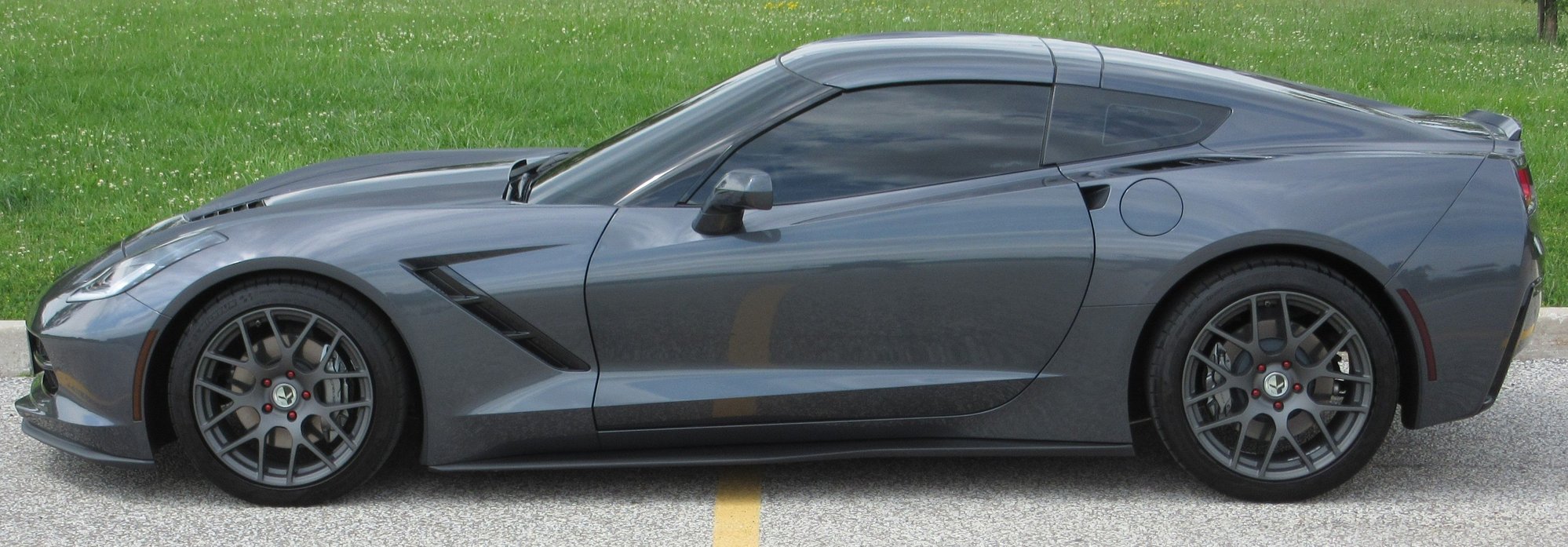

GM splitter
ACS Zero7 satin black rockers
slammed stock bolts

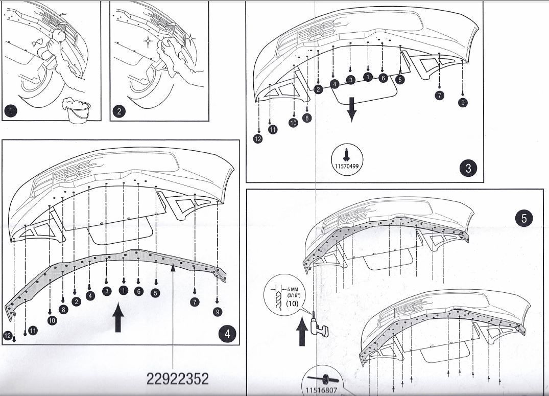

Low price for the OEM GM Front Splitter Part # 22922352 complete with hardware which is the rivets to secure the splitter.
This is from a Corvette Forum vendor gmpartsdirect.com
They will not be undersold and will price match any competitor that is priced lower than them. They sponsor the CF and have a small banner on the right side of the screen under the category "PARTS".
They are located in Winston-Salem, NC and are the parts distribution center for Flow Automotive Group (Flow GM Auto Group) which owns several dealerships. Servie is excellent and shipping is quick.
Many of the CF members who put the spliiter on their car purchased it here.

Does the GM splitter come with the plastic pop rivets?
Aren't there existing holes underneath to just screw it in?
Old Jul 9, 2015 | 03:12 PM
DAFFYDRUNK's Avatar
DAFFYDRUNK
Joined: May 2012
Posts: 2,904
Likes: 315
From: Cedar Falls Iowa
Half of them are there while the others you drill out and either attach with the supplied rivets or do you own thing. To be honest I'm lazy and only used the existing holes. So far its survived a large retread at 73 mph and speeds to 110 or so. Had to plasti dip it after the retread incident. It got scuffed good but didn't break. If I was gonna go really fast I'd for sure fully bolt it up.
