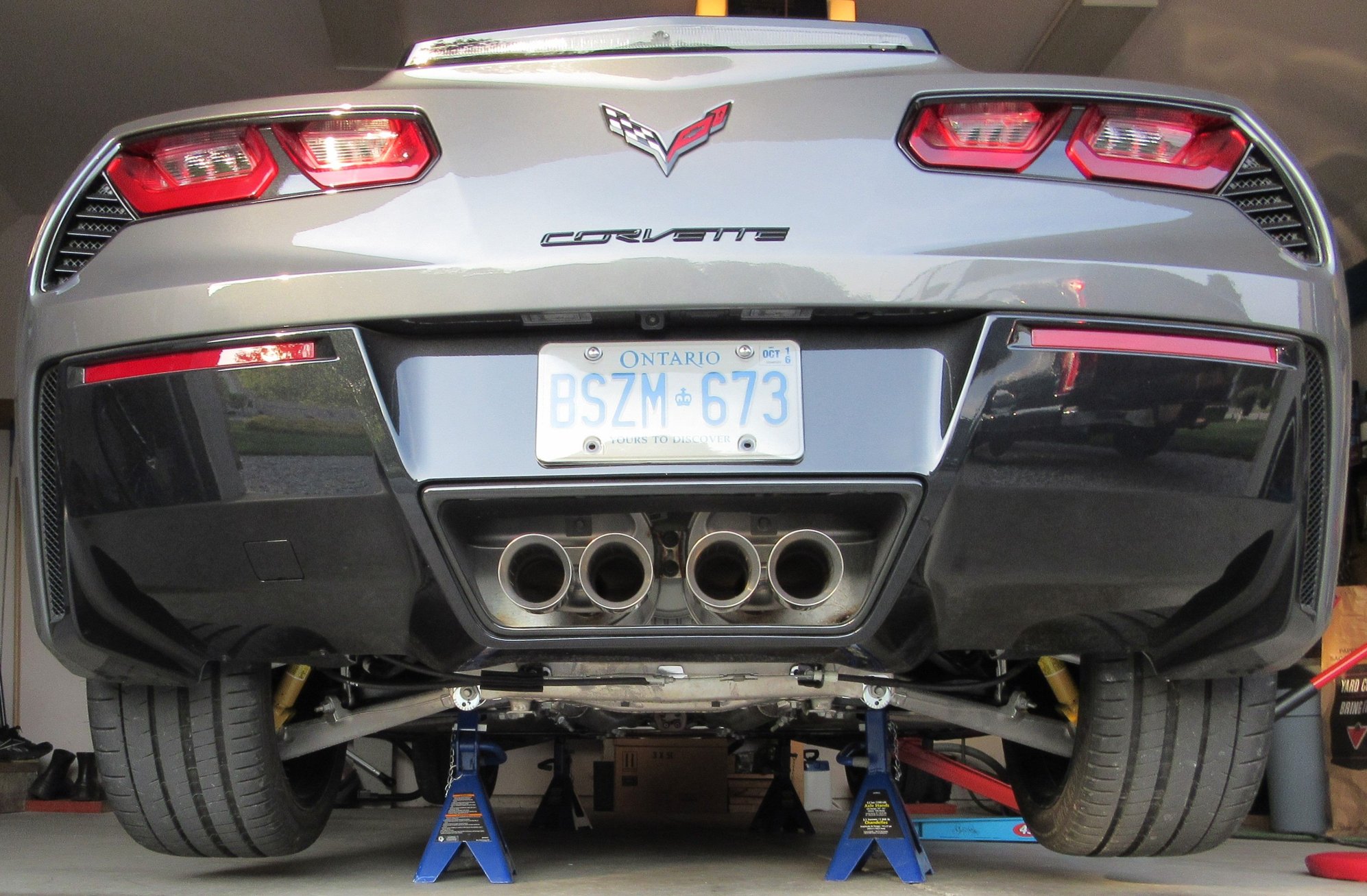

On 4 stands in 2 minutes w/1 lift per side > super easy
3.5 TON stands extend to 21" > 2 TON low pro/hi lift rapid pump steel jack = ultimate combo
