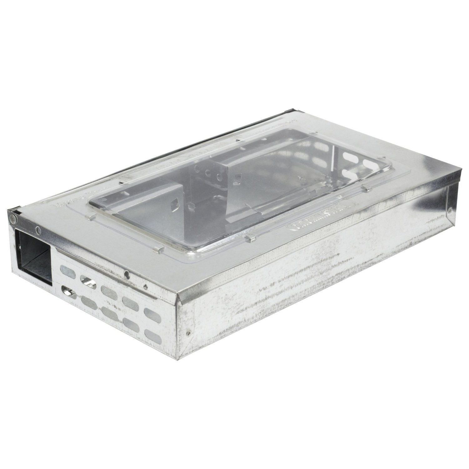

I had most success with the linked humane trap below. Put some chocolate in it and you will get every single mouse in your garage guaranteed. Mice are like humans, they love sweets and can smell chocolate across the room. No poison, no dead smell, no guts on the floor, no further money wasted on poison and the last trap you will ever need.
I had 5 in the trap after the first night. 2 more a day later and since then all are gone. I put the trap in a box and actually gave them a nice ride out in the woods. Not sure they enjoyed 0-60 in 4 second a couple times.
Amazon.com : Catchmaster 612 Multi-Catch Mouse Trap : Rodent Traps : Patio, Lawn & Garden Amazon.com : Catchmaster 612 Multi-Catch Mouse Trap : Rodent Traps : Patio, Lawn & Garden
