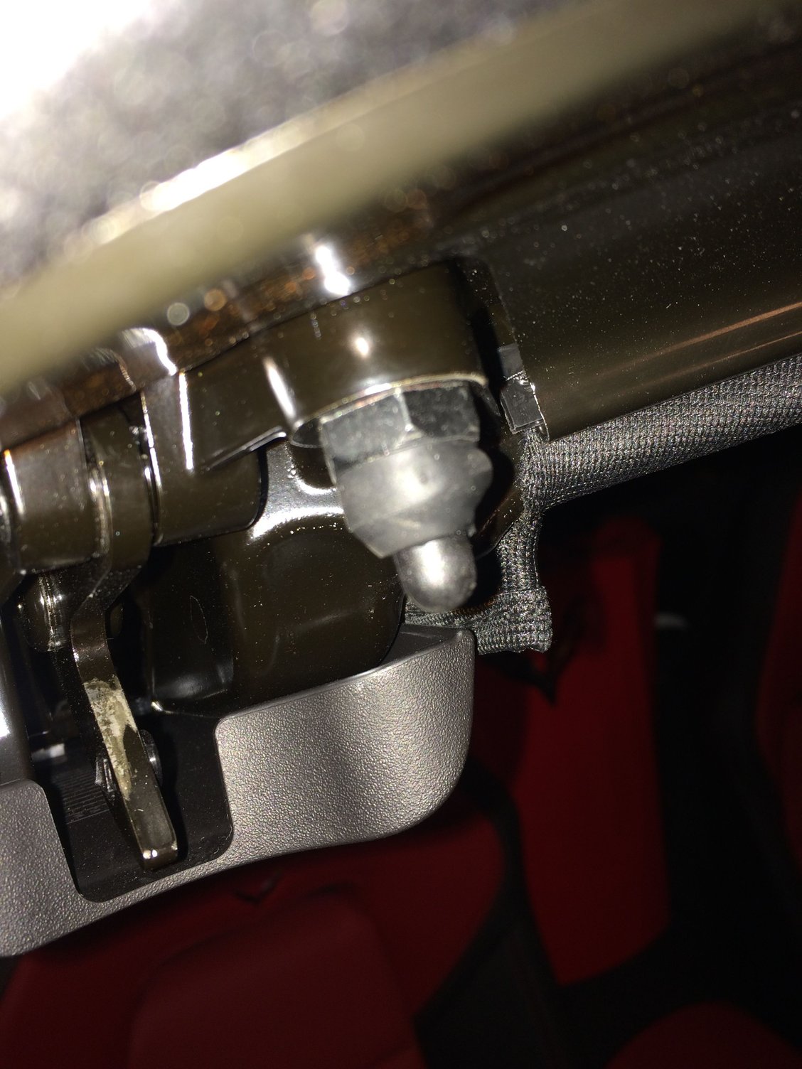

Does it make the noise when the top comes down and hits the windshield?
If it does do you have these rubber boots over the pins? They are there to insulate where the pin goes into the dished receiver. Here is a photo of my pins, also does the top hit the header evenly or does the passenger side hit first?
I'll have to look for the boots, I have never noticed them. As far as the top going down evenly, it appears to lower on both sides at the same time.
