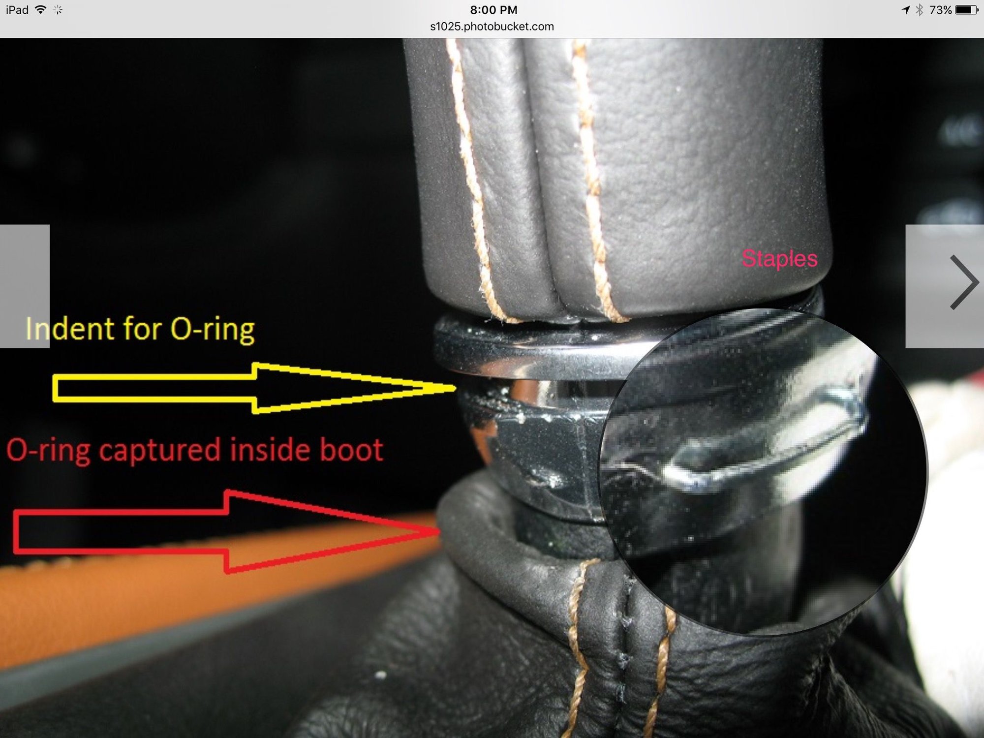

Originally Posted by JerryU
You'll see his solution was to remove the ****, pop off the boot and then secure the boot with a piece of wire tightened in the groove you can see in your pic.
This is how I repaired mine. Holding up fine now.

It's the staples that holds it on.
Dude, mine had no staples....where do you get this staples thing? The O-ring holds the boot against the ring.

Likes: 283
From: New York
Mine had staples also, crappy way to attach it.
You don't see the staples in your own picture. I magnified it in that big circle. Mine didn't have an o-ring and non of the people I know had an o-ring.
Not "my" picture. Picture I found on the internet to use to show the O-ring and indent. Yes, this picture shows staples, but my car had none.
"had" the staples

My brand new 17 Z had a nylon wire tie... After the MGW install, just turned it inside out a put on a new one only tighter...
