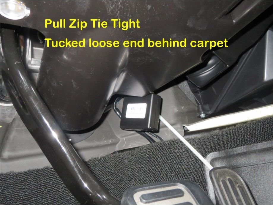

Good thought. Mine is working fine but have enough wire to find a place to use a zip tie.
PS: Thought if the forum vendor could post on the Corvette Forum when his product is for many cars, I could at least check out the feasibility of his idea! After looking I found a great spot to do as he suggested! Will update my PDF but here are a few pictures with captions of what I just did!

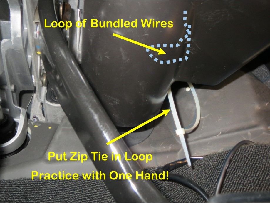

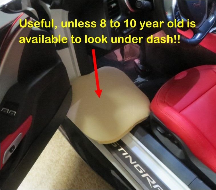

Unless you can find an 8 to 10 year old to look under the dash upside down, suggest you get a cushion and lean into the car sitting on the ground outside!

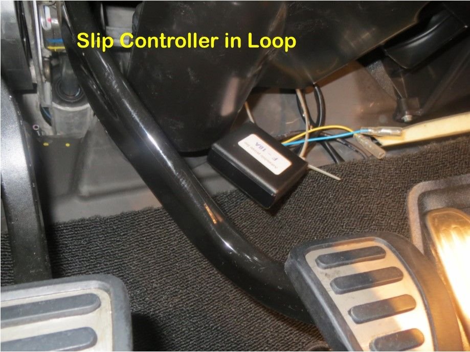

Found a loop of bundled wires about 3/8 inched in diameter by feeling with my hand. The loop makes a perfect place to put a Zip Tie through. Having lots of practice with my street rod wiring, suggest you practice starting the Zip Tie with one hand! Not hard! Used a 12 inch long Zip Tie and just started the loop.
Slipped the controller and wires through the loop. Easily done with one hand.
Pulled the Tie snug and tucked the loose Zip Tie end behind the carpet! Controller is secure and won't rattle.

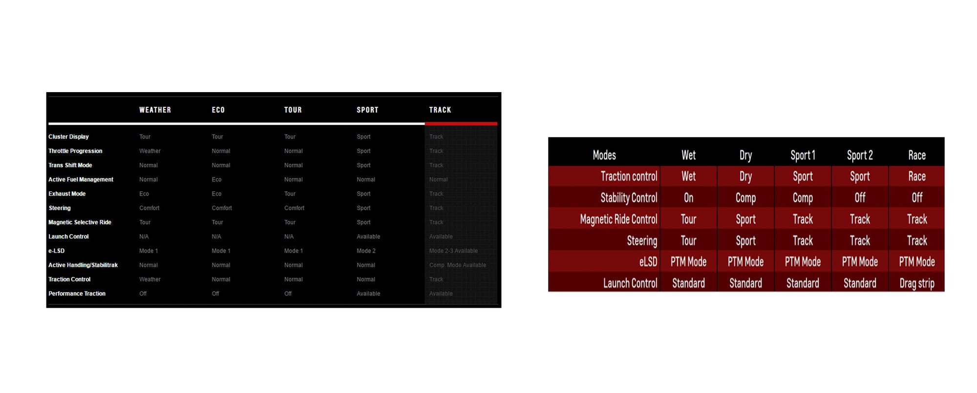

here is a graphic representation of what you said

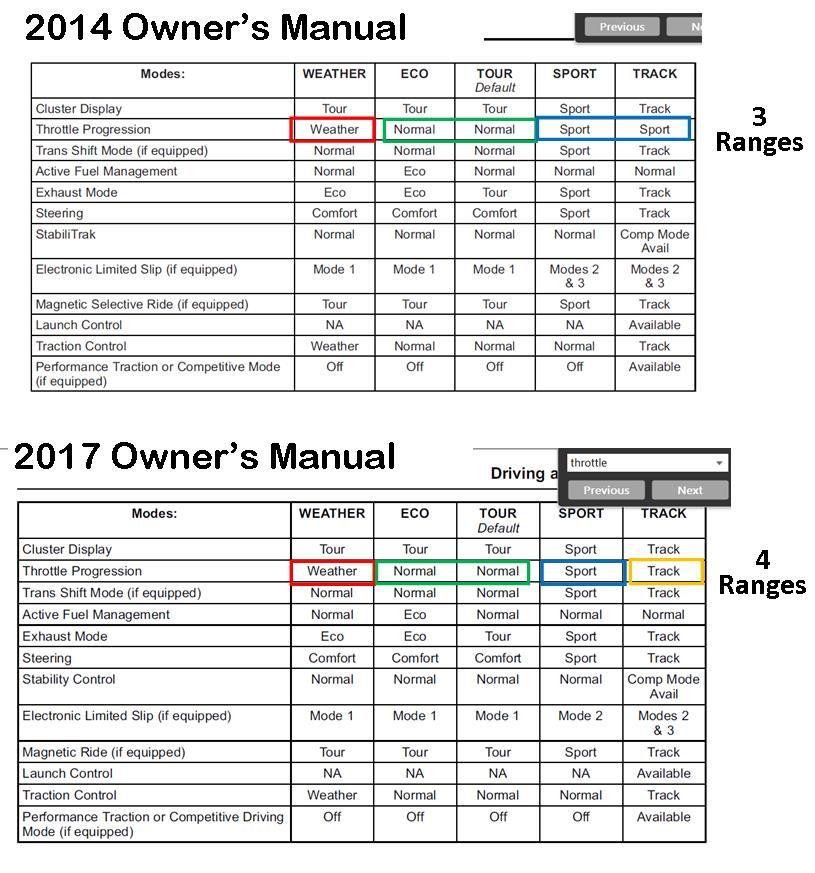

This is a better comparison of what I found in the 2014 versus 2017 Owner's Manuals. For 3 1/2 years I was used to driving in the most aggressive Throttle Response available in my 2014 Z51 as I drove in Sport Mode 95% of the time (it did NOT have mag shocks so the ride was not affected by Drive Mode Setting.)
In my Grand Sport I drive mostly in Touring Mode as the ride with mag shocks is stiffer in Sport Mode than in my previous 2014 Z51 and rattles your teeth in Track Mode, even on our pretty good flat roads in Eastern SC!
The Vitesse Throttle Controller allows me to set the Throttle Response to what I was used to in my 2014 Z51!
The 2014 C7 has 3 Throttle Response Modes. Sport and Track are the same and the most aggressive. The 2017 has 4 Throttle Response Modes. Touring was far less aggressive to what I have been used to for 3 1/2 years. The Vitesse Throttle Control allows me adjust the Response when Driving in Touring equal
to the most aggressive OEM response (and even more aggressive if desired.) Note I am able to have the Steering Response set in Sport and the Exhaust NPP set in Track regardless of Driving Mode, which I have done. However no such option to set Throttle Control as desired.

I'm a little confused. Why didn't you just drive your GS in PTM/WET? That would be track throttle response with tour setting on the shocks. Foosh taught me this and I drive in that mode 90% of the time when I am on the street. I use PTM/DRY when I want the shocks in their sport setting.
Not correct! When in PTM/WET it sets the throttle response slow! It's not in the aggressive Dry Track setting! Probably what GM thinks you need for track driving in the wet, which it what that setting is designed for. As I recall, Foosh just said he doesn't need it and just pushes his foot faster! His choice! I tried to compensate using that approach in my GS and far prefer what I was used to in my 2014 C7 Z51 for 3 1/2 years in normal driving!
In my 2014 Z51 I always drove in Sport (none mag shocks as was my C6 Z51) and see now that it was the most aggressive OEM throttle response for 2014. Now I can match that when in Touring or any driving Mode with the GS!
Maybe it's a 2017 thing. I will chime out.
Throttle mapping is the same when you are in track. Regardless of what PTM mode you are in. I tried to look at the two charts. The red and white one I am very familiar with. The one next to it... I can't seem to make it big enough to read.
I may be wrong (doubt it). But I am pretty sure throttle mapping is the same in all PTM modes. They wouldn't give an inconsistent throttle pedal on track. The tip in is always the same as long as you are in track mode (any PTM setting)
I am reading your post over and over. Your telling me your 14 in sport mode was the same throttle mapping vs in track mode? I think your car was broken. Maybe that was a first year thing but my 16 has a big difference in sport and trackwhen it comes to the throttle. But it stays the same when I am in track mode, no matter what PTM sub mode.
Prove it. I have a 16 and they are pretty much the same in sport and track. You can search and see that's the way most people here feel. The difference is unnoticeable.
It's not my observation in the 2014 versus the 2017 it's what it says in the Owner's Manuals. Don't have to read just look at the pic I put in post #33! I didn't made that up it's a copy of the pages in the Owner Manuals. I just Printed Screen and put the two together! My 2014 wasn't broke!
