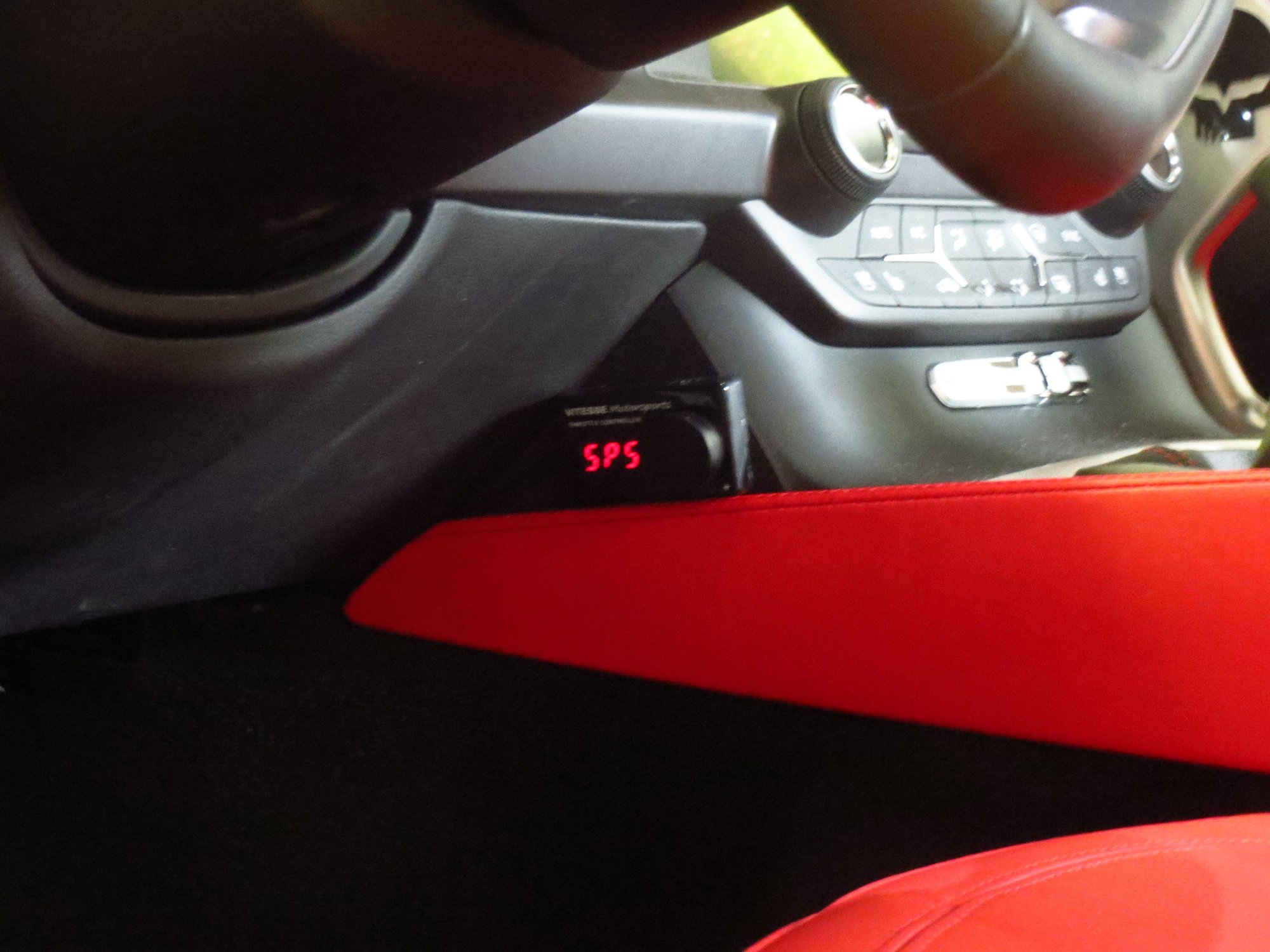

Decided to add a throttle controller to increase the aggressiveness of the gas pedal to throttle body reaction. Since I often drive my Grand Sport in Touring Mode don’t even have the option of using the Sport/Track more aggressive setting. And frankly it is not that much more aggressive. Note although it is on my Grand Sport it fits any C7 and install is the same.
Searched the forum back for several years and there ~hundred posts about how well the Vitesse Throttle Control works. It is also not that expensive. I like the idea that it can easily be set from equal to the OEM sensitivity to much more aggressive.
There were many questions I had that were unanswered in the many posts and even sent several PM’s to posters. However it left several unanswered, like mounting location. A number of folks removed the console top and installed it under the lid. That has a number of shortcomings including the time required to do that and having to lift the lid to adjust the setting and being distracted when looking at the settings.
One poster posted a picture of what I consider and ideal location that was easy to access. Little info accept the pic. The new Vitesse Remote Control uses a click adjust **** so no need to see the display to return to OEM and quickly go back to what I have found to be a good setting for my needs, mid-range Sport 5. That is even more aggressive than the OEM Sport/Track settings. If desired can go more aggressive up to Sport 9.
This is a detailed PDF of my install with many pics: http://netwelding.com/Throttle_Control.pdf
This is NOT the Vitesse controller as they don't provide the data. It is from another car and another adjustable system. The curves however fit what I and most observe with the OEM, what Vitesse states, i.e that setting 4/6 is linear and my observation and comments from posted video's of the aggressive 8/9 setting. Note: these devices do not increase power-it just feels like it!
Great Location to Mount Remote Control. Nothing to Remove, Cable Slips Behind Carpet and Trim. Easy Install.

Thanks, great addition and simple install. Since I often drive in Touring with my Grand Sport I was not even getting the somewhat more aggressive throttle response I was used to for 3 1/2 years with my C7 Z51.
The 2014 did not have mag shocks so I drive it Sport 95% of the time and was used to that somewhat "faster" throttle response. In the Grand Sport, have the steering in Sport setting and NPP for Track setting for all driving modes, but no such option for throttle response. In fact have found the Sport 5 setting even better (faster) than the OEM Sport/Track. Doubt I'll use the much more aggressive 8/9 settings.
Easy to adjust with just a turn of the **** that I have mounted near my right hand if every needed. However have evaluated Sport 5 in a simulated bumper-to-bumper situation (which I seldom have) and it's fine.

So far no issues. Since the Vitesse has nothing to do with power only Pedal position versus Throttle opening wonder what the issue was? Before I bought, saw a lot of posts. Some had issues with the calibration and when not done properly it did strange things!
I made a sheet in my PDF of the procedure in more detail than the single sheet from Vitesse. The 1st time I tried did not hit the button in the correct sequence and didn't fully understand their XX (xx) lines. Made it sound like you had to look at the numbers, which are the resistance readings at "fully up" and "fully depressed" pedal. The procedure is very simple, too simple for me who tried to overthink what was needed!
No need to record or worry about the numbers, that is all stored and used in their controller.

Have no issues, it works fine! Read ~100 posts about the product before I purchased and MOST put the controller behind the carpet! When you read the details in my 7 page PDF you'll see I did NOT put it where many did, which was next to the hotter area, the aluminum clutch/driveshaft tunnel. Some mounted the remote in the console and needed to mount the controller next to the driveshaft tunnel because of the supplied wire length. I did not need the extra length.
As noted, I tried to mount the controller above the carpet in the front but could not get the Velcro or 3M Dual Lock adhesive (which is better) to hold sufficiently to the plastic interior part outside just above the front carpet. That material is cool as it is insulated and has a gap from the firewall, not like the hot aluminum driveshaft tunnel. Looked and placed it 80% behind the carpet sticking up a bit with a gap around it. Cool enough IMO. If needed I would put a short screw in the plastic and let it hang!
Yep read a few posts where Vitesse suggested mounting outside to "possibly correct a problem." Perhaps that was their issue but from my experience it is not as easy to calibrate unless you follow their simple, cryptic instructions very carefully. That is why I make a more detailed set of calibration instructions. There were posts that said it did not work until it was properly calibrated! Frankly it's so easy that I think some just don't push the one button at the proper time. I didn't at first! I was reading and recording the numbers in the display, which is not only unnecessary, it's meaningless! The controller records what is needed and you can't do anything with the numbers!
DETAILS FOR THOSE INTERESTED:
IMO, I am back to the throttle response I had with my 2014 Z51 for 3 1/2 years where I always drove, in Sport. Did not have mag shocks so no affect on ride. Looking at the table in the 2014 Owner's Manual the throttle response in Sport was equal to Track. Both the most aggressive.
In the Grand Sport I drive in Touring as Sport is a stiffer ride than my 2014. The 2017 has four (not three) throttle response settings. Weather, very slow, Touring Slow, Sport more aggressive and Track the fastest. Have tried those Mode settings and in Track the ride rattles your teeth! I'd estimate with my 4 or 5 Vitesse setting, I'm about at the OEM Sport or Track setting.
Did not have mag shocks in my C6 Z51 but had a control **** with 3 variable shock settings on my 1993 40th Anniversary Vette. Realize that was not mag shocks but stiffness and control did change. Even the stiffest setting was no where near as stiff as what the current Sport or Track Modes provide. There are other benefits to mag shocks but IMO Track is just that for Tracking unless you play with the wet Track settings etc.
I'm happy where I have it set now: Steering in Sport whatever the Drive Mode setting, NPP is set at Track for all Modes and now Throttle response when in Touring is what I was used to for 3 1/2 years in my 2014 Z51 driving in Sport or Track!
