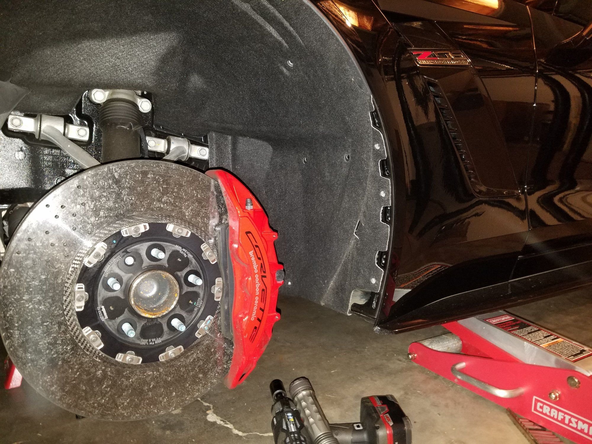

I replaced mine also. It's under warranty, but it's just a $23 part, and a twenty minute R&R if you have the tools organized. That's about what it would cost me to Uber to/from the dealership, plus they don't get the opportunity to break something else in the process while doing this job...like they did when they changed one of my TPMS sensors.
To add something of value to this thread, the bolt on the bottom of the plastic wheelwheel piece that needs to come off is a 7mm, and the 3 torx screws that need to be removed are T15. A standard blade screwdriver will be useful for removing the wiring connector, and a flashlight might be of value, though not completely necessary. There are no clamps holding any of the lines on, or holding the pump in place...it just snaps into the plastic surrounding it.
Be prepared to get wet if there's any window washer fluid in the reservoir. A finger placed over the hole asap, and the new pump within reach to quickly plug into the hole will reduce the loss and mess.

Also bought mine from Amazon. Mine was/is still under warranty, BUT, due to the cost (about $16.50 from Amazon), plus the fact I didn't want anyone mucking with my car (the wheels have never been off), I decided to do it myself!

Mine was also under warranty, however, I didn’t mind spending $16.50 on Amazon, and an hour of my time, to do it right, myself, so I didn’t have to let someone work on it that didn’t really care about what he was working on. The wheels had never been off this car, and I had just rather do it, myself!

+1 another happy customer here, thanks for the info on this thread! One thing I didn't realize, is that the little rubber sleeve needs to be popped off of the old pump and onto the new one - I had a completely full reservoir and no helper (and wasn't planning on "catching" the fluid). Unfortunately the hose side popped off, vs. the pump side, so it was a little tricky for me to get it back onto the hose while keeping one finger on the pump outlet to try to keep as much wiper fluid from spilling as possible.
I also "fixed" the old pump afterwards by shoving some old wire into the outlet side, and then applied 12v power, it un-jammed quite easily. So, next time (and there will be a next time), I'll be sure to either have a helper, or, just plan on catching the fluid.

I left the grommet in the reservoir, and pulled the pump out and pushed the new one back in. It made for a much smaller “hole” with much less fluid loss!
If it had been an expensive fix, I would have had it replaced under warranty. As I stated above, I’m very happy to have not had someone else mucking with my car...you can’t tell it was ever into!
