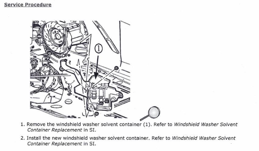

2016 Stingray vert . Fuses are good, tubes aren't clogged, and there's fluid the tank. I ordered a new pump for $20.00 as I don't want the hassle of dealing with the dealership. I've *heard* that it's an easy swap, pull the left front wheel and fender liner, and it's right there. Can anyone else offer insight on changing it out?
Thanks!

Not yet. I planned to do that when I pull the wheel and fender liner, after the new pump arrives. Basically looking for someone that has pulled the liner, and if there is anything I should look out for when I do...
Edit: I did check power at the fuse, I have 12V there, so it's not the switch...

Typical wiring is battery -> fuse -> switch -> device so you may still have a bad switch or connector.
There's lots of good info up in the sticky note section.
Good luck!

The pump arrived, so I tackled the job. Pretty easy to pull the fender liner, thanks again to Ron for the link. I only pulled the fasteners from the rear section of the liner, this gave me plenty of room to get to the pump.
The pump is just held in with a rubber O-ring on the bottom, and a clip at the top, no fasteners. It literally took less than a minute to swap pumps once the liner was out of the way. I didn't have a helper, so rather than check for power with my meter, I just plugged in the new pump and pulled the wiper stock.
It was the pump, I'm up and spraying again! Total job was maybe an hour.
