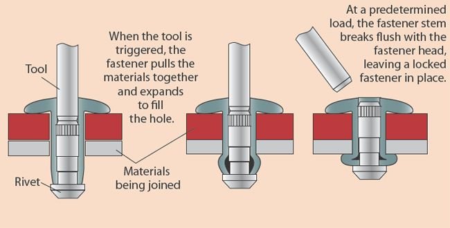

I personally don't like the idea of using rivets. They are harder to remove and you may well need to remove them sometime later. I installed skirts on my base Stingray and tossed out the rivets and used screws. Buy stainless steel screws so you won't have a rust issue. I had a moment of dumb *** and crunched my passenger side skirt. I ordered another skirt and had it on in lass than 30 minutes. Easy peasy.
‘On my 2014 used rivets. Replaced one side shirt. Just drilled though the center pin, very easy as there is a recess on the outside. They came right off.
As the Tech did with 13 rivets per side for my Stage 2 Aero skirts, you are only attaching the skirts to the plastic composite rocker panels. On my 2014, screws would have pushed the rocker panels away from the aluminum frame as in some areas they touched the frame. They doen’t Hold with a lot of strength in the thin plastic composite panels. Don’t want to drill into the frame! In fact to assure the drill did not touch the coated aluminum frame, I put a piece of thin steel between the rocker panel and frame. Just slipped it in from the open side. The composite rocker panel drills like butter. The thin steel stops the drill.
Don’t have thin steel? Open a can of soup, remove both ends and flatten with a hammer!
To Each Their Own!

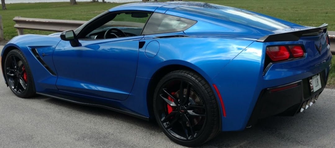

This was the part I didn't understand until I got the skirts and saw how they align to the rockers themselves. The skirts attach to what I would call the SIDE of the car. However at this point on the body the side is angled in such a way it might be considered the BOTTOM. As mentioned these holes, once drilled, shouldn't be visible from a standing position due this angle. To see them you would almost need to be at ground level.
This shot of the rear wheel well gives you an idea of what everyone is talking about:
The link below details a review and installation of EOS side skits on my Z51 - it includes more pictures to help you visualize things.
https://www.corvetteforum.com/forums...th-photos.html
I used screws with large flat washers along with a thin metal mending plate in addition to the double stick tape. I track my car and thus wanted to ensure there was no way these things could fly off at triple digit speeds. Its likely overkill but screws are cheap insurance so I added a few extra per side.

The problem with screws is there is nothing for them to really grab onto. They are threaded into plastic. The rivets expand on the other side of the plastic and have more support than the threads in the plastic can provide. Wait until you have somebody screw up lifting your car with the thick part of the lift arm coming up under the side skirt and actually lifting the car before the lift pad and lift puck make contact. Then you have the weight of that side of the car supported by the side skirt and not the frame. Can happen any time the car is put on a lift and the operator doesn't pay attention to the angle of the lift arms. Rivets hold screws pull out.
Bill

You're welcome to your opinion about rivets vs screws. I'm glad they worked for you. As I mentioned in my first post I had a bad moment where I drove right over a curb and crushed part of the skirt and had to replace it. The screws held just fine and the new skirt was mounted using the same screw holes. The rocker panel isn't as fragile as you might think. My problem with rivets is that sometimes when drilling them out they spin in place. If this happens it becomes a big pain in the ***. I'll stick with screws.
Upon further thought, I doubt the swelling of the rivet shank is any greater than the threads of the screws I used. Seems like a break even unless you can place a washer behind the rocker to improve the grip. Just sayin.

Screws need meat,thickness to hold properly.These rocker panels are so friggen thin.
It's like trying to hang a picture on drywall using the paper only to hold the screw.
Well not that drastic,Ha almost...
Fender washers are a additional area to hold cause rivet heads are small.
