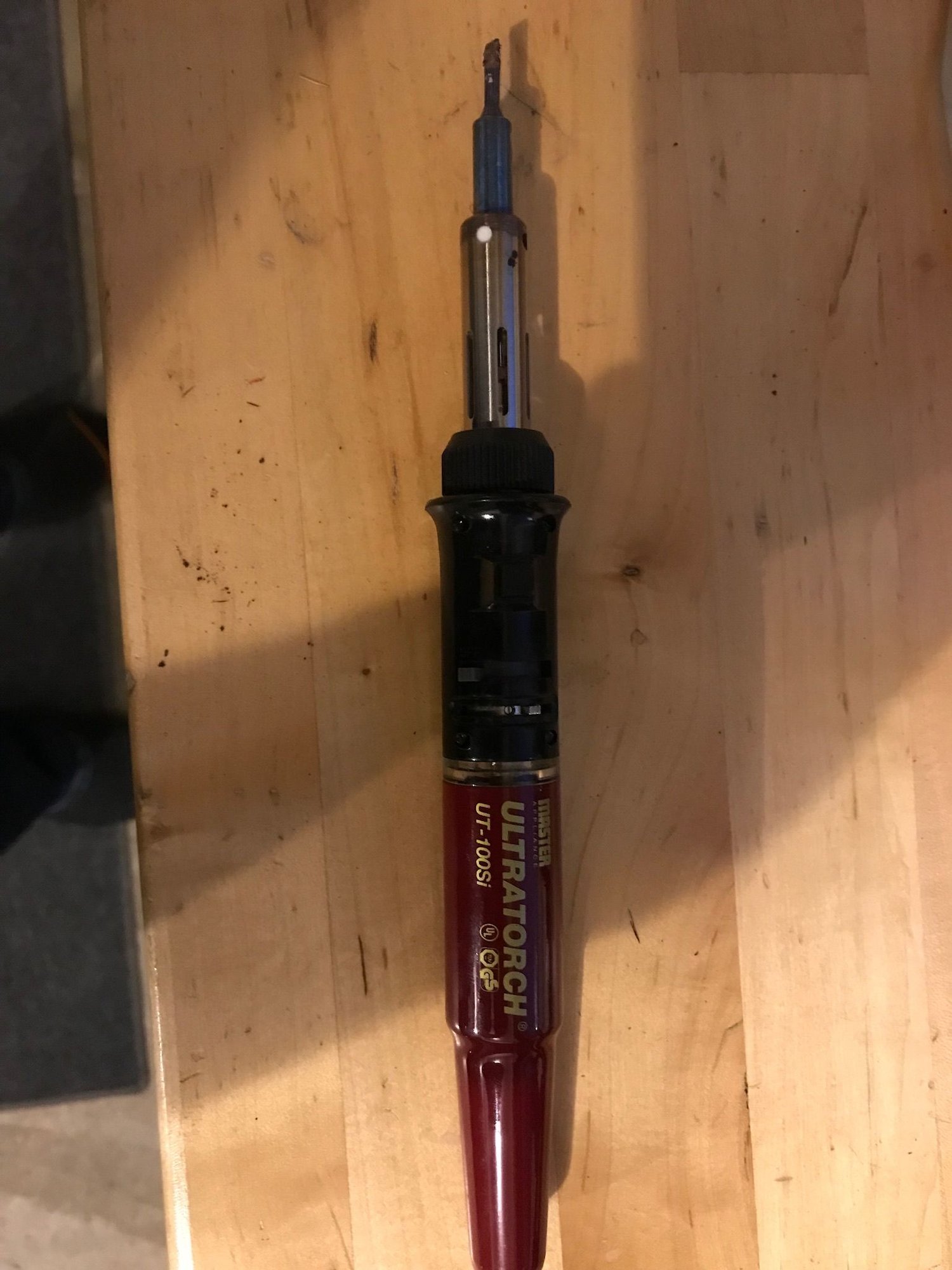

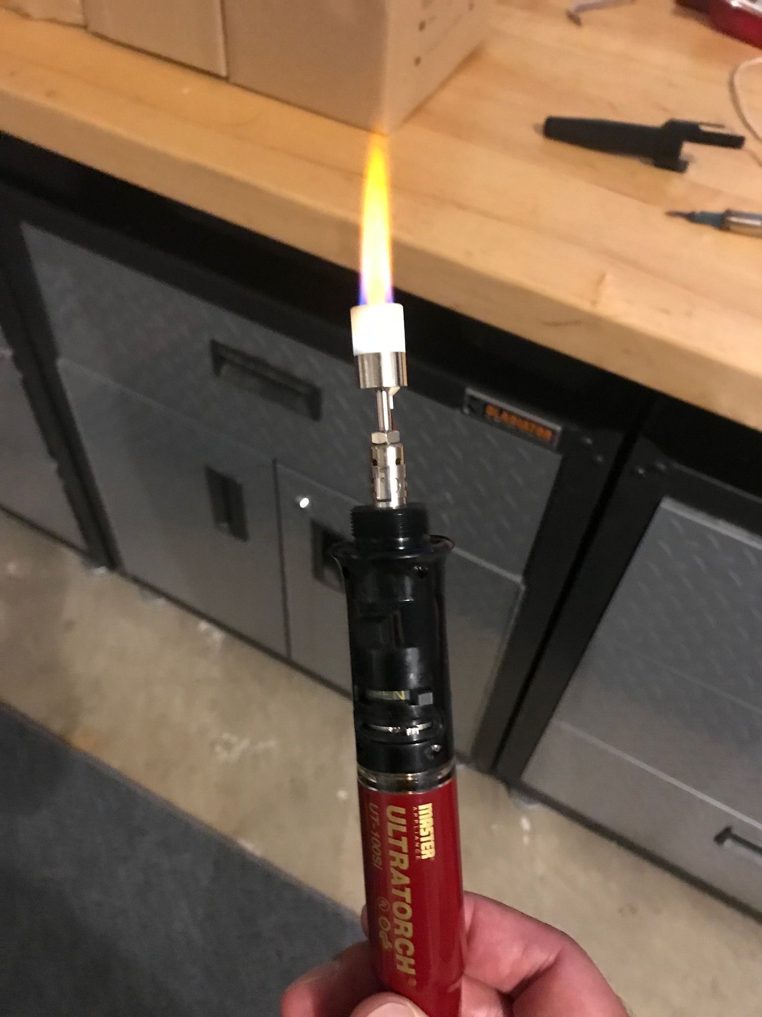

In the future if you need some heat in a confined space get one of these. Every shop should have one:
Weller & Master both make this same model solder iron. It’s the only butane iron worth a **** that gets hot enough for a proper solder joint. On top of that you can remove the tip & barrel & use it as a precision torch. You’re not going to burn exhaust bolts off with it, but it’s perfect for applications like this.

Nice !! That torch will be in my shop by weeks end... I’ve purchased a few and like you’ve said they ain’t worth a ****

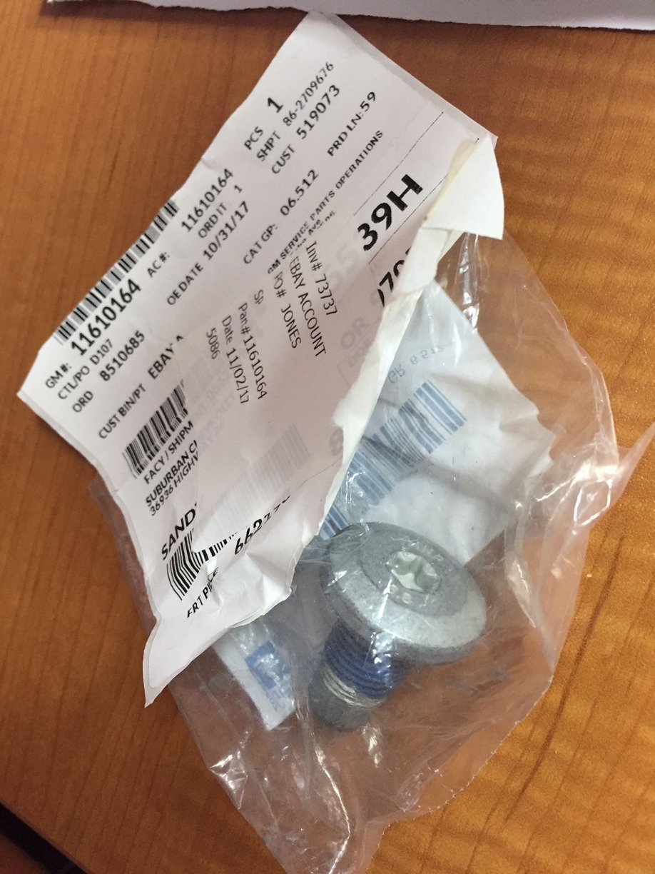

See the locking material on the new "bolt?" That's right, as mentioned localized HEAT is your friend. I even had to use a soldering gun to heat the screw that held my factory installed shift ****. They really don't want parts falling off a car in motion for some reason!
