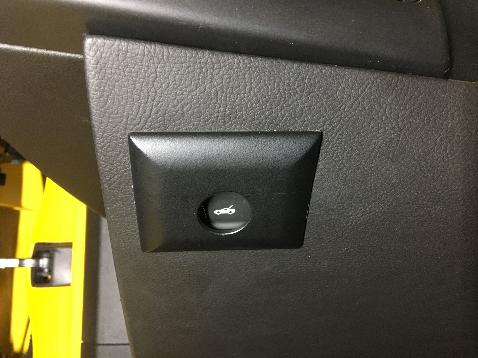

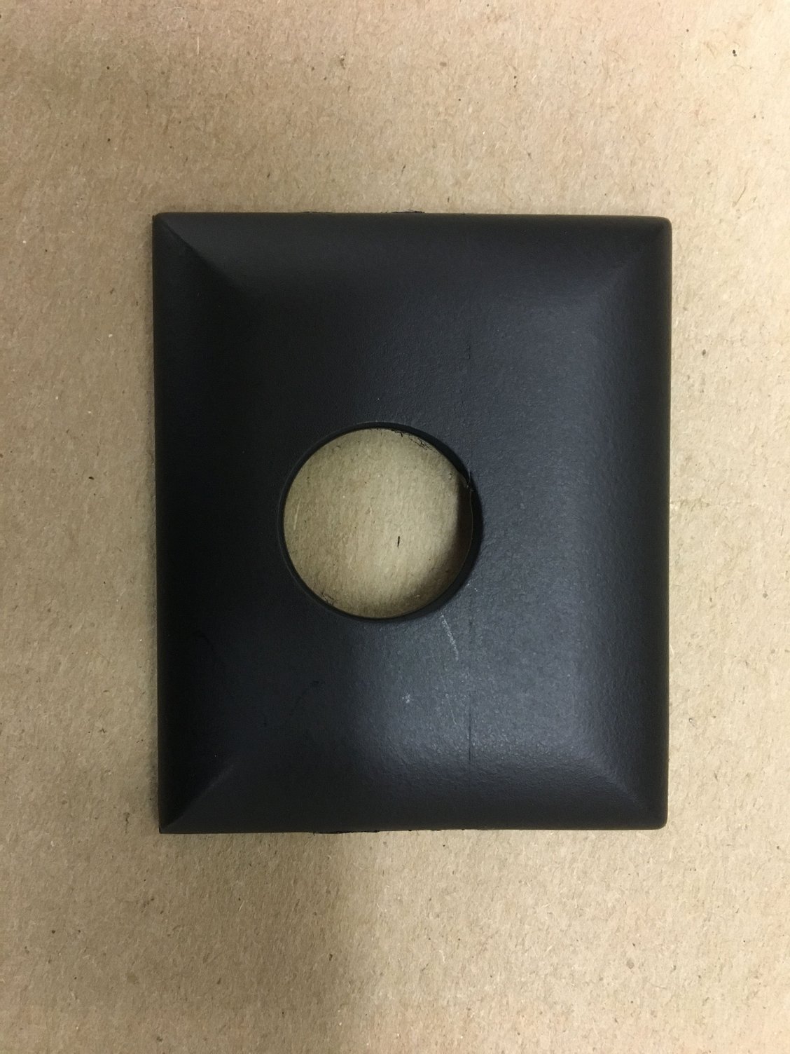

Ok, I came up with a fix for the problem and it doesn't involve the way I get in or out or how far the seat is adjusted. I used a household light switch wall plate, cut it down, epoxied together, drilled a hole for a finger, applied automotive double back tape and painted it low gloss black. Check out the pictures and tell what you think. I'm a big boy and can take criticism. I'll take it off if it looks stupid, no holes were drilled so it's easy to go back. By the way it could be wrapped with leather but I matches all the other buttons. Could be printed on a 3D printer!

I expected your solution would be a cover, nicely done.

Nice!
My switch is a bit different as it has the button to turn off the motion sensor next to it, but I'll just drill two holes. And I have some CF wrap left over so it should match the CF dash too! Next trip to the HomeRepo I'll pick up a wall plate...
