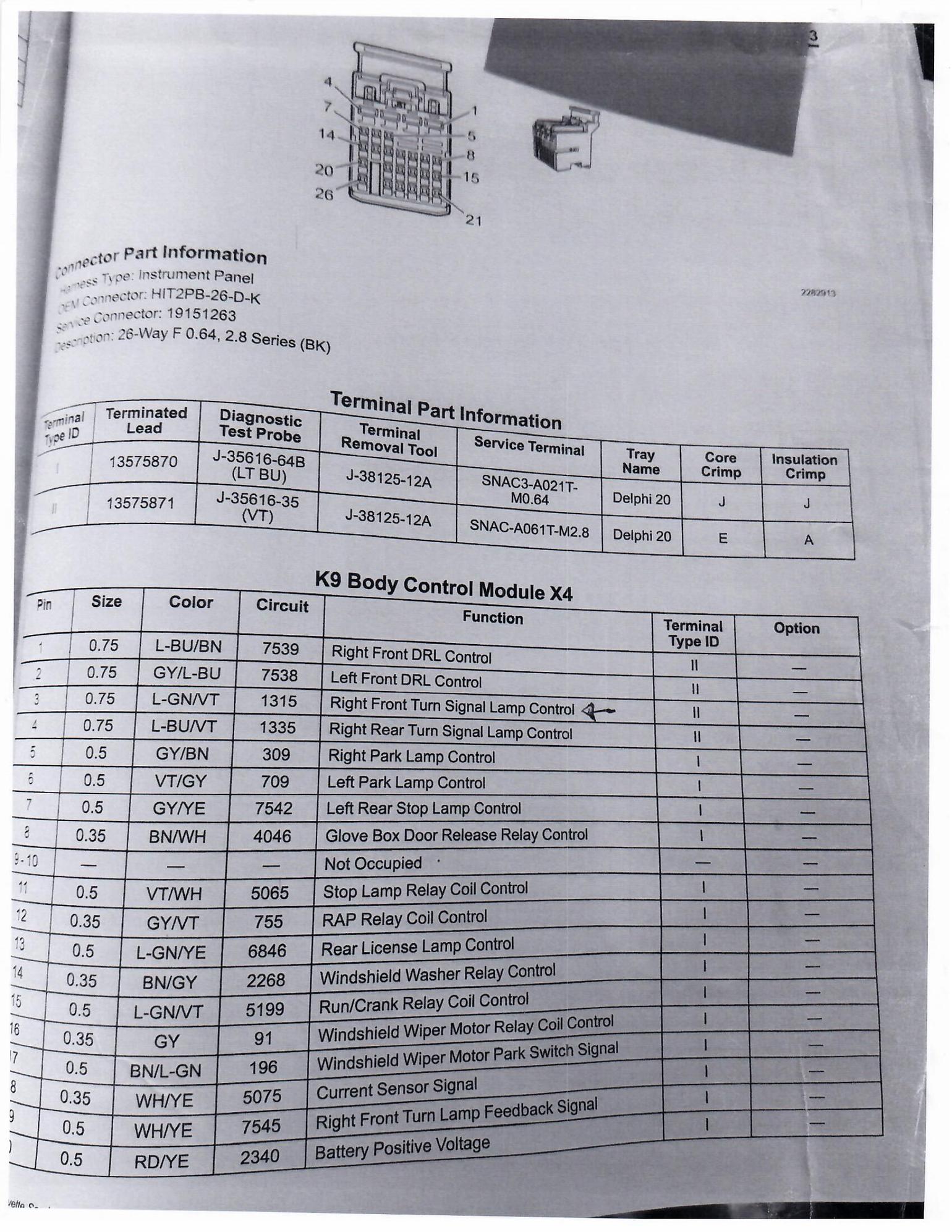

I found it was easier to get to the BCM than remove the bumper. Pin 11 on BCM connector X4 (the black connector on the BCM) works only the 3rd brake light.
I used the Geezer's instructions for access to the BCM. https://www.corvetteforum.com/forums...tallation.html The black wire on the corner of that same connector is a convenient ground. Used three Posi-taps connectors.
I got the one that will only flash the first time you apply brakes if you are in stop and go traffic.

Splicing into the connector at the BCM is easier than removing the bumper. Let's try this link for the Geezer's instructions. https://www.corvetteforum.com/forums...tallation.html
Here is the connector diagram. It is PIN 11 "Stop Lamp Relay Coil Control" Please ignore the arrow I penciled in that picture.
I used three Posi-taps connectors. They are wonderful because there is very little room to work in that area. And they work great!
