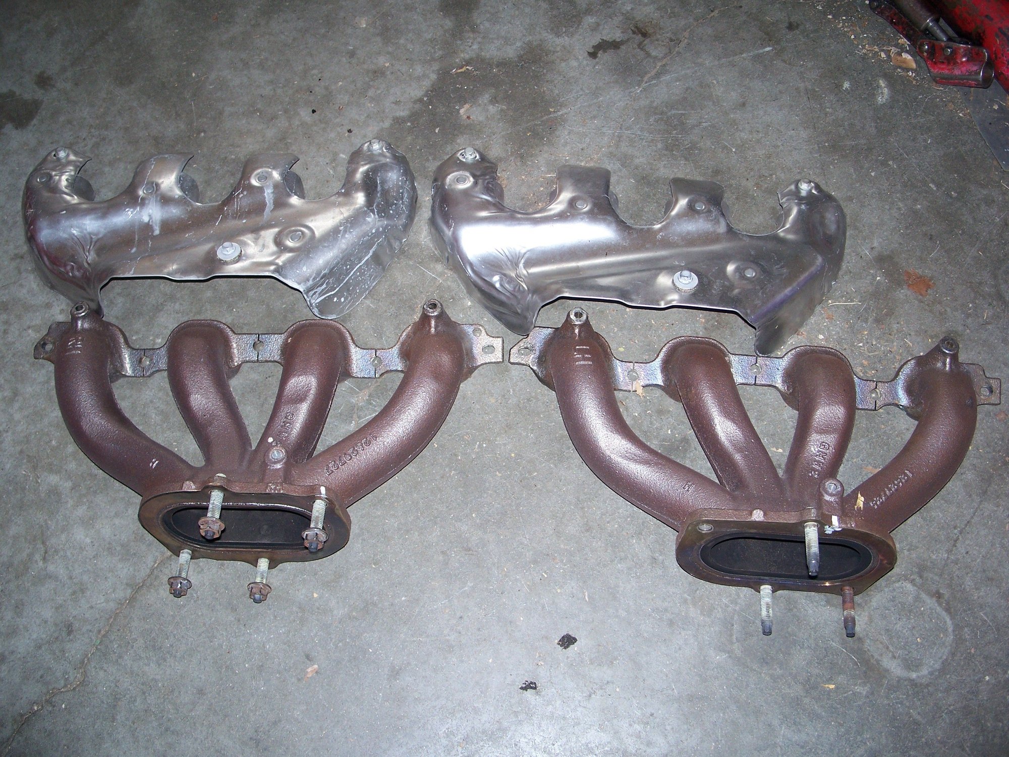

That's an iron exhaust manifold. Only way to "fix" it is to remove the manifold, blast it, and then coat with Eastwood High Temp Gray.
Here's a header that I did 5 years ago, it's still rust free. Keep in mind however that rust on your manifold is -totally- normal. Everyone has it. No more under warranty than the fact the air in your tires is stale by now.

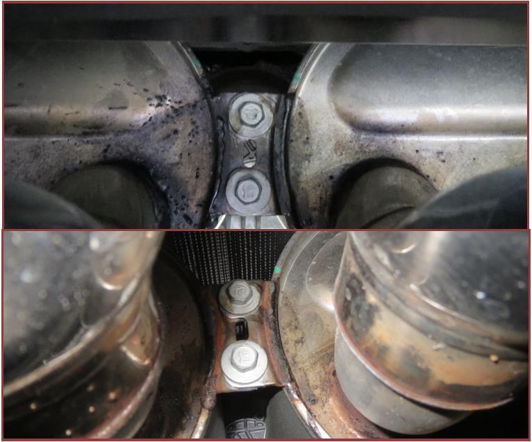

There is a product that can help. Cost less than $10! It's called Rust Reformer and I bought at Walmart. Note it has a shelf life of one year. It works well on the muffler rust. If you haven't looked the welds on the pipes to muffler body are rusted! The area near the welds (called the Heat Affected Zone) is also rusted because the very thin aluminum layer on the "aluminized" 409 stainless evaporates away.
This is a PDF and pics below that show what can be done for low cost and about 15 minutes time. It IS NOT a paint and only affects rust, iron oxide and turns it a blue/black. Held up on my 2014 for 3 years. I tried on the exhaust manifolds but did not work as well on the cast iron but helped some.
http://netwelding.com/Muffler_Rust.pdf
Bottom pic is before; Top after. Not perfect but easy to apply, goes on like water. Does not affect none rusty areas.

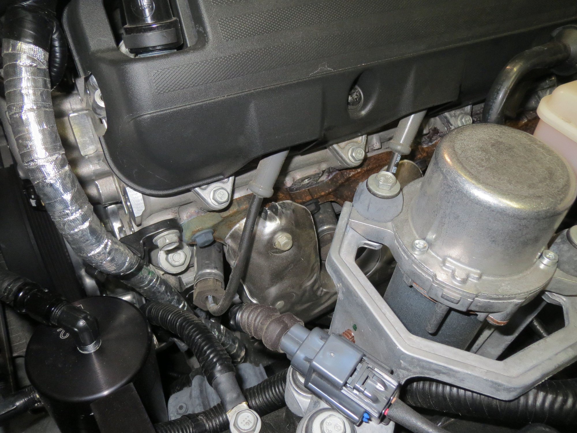

Tried on the cast iron exhaust manifold and it helped some.
After 24 hours did not turn the blue/black as the muffler. Perhaps would be better with more coats.
