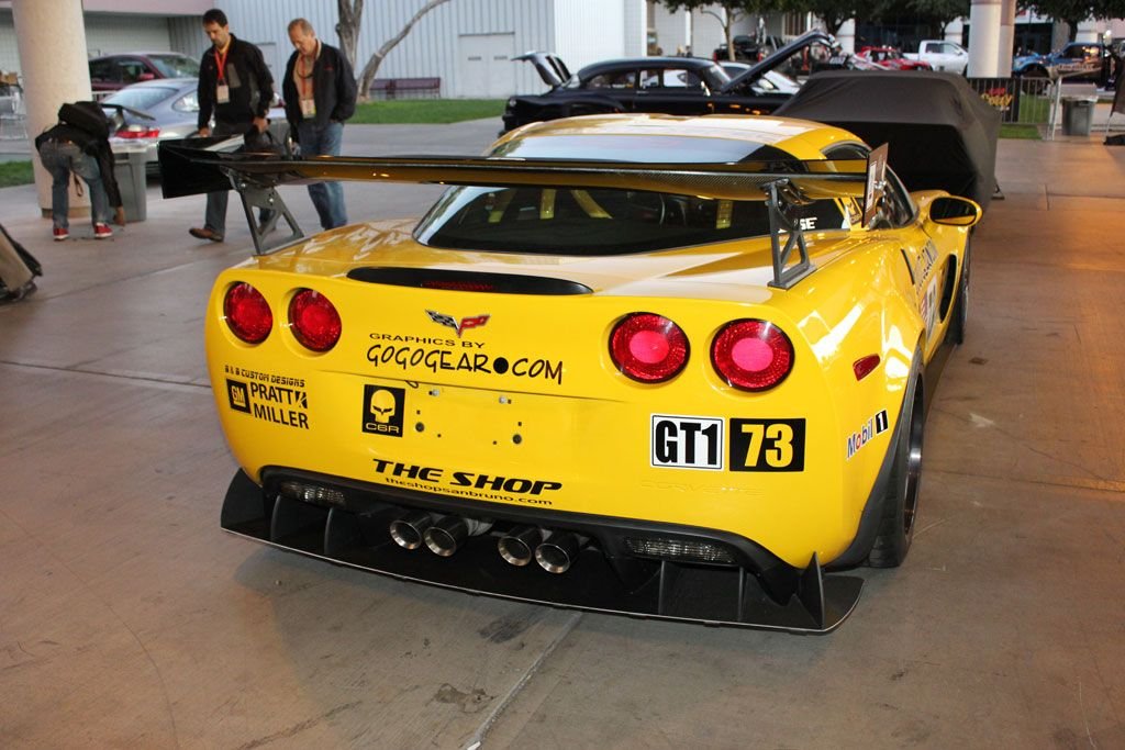

What's the point of the underplate?

Read the PDF in my post #20 above. There is a tech appendix with a number of pages that discuss diffusers, blown diffusers, what the fins, technically called fences, are all about. In fact the C6R has a plate under even more “fences” and you’ll see why F1 cars get much of their downforce, which is more than they weight, from the bottom shape and diffusers! In fact an F1 car can theoretically drive upside down on the ceiling!
All that said, in a Street car even at fast highway speeds they are there strictly for looks.
Airflow is a fun science and race teams spend millions to continually employ wind tunnels and today computer simulation programs to optimize. Diffusers create downforce with less drag than that created by spoilers for a given amount.
I did find one technical benifit. On my white car the rear was getting large black spots that were hard to clean. Now I get smaller spots but still use a waterless cleaner and microfiber towel every couple of trips into town to remove dirt and clean between the fences.

Here is pic of C6R with the bottom plate improving the diffuser efficiency.
