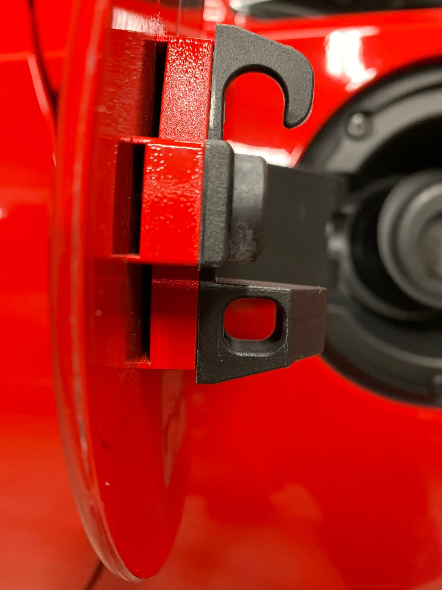

It has a push to open mechanism like all doors like this (and push to close). The lock is a separate mechanism to keep the first one from opening.

Similar to a touch latch on a cabinet. Push in and it holds closed, push again and it pops open. As stated, the lock is a separate mechanism. If your doors are unlocked the gas door is unlocked and opens and closes freely. If you lock the doors the locking mechanism plunger engages in the gas door. The problem is it fails in the locked position and that sucks because there’s no release. The push pin installed in the hole stops the plunger from engaging in it and locking the door. Doesn’t harm anything. There’s other lengthy threads about this somewhere.

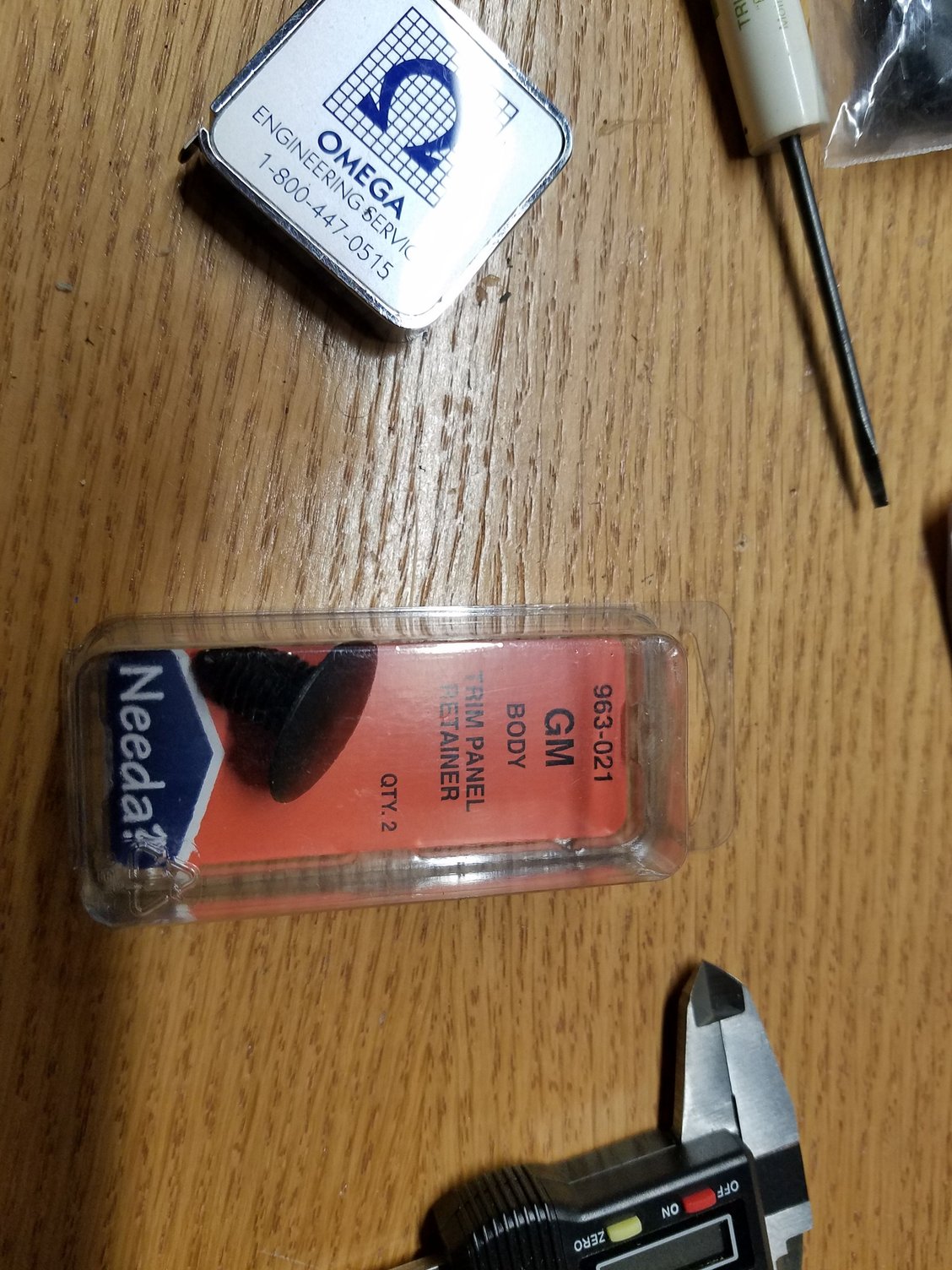

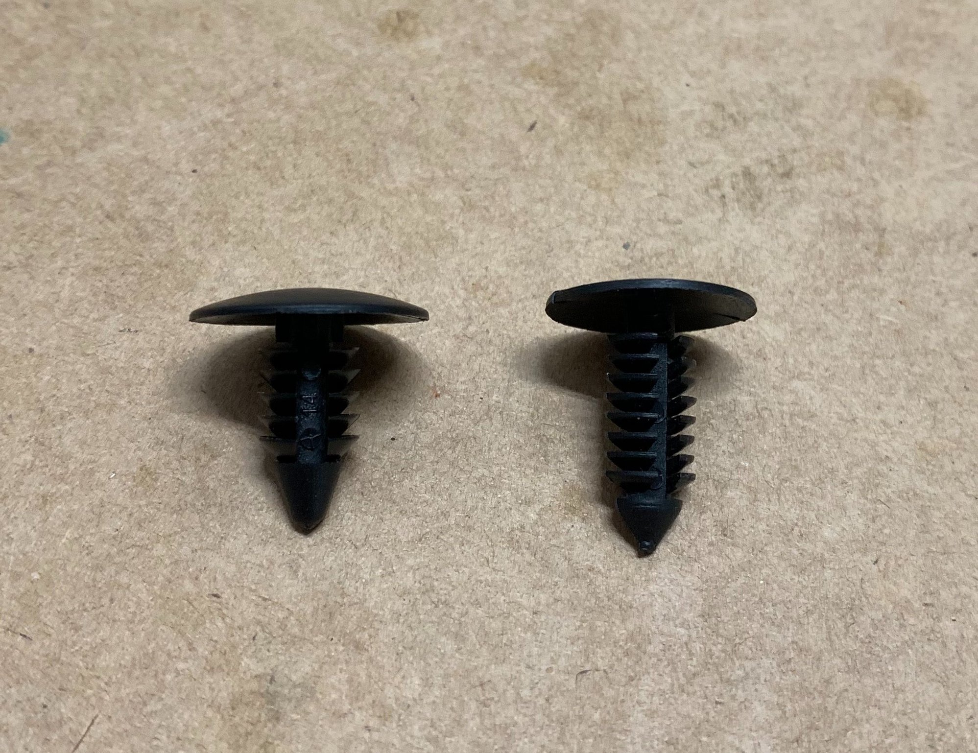

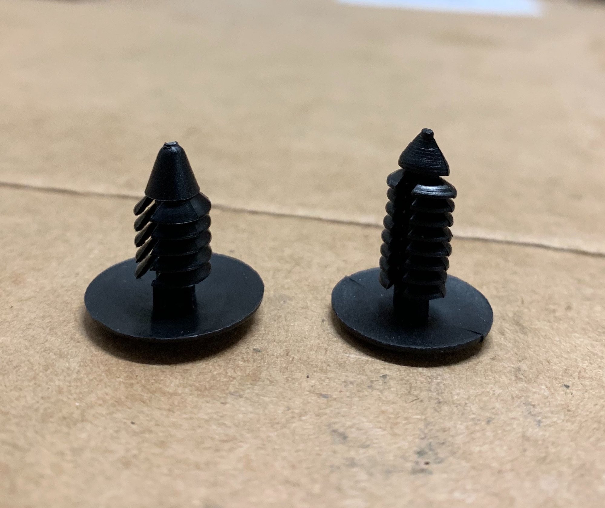

The hole is 3/8" by 5/16". Any 3/8" plastic body fastener should be snug enough. I'm doing this tomorrow.
I finally got around to implementing this preventive measure. I bought some fasteners in this diameter but it was not even close fitting. Back to the drawing board.
if any has the correct diamensions please pass them along.
P.S. I do not want to use a metal screw and nut.
I found the same Maxie. I went through all of my crap in the basement, and found at least a dozen of those little things, and every one was to small to stay put. I guess I'm off to to the Autozone.

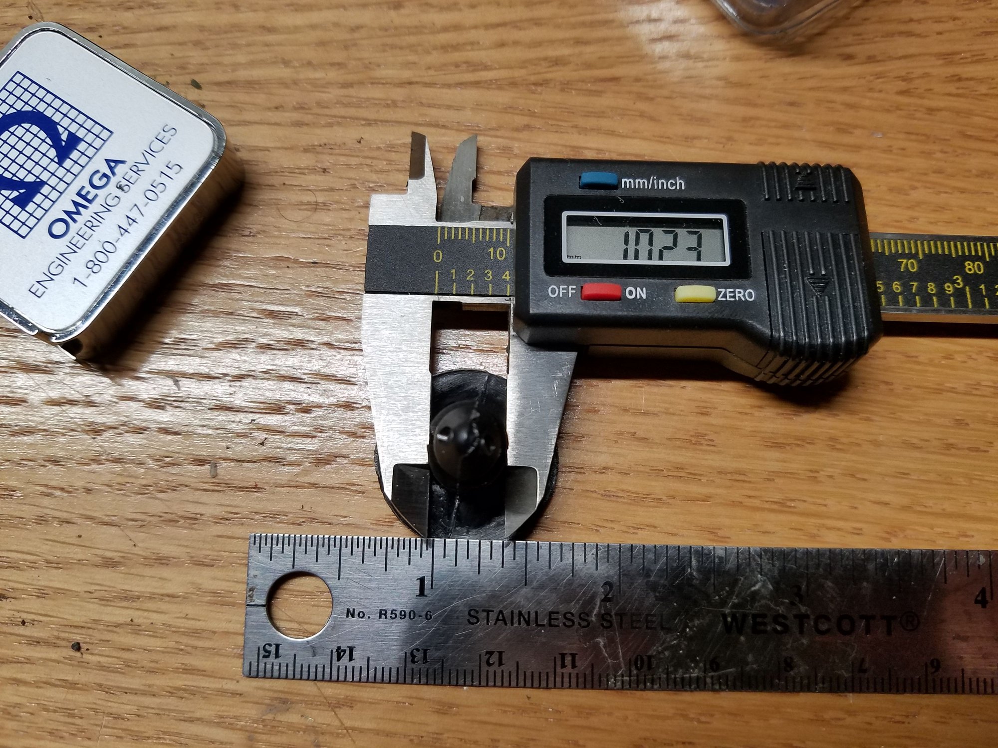

I have not bought the plastic body fastener yet, but read here on forum that the size needed is 10mm.
Not sure what to tell you. It's the correct size. Mine pushed in with some resistance as you would want. Perfect fit. I said 3/8" and yours don't look 3/8". 10mm.
