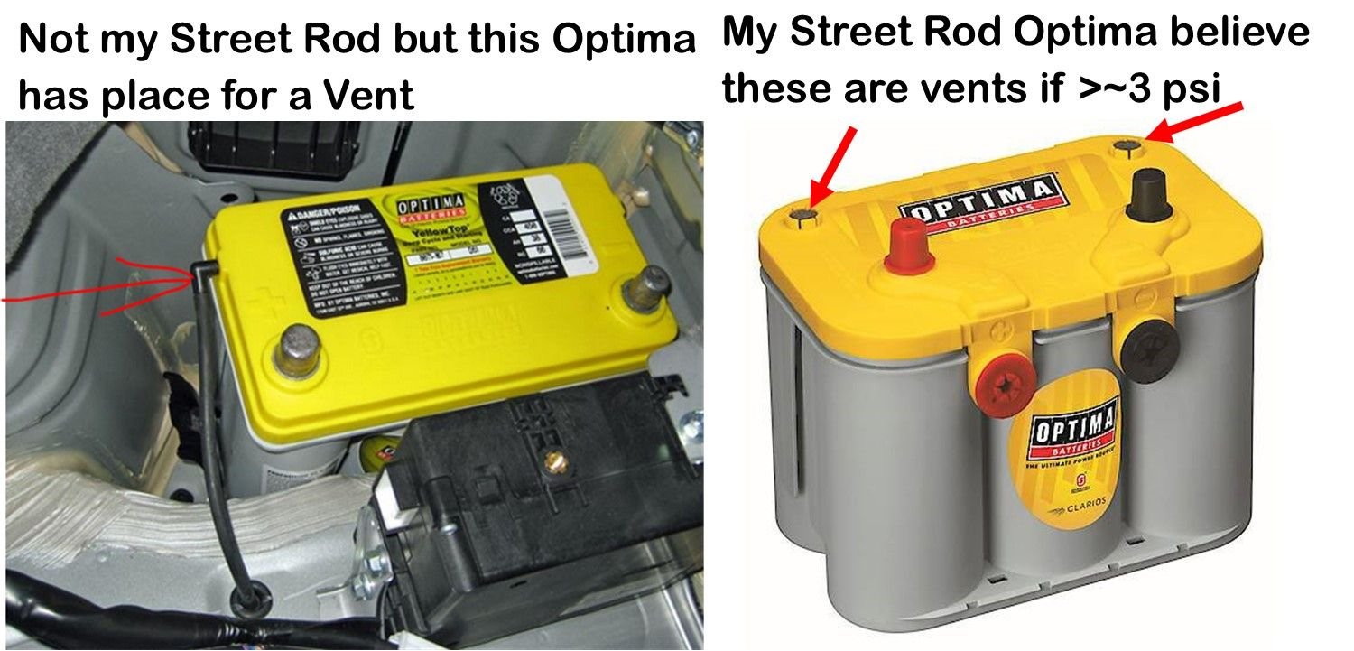

I'll discuss with pics and info on AGM (Absorbed Glass Mat) batteries when used in the marine industry. Hope pics and that Marine info help your understanding!
First, I installed an AGM (that what an Optima is with a different shape.) in my C7. Both the OEM battery AND the AGM battery had a place for a hose that went from the top of the case to the outside bottom of the battery recess.
Quoting from a Marine Safety Info:
AGM batteries do vent! Quoting from a marine source- they should know: “Even though AGM batteries are normally sealed, they do have a venting system integrated into the case top. In the event of an overcharge condition, it is possible for excess pressure to build up inside the battery and then release after a 2 or 3 psi accumulation. If it occurs, hydrogen gas will vent and it is quite explosive.” A Vent is required by the Coast Guard even with AGM batteries like Optima.
That info come from the PDF re battery install on my C7 BUT has some basic battery info as well. Might be of interest to the Silent Majority who view threads (10 to 30+ times the number who post) if they are technically inclined: http://netwelding.com/Battery_Issues.pdf
So yep, even the Yellow Top I have had in my Street Rod for 20 years (3rd one) AND is inside the sedan passenger compartment (right rear over the tire in the sedan to provide some extra weight on the 16.5 ich section thickness (420 metric) tires for traction) it should be vented. I don't!

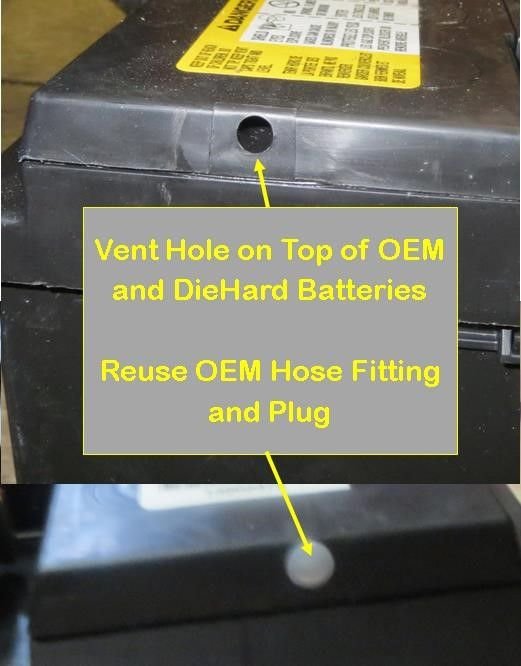

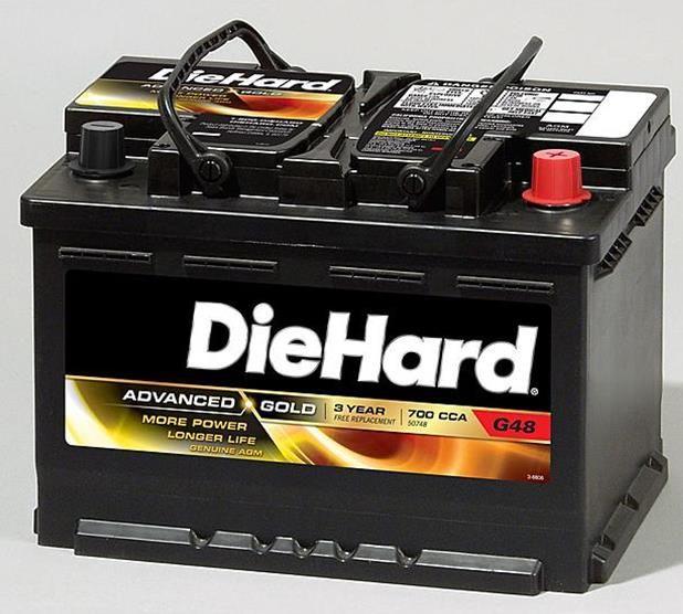

The Diehard comes with holes on both sides of the battery top. The OEM battery has a hose that exits out the bottom of the car. The 90-degree plastic hose fitting on the OEM battery fit the Diehard as did the OEM plug that fit the other hole on the Diehard. The 90-degree angle elbow fitting was placed on the hose that comes from the C7 battery well floor. It was tucked under the right-side carpet to clear the new battery during the install. After the battery install it was placed in the right-side vent hole by “feel” as there is little ro

PS: Found This Pic. This should clear up the thought that Optima's don't ever Vent
