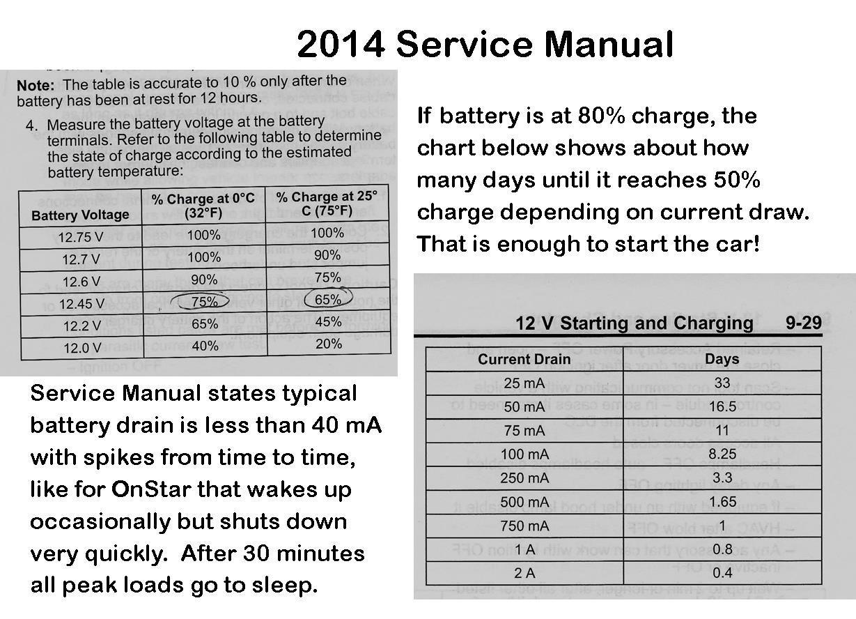

I started with a standard Optima and It was discharging pretty quickly, so bought a Yellow top. Turned out my thought that a 20-mile drive would charge the battery was wrong! The C7 and C8 shut down all significant power after 5 to 10 minutes. In fact, someone just measure the parasitic current draw in a C8 and it was only 15 milliamps. Although I only drive 3 to 4 days a week (been retired 20 years) it's about 50 miles round trip to town so very seldom use my charger.
After I replaced the Red Top with a Yellow Top Optima, I now keep the Street Rod on a maintenance charger 24/7 as it mostly just goes to a few shows a year. When I measured the parasitic draw is was like 40 to 50 milliamps. It does have several micros like on the Dakota Digital Dash and the remote doors/window controller, the alarm, and the remotes on the sound system, that power the speaker amps and CD player.
Pic below is from my 2014 four volume service manual. Note a 50-milliamp parasitic draw will only keep the battery charged enough to start ~ 2 weeks. Also put a pic of my Street Rod wiring, I did from scratch.

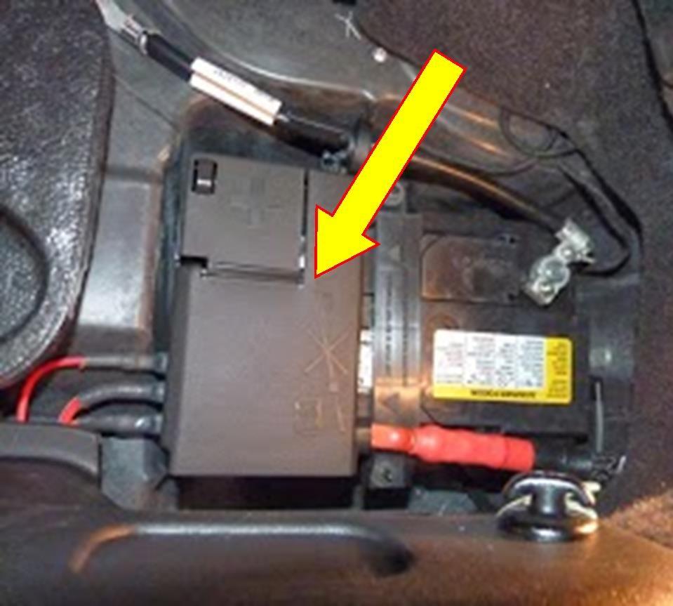

The OEM C7 I replaced is definstaly a FLA and only has a hose from the top to a hole on the rear floor. It's only covered by a carpet. That area would not be considered vented.
Pick of C7 OEM Battery. Can actually see hose on the left coming from a 90 degree plastic fitting. Yellow arrow is the plastic cover that covers the power board.

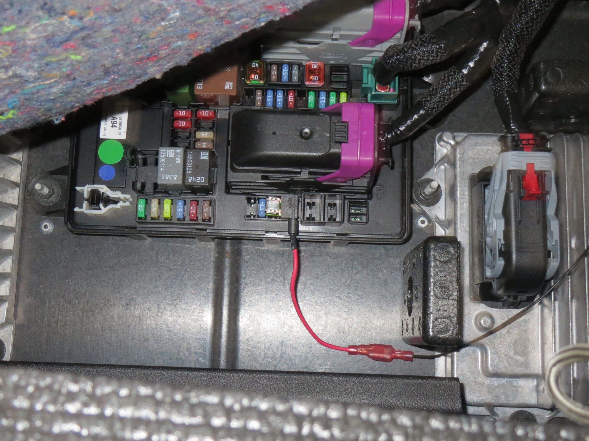

This is the rear fuse panel just to the left of the battery. The bottom of the rear floor carpet is on the let. There is a lose foam insert over the battery. It is showing and add-a-circuit used for the radar detector (red wire.)
