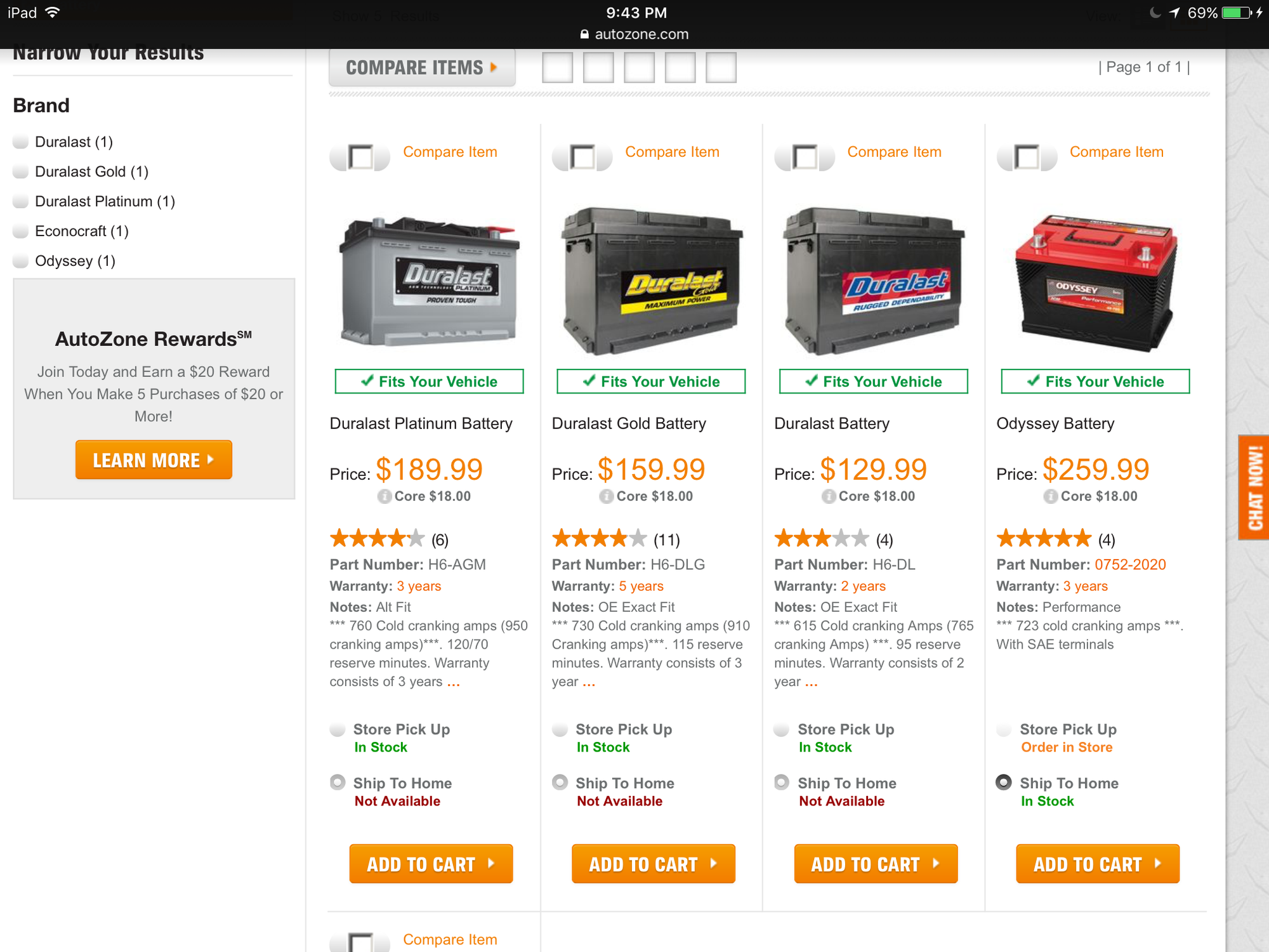

This is what the local store show will fit my car.....Probably go with the Duralast AGM OR the Odyssey AGM

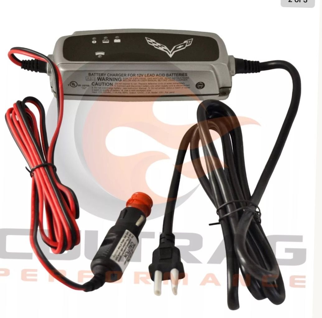

That kinda sucks....if you go to An AGM battery our $100.00 GM charger is worthless...it says lead acid batteries only

An AGM battery is a lead acid battery. Just different format for the internals. AGMs need a step charging function. Not sure the car’s voltage regulator provides this. When putting in AGM, must ensure there’s a step charger to maintain it. If not, life is shortened. Only reason to put AGM is if you need deep cycle capability (like operating DC equipment for hours with engine off).
