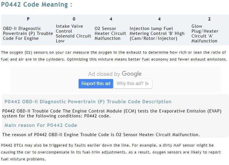

Originally Posted by jimmbbo
Either take it to a dealer or get an OBD-II code reader online for $15-$30, plug it into the receptacle on the lower LH side of the instrument panel (near the hood release) read the code and go to this website - http://enginetroublecode.com/
Recommend getting the reader and learning how to use it for peace of mind, since the light alone could be anything from a bad air seal on the gas filler to serious engine damage.
Cheers!
