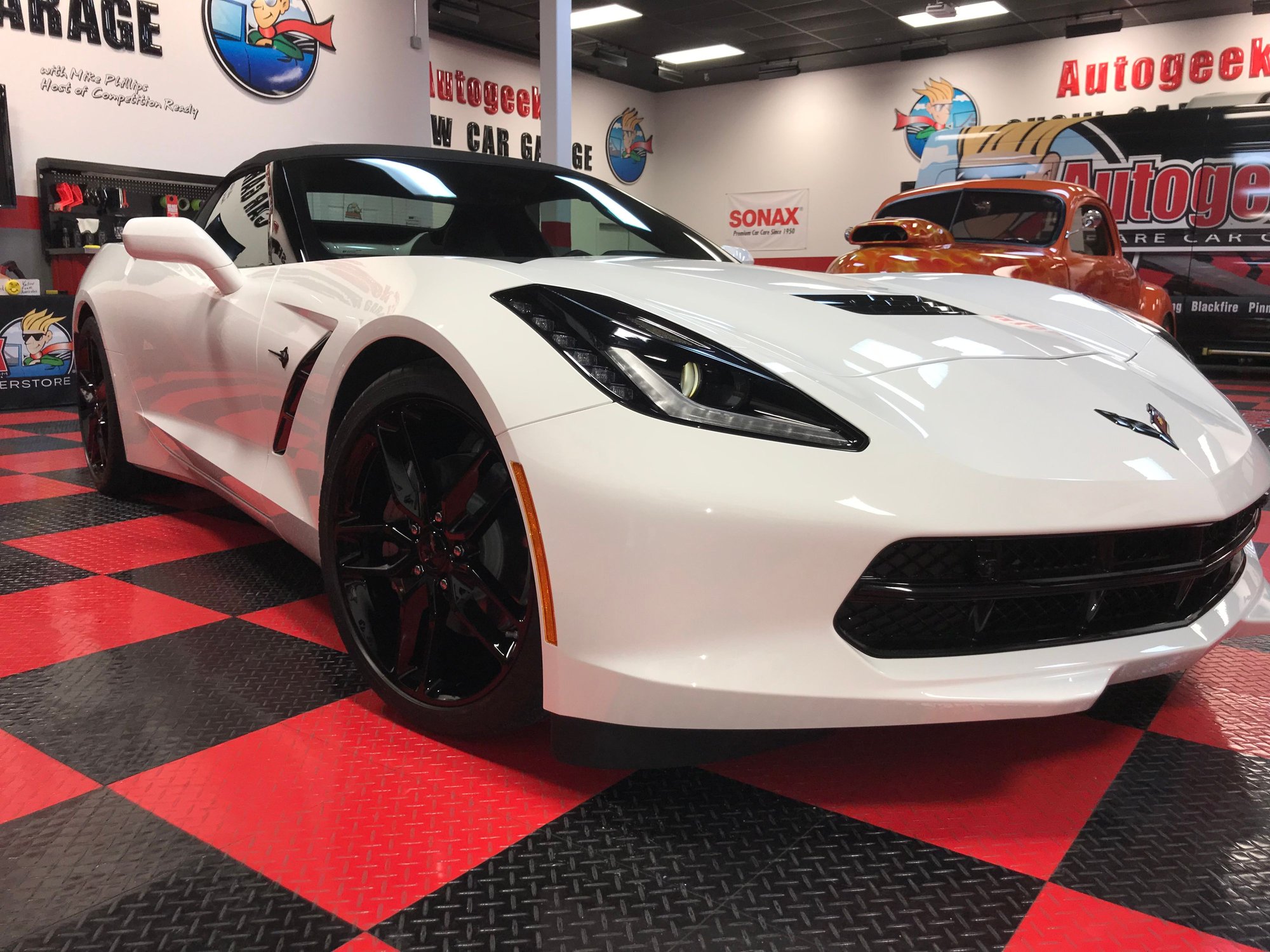

I went with Pinnacle Black Label Diamond coating on my new 2019 vert. I am fortunate enough to be friends with Mike Phillips of Competition Ready TV fame and caught him on a day when he was "bored" right before the holiday. We even snuck the car into the Autogeek Garage to work on her. We took the car through the complete process to achieve the best possible result. Wash > clay decontamination (you'd be surprised how contaminated new paint is) > polish to correct paint > pre-coat paint prep > ceramic coat. Doing it right is a commitment and took the two of us close to 5 hours to do the paint, glass, wheels. The results are stunning and well worth the effort. I will post a complete step by step breakdown in the coming weeks..

Old Jan 2, 2019 | 01:36 PM
  #71
MikePhillips's Avatar
0MikePhillips
Former Vendor
Joined: Jul 2002
Posts: 687
From: Stuart Florida
Old Jan 2, 2019 | 01:42 PM
  #72
MMD's Avatar
MMD
Joined: Mar 2018
Posts: 4,754
Likes: 1,650
Originally Posted by MikePhillips
yeah baby...now you talking...Mike's here!!! whoo...hoooo!!! Hey Mike. Hope you had a great Holiday down there in Port St. Lucie. Could you share with us what coating you used on that Ray? As always looks great! Look forward to giving my money to Autogeek this year. Just need to find out what coatings are you recommending for our Vettes this year.
