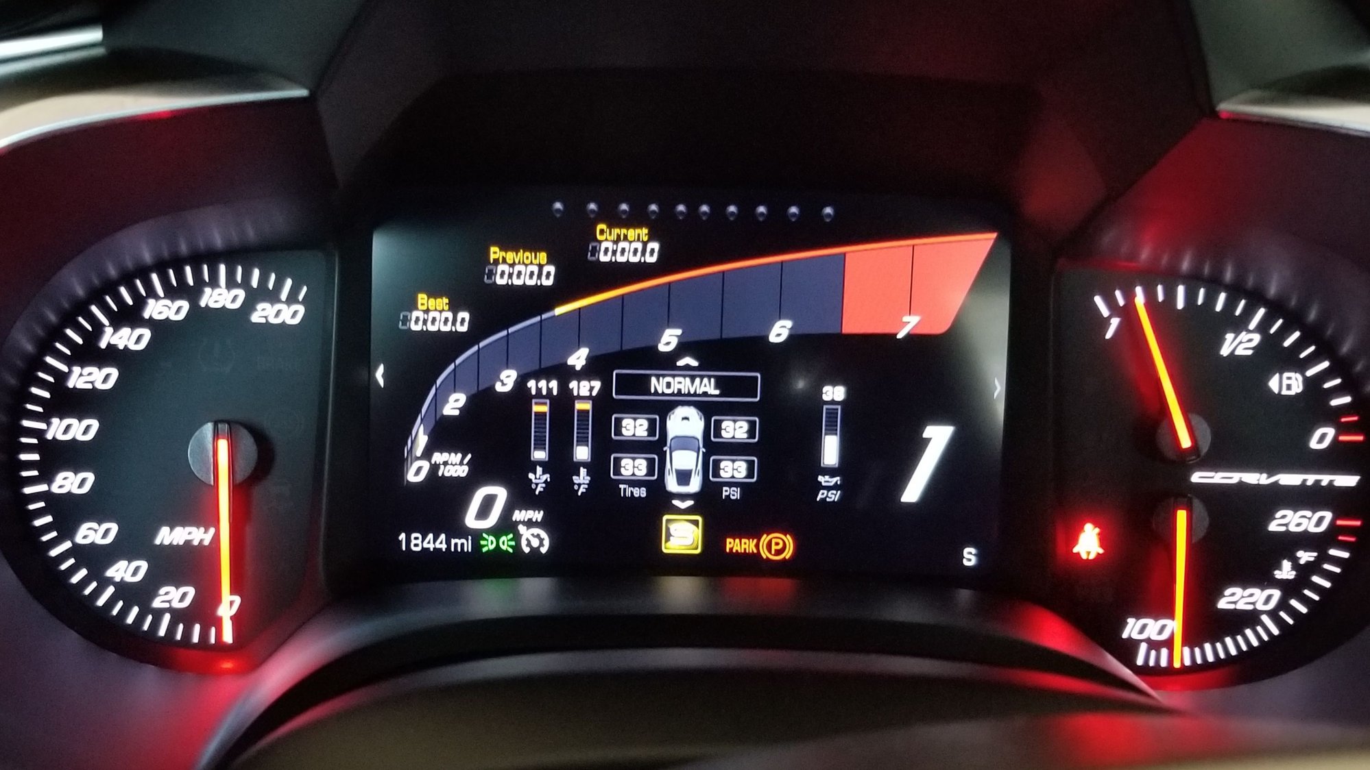

Originally Posted by sjw91
That display doesn't look the same on my 2019. What's the 4th bar that I don't have? I can see it's a temperature display, but I can't tell what for.
The fourth display that isn't showing on yours is the transmission temperature. Not sure why it isn't there though
Ah. Is the transmission temperature only on Z51 cars? Mine is a base Stingray. I noticed there was no transmission temp sensor when I installed my skip-shift eliminator. Unless that's another model year change for 2019...
I have a base Stingray and it shows the transmission temperature on mine.
Is it a 2019 too? I don't seem to have any ability to reconfigure the pocket gauges in Track Mode.
Mine is a 2018, built at the end of production (just after the plant reopened)
