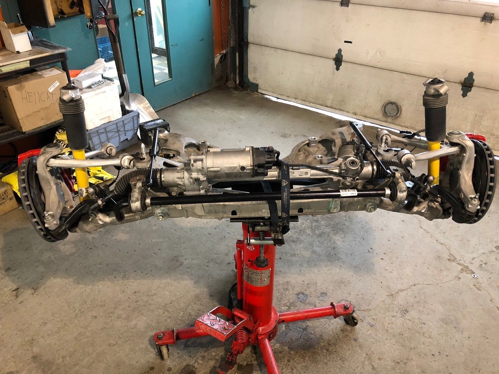

Crap..... I just looked at the Service Manual. To change the rack, they have to support the engine, and then drop the front cradle...I was hoping the rack could be replaced with the cradle in-place….I think I might live with a potentially intermittent power rack...….

Crap..... I just looked at the Service Manual. To change the rack, they have to support the engine, and then drop the front cradle...….I think I might live with a potentially intermittent power rack...….
You don't. It's actually pretty easy to remove from the car. Remove the wheels, tie rods, abs bracket, front sway bar and the radiator duct, then unbolt the rack.
Great !! thanks for the info.
With the cradle in the car, it looks like you need to remove the entire tie rods (at the inner joints), and then there is enough room to lift the rack up and off the cradle? Or do you pull the rack out by sliding it sideways, out thru the wheel well?
