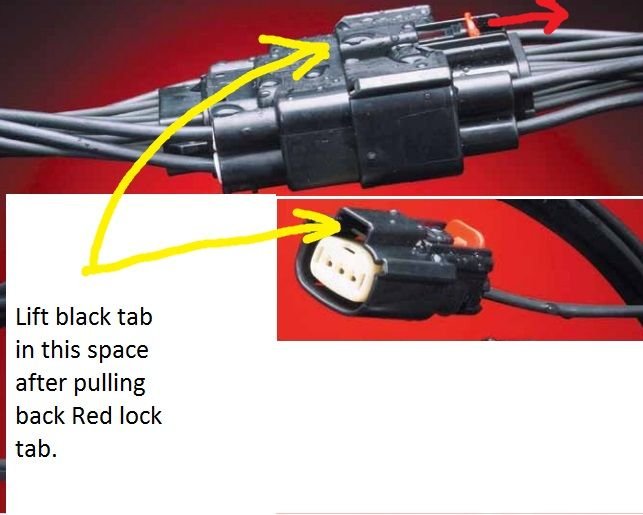

You can buy a new one from GMPartsDirect.com for less than $100.
23199271 Rear Camera $96.96
Do the labor yourself.
One tricky part...to unclip connector at bumper, you need to lift up on black tab inside the rise opposite the red slide lock (after pulling the red slide lock back).

Here's a pic of the connector type:
The actual camera connector has 6 wires, 2 rows of 3.
