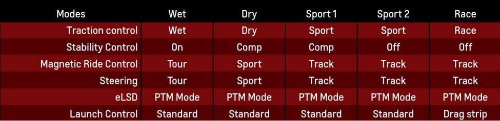

GM MISPRINT ALERT - it should also say "if equipped" in the exhaust section because if you don't have the NPP then the exhaust sounds the same in all modes.
Now keep in mind the steering, exhaust and dash cluster settings can be de-coupled from the **** if you wish. For example you can have the steering on Track all the time with display in Tour all the time while the exhaust is in Sport (model year dependent) regardless of how you twist the ****. The only thing truly locked to the **** is the suspension... well provided you have the mag-ride option. PTM (performance traction management) also requires the mag-ride. It has an additional table shown below:
I was actually surprised to learn that PTM wet and dry didn't use the Track suspension or steering setting. I incorrectly assumed all PTM modes were based on Track until someone corrected me and posted this graphic.
Apparently, the above table is also incomplete. The NPP exhaust is not set to Track when in PTM/Wet or PTM/Dry; nor does the PTM honor the 'Engine Sound Management' override setting. Throttle Progression is also progressive from PTM/Wet to PTM/Race (maybe implicit in the 'Traction Control' line above)
Thanks. I find it odd the way GM manages this. The assumption I had was all the PTM modes are Track related... after all the car must be in Track mode to activate PTM, so steering, suspension and exhaust should be in track mode. I could understand the suspension and steering dropping down to maybe Sport mode with PTM Wet to help with traction issues... but Tour? Way too soft for me for track duty. And not leaving the exhaust in Track mode? Oh well.
I've actually come to appreciate the clean design that the Corvette Engineering team has decided to embrace. This is readily apparent from the detailed technical thesis from this thead:
[ANSWERED] How do the Various PTM Modes Change Parameters When in Track Mode
PTM was designed exclusively for use on a race track. You are free to make use of these settings on surface roads but that's not what PTM is designed for.
PTM is all about gaining control over the various inter-operable parameters and presenting them in a cohesive step-function format to the race driver
PTM is all about presenting a gradual progression of driver control by progressive disablement of a coordinated set of 'safety' features, while at the same time minimizing the work load on the driver to optimize these individual ***** through trial-and-error.
Sure, the driver is free to experiment. Just don't choose PTM.
To put it bluntly, once you choose PTM, you are operating under 'GM Law'. Just don't fight it. Learn it. Embrace it.
