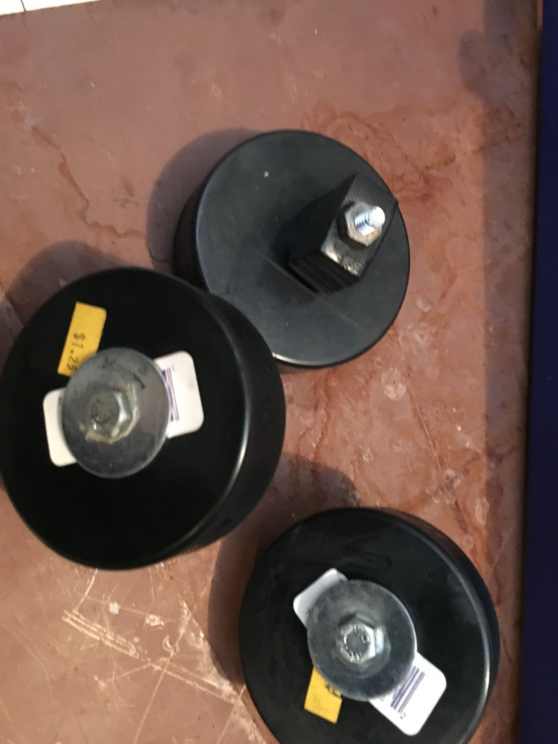

OldC5, Vet and Shadow, What pucks are those?
To the OP, I feel your pain.

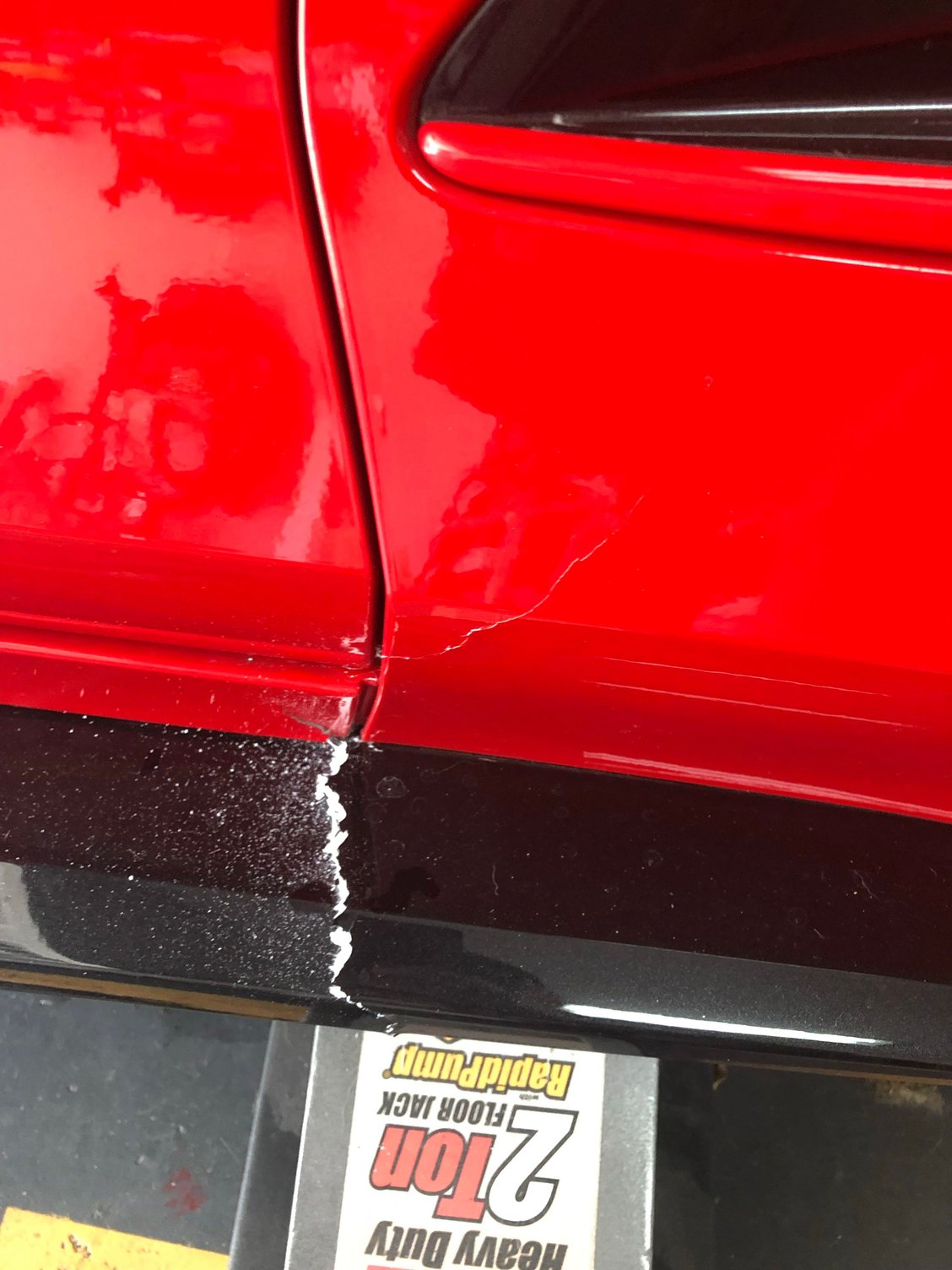

Originally Posted by sTz
Unfortunate, but you’re not the first person to do this... several others have posted the same. It typically happens when the jack wheels don’t move when lifting and lowering.
The side skirt can easily be easily replaced... can’t really see the extent of the damage to the rocker. Hopefully it’s just superficial and can be repaired. You definitely don’t want to replace it. The rockers are actually glued to the fame and can be very labor intensive to replace. GL.
Heres my set up, note the metal sheets I picked up at a fabricating shop. I always put them under the jack to reduce resistance. I like the hockey pucks. They are rubber the jack is rubber. No guarantees but has worked on numerous vette over 20 years.

[QUOTE=Greg00Coupe;1599094540]Heres my set up, note the metal sheets I picked up at a fabricating shop. I always put them under the jack to reduce resistance. I like the hockey pucks. They are rubber the jack is rubber. No guarantees but has worked on numerous vette over 20 years.
[/Q
QUOTE]
Yes this is especially a good idea on garage floors that are epoxy or non broom swept finish. 90% of jack slips are not due to puck issues but jacks sliding/creeping on the concrete floor. Vette owners take note of your floor when using jacks.

Originally Posted by V Vette
Sorry about that sucks!!! Im willing to bet the concrete floor had something to do with the slipping of jack (more than the pucks) as it looks shiny and did you chock the other wheels prior to jacking?
I did put the car in gear with emergency brake on and I chocked the opposite wheel (front right) where I was jacking. I didn't use a genuine wheel chock but I did put a 10lb bag of sand in front of the wheel. Its possible that was a factor and the floor too. I have noticed some guys put cardboard down to give the floor jack some traction. That's probably not a bad idea.
But again, for $203 I bought the RR-56 Made in USA Foam Ramps which I think is the way to go.They are light yet strong and the Rhino Ramps have deformed on a friend of mine so I won't use those. The billet pucks I have just purchased as well, as much to protect repair shops as it is to protect from my own jacking.

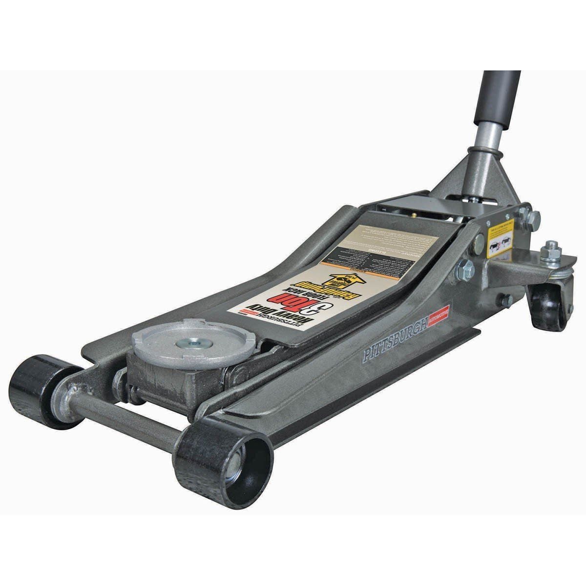

I use the Reverse Logic lifting pucks which have a squared off bottom as opposed to a beveled edge. The 3-ton lo-profile Harbor Freight/Pittsburg jack I use has a deeper dish than the 1.5-ton Harbor freight jack and captures the above pucks much better to resist slippage.
ZL1 addonns

The beveled edged plastic pucks are garbage! They will slip and slide over the edge on the jack pads. They have caused damage many times just like this. Those who sell them need to stop selling them because this type of damage will continue. You need flat bottom metal pucks so this doesn't happen again.

Originally Posted by Fcal
If you insist on using a jack, look into an Omega Low Profile.
I looked up the Omega and it looks like it might be a Harbor Freight unit with a couple subtle differences and a different paint scheme
Omega:
harbor freight:
