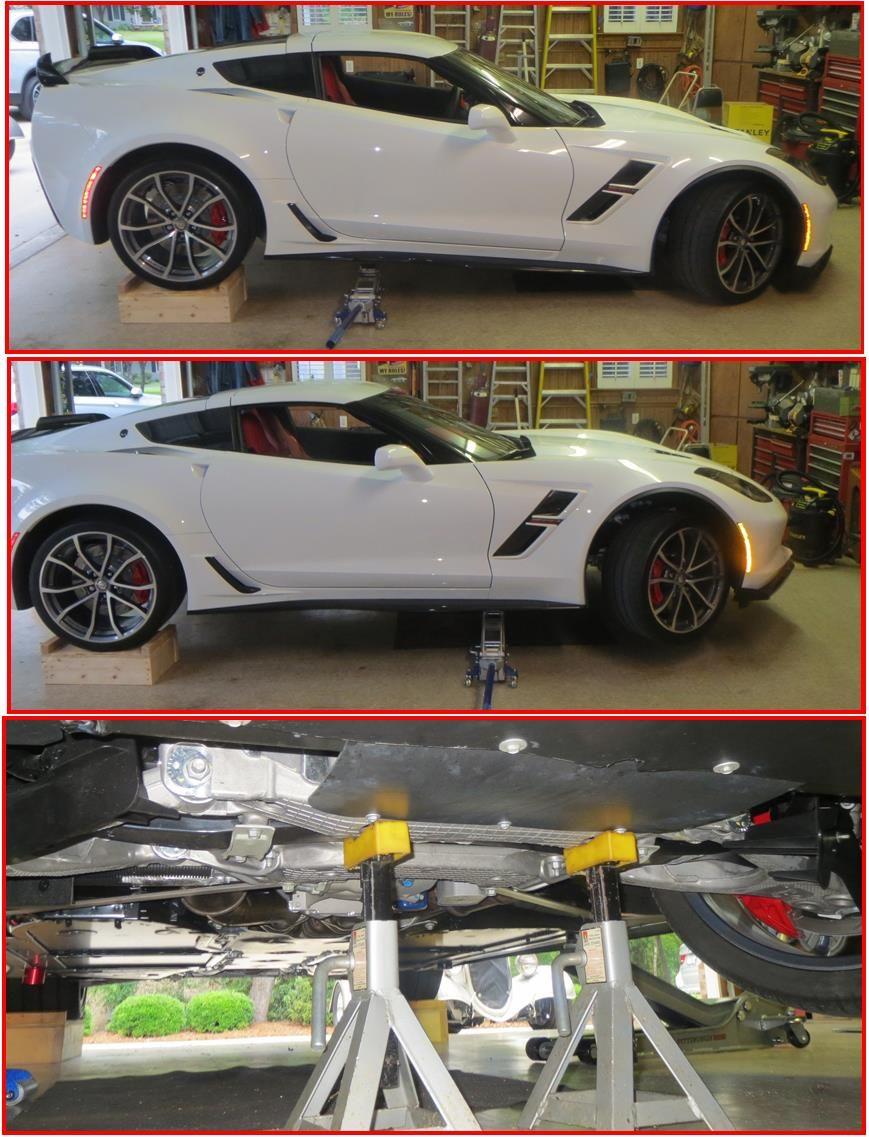

[QUOTE=JerryU;1599100079]Easy! Thee jack MUST move into the car to keep the jack saddle under the jack puck. The shorter the jack arm the more it must move in for a given lift height. Had my short arm jack slip off the puck- like the OP! Bought a long arm jack, which as noted for the same max lift of the short jack, which required it to move in 2.6 inches, it only needs to move in 1.2 inches. (Note that is for the same lift NOT the max lift on the large jack.)
However that is a very heavy jack and it did not move it "at all" on my vinyl tiled floor or my concrete driveway where I often change oil. The jack saddle is also very shallow (to get the wide range of lift.) I welded on a steel rim to the saddle so it can help keep the saddle on the jack pad!
Note my method of jacking to change oil. Made those ~10 pound stanchions from a 2X6 and some plywood for ~$10.
[/QUO
TE]
Another Jerry exclusive!!!!! Your the best!

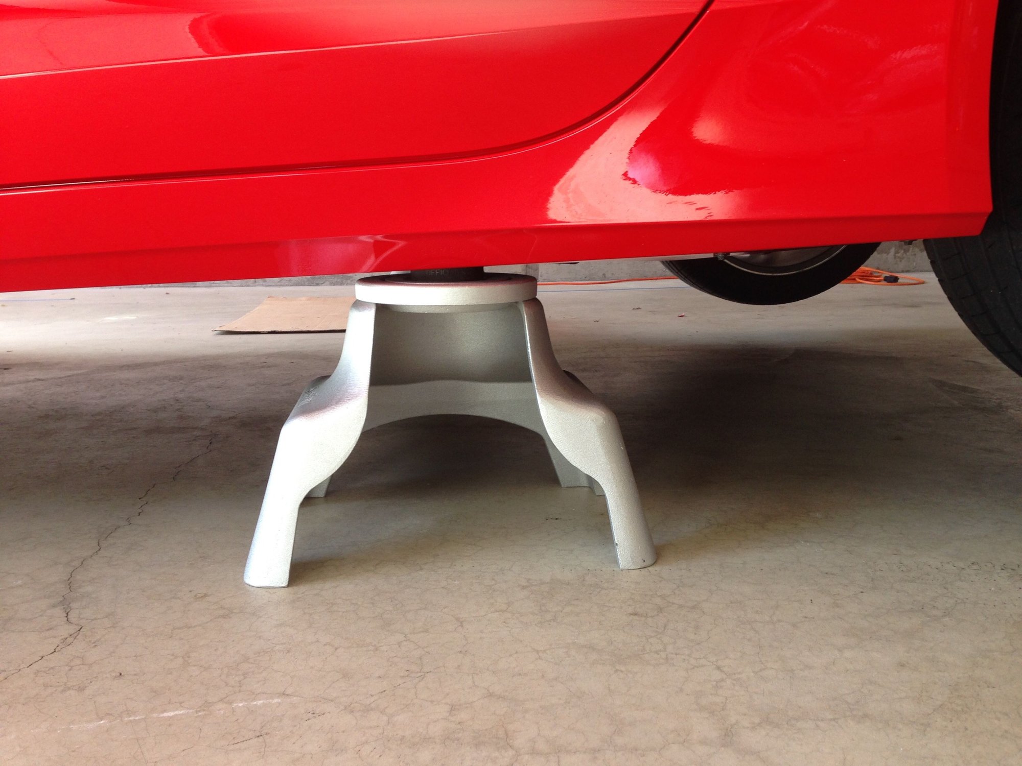

Originally Posted by Maxie2U
It’s the reason I bought Jackpoint Jackstands. Lifts take up way too much garage space.
thank you for posting these, i had no idea these even existed ! seems foolproof for jacking a corvette up and the car not slipping off floor jack

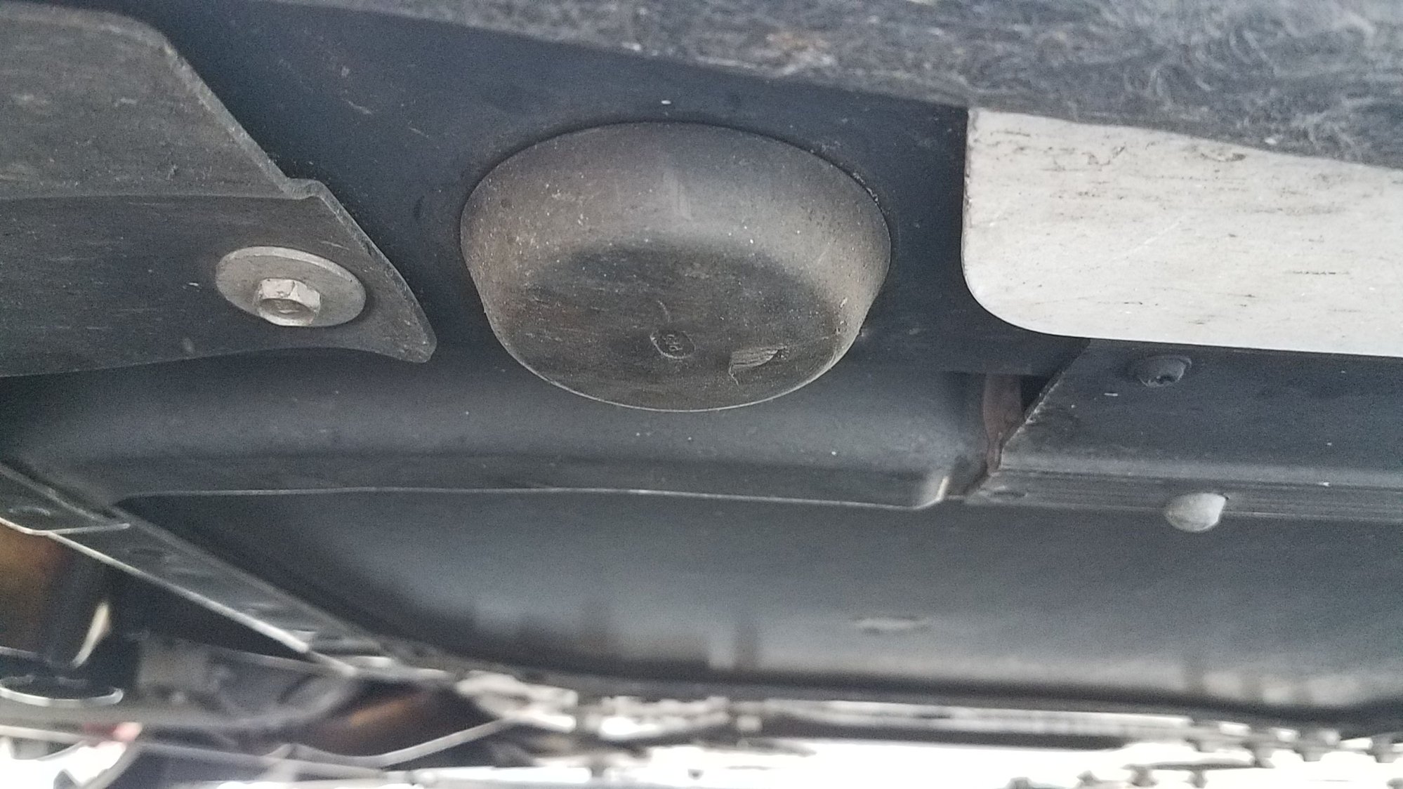

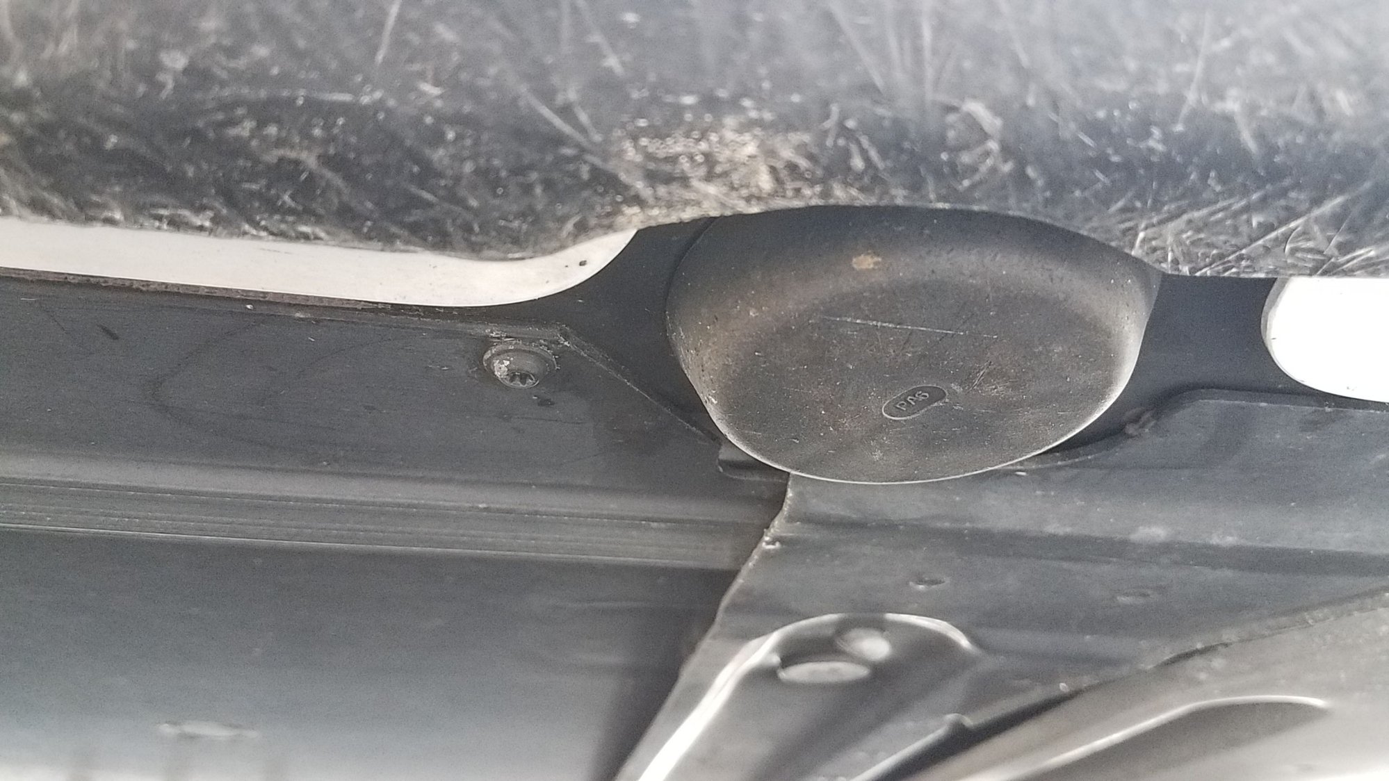

Originally Posted by JDSC7VETTE
These pucks have a very small surface contact because they are not flat and this reduces the amount of friction between Jack pad and jacking puck. During jacking up of the car this reduced friction may cause the Jack to slip rather than making the Jack roll. Combine this slipping and the dumbass round bottom of the puck and rather than the puck catching on the lip of the Jack pad it very nicely climbs over the lip and the car falls off the Jack.
All I can say is, maybe you had a different puck. Here's a front and rear one installed. Looks pretty flat to me. And I'll guarantee that that there's more friction from that puck than any of the round metal ones that you can't leave installed. BMW has been using this configuration for the last 20 years that I know of and probably longer. Like I said earlier, looks to me like you're trying to blame equipment rather than an operator error.
Great illustration JerryU

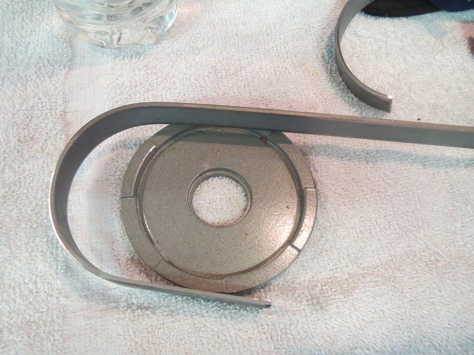

The other issue is many jacks today have shallow saddles. I have 4 HF jacks. They all have shallow saddles. In fact the long arm jack I bought weighed 95 pounds and had a very shallow saddle. Probably so they could advertise a very low lift number. It was not moving in when I jacked. I added a steel lip to mine. Fits fine with a 1 inch high jack pad.
I'm glad that you understand the problem with some of these jacking pucks. I'm also thinking of adding something to the edge of my Jack pad so there is no way the pucks could ever slip again. I'm very confident that my flat bottom aluminum pucks with square edges will work fine but sometimes it better to be safe than sorry.

Originally Posted by edzvet
Good idea. Lots of fun welding steel to cast iron!
Ground off all the paint and if cast, it's cast steel. Could just be stamped then threaded (my estimate of construction along with most of the jack frame.) Configuration doesn't need great flowing cast iron. Welded fine, no cracks!
