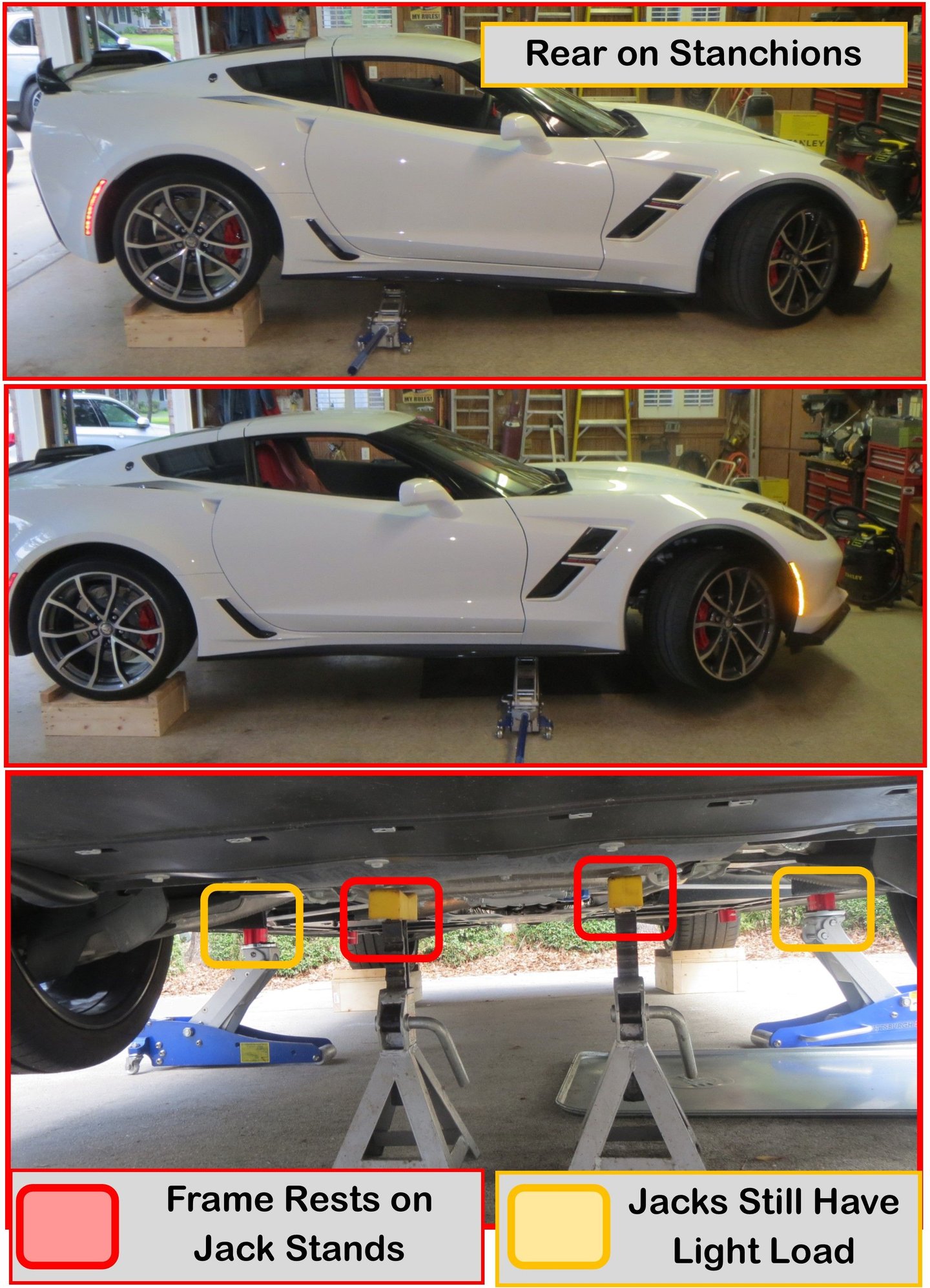

FWIW, for those that want a cheaper safe alternative, just posted this on another Thread:
"Quick Jack is fine IF you want to spend the money. I find these home made wood stanchions (~8 lbs each, two made for ~$10) work fine when I need the car level for an oil change. Also easy to store. For doing lots of work like I did for ~8 months, a lot on my back building my street rod, these 12 inch high stanchions worked great! The only issue is it took a two step jacking process, not something I would do every day so the 7 inch high wood ones I made work fine!
Granted to work on brakes I needed to jack on the frame, built a device to do that one wheel at a time while still 12 inches in the air. But when I installed the side skirts on my 2014 C7 Quick Jack would have been in the way."

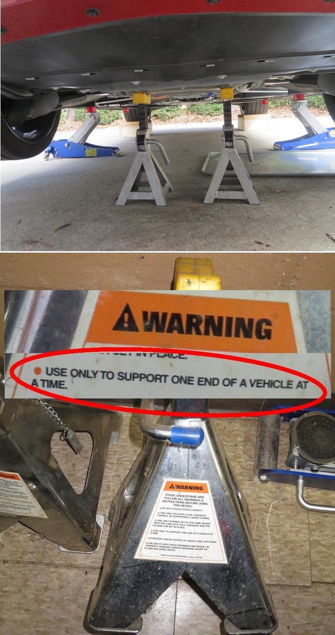

Hmm, have lifted many Vettes (etc) with one jack and placed on jack stands. Never more than one end on jack stands at one time, even warned about on one of my several pairs of jack stands (see pic.)
However you can get two jacks from HF for much less that Quick Jack or a lift. I usually lift a a few pumps on each side and IF I want the car level for an oil change I use stanchions I made for ~$10. (If you're not handy you can buy 8 inch high stanchions from Race Ramps.)
That way if you watch after each jack pump that the jack saddle is centered on the jack pad, no slipping! Anyone would be foolish to get under a car with just a jack supporting!
