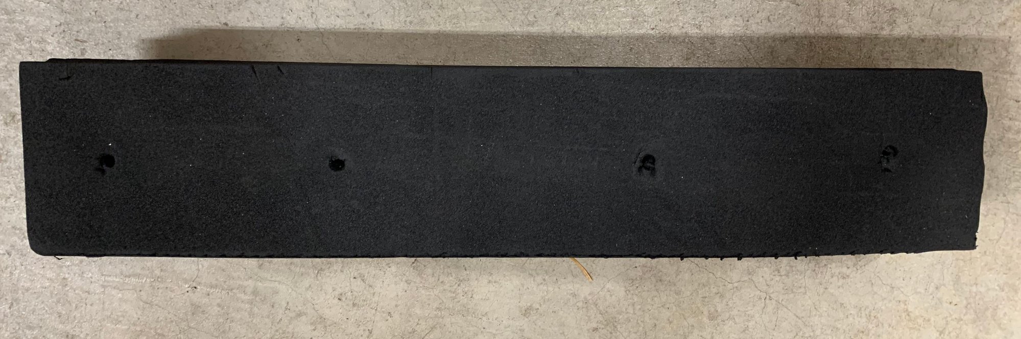

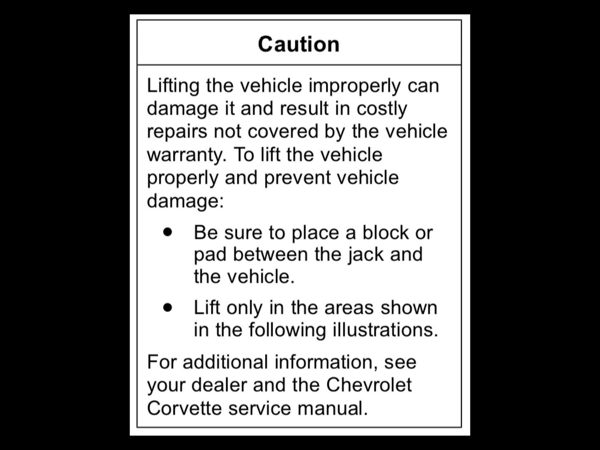

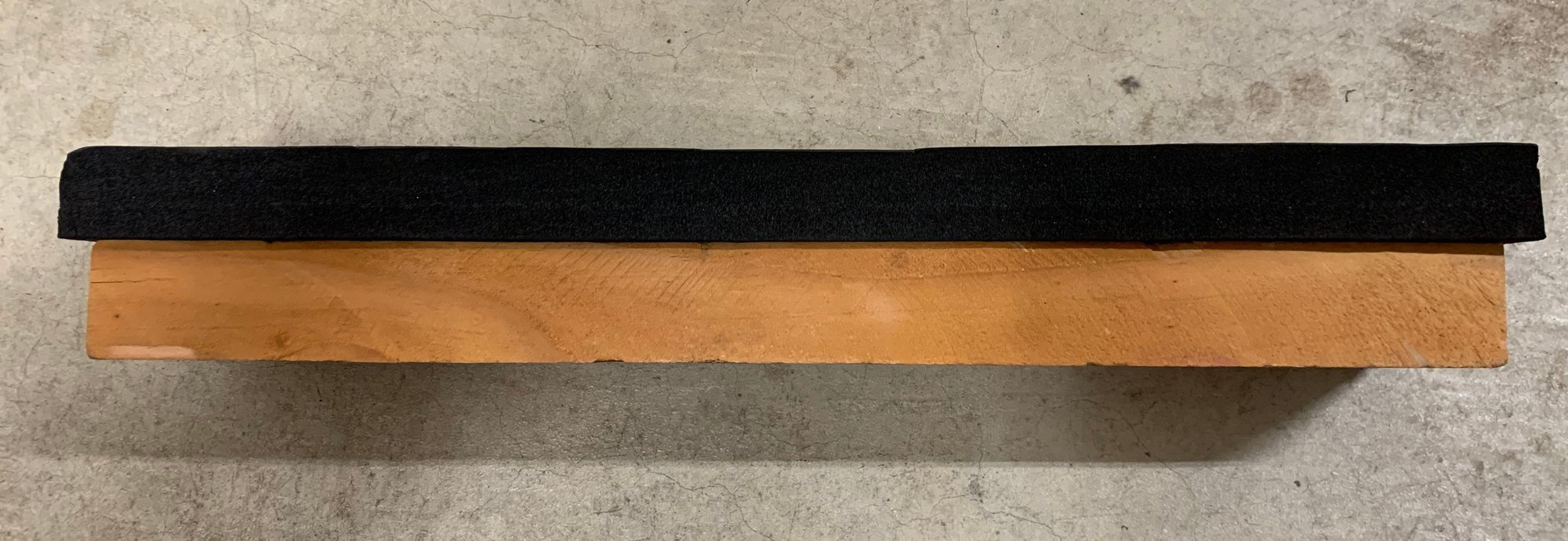

I made this block pad which not only spreads the load the high density foam conforms to the contour along the casting. The foam is so dense it only compresses about 3/8 of an inch when the full weight of the rear is on it.
As an aside the foam is so dense I used screws to attach it to the 2x4.
