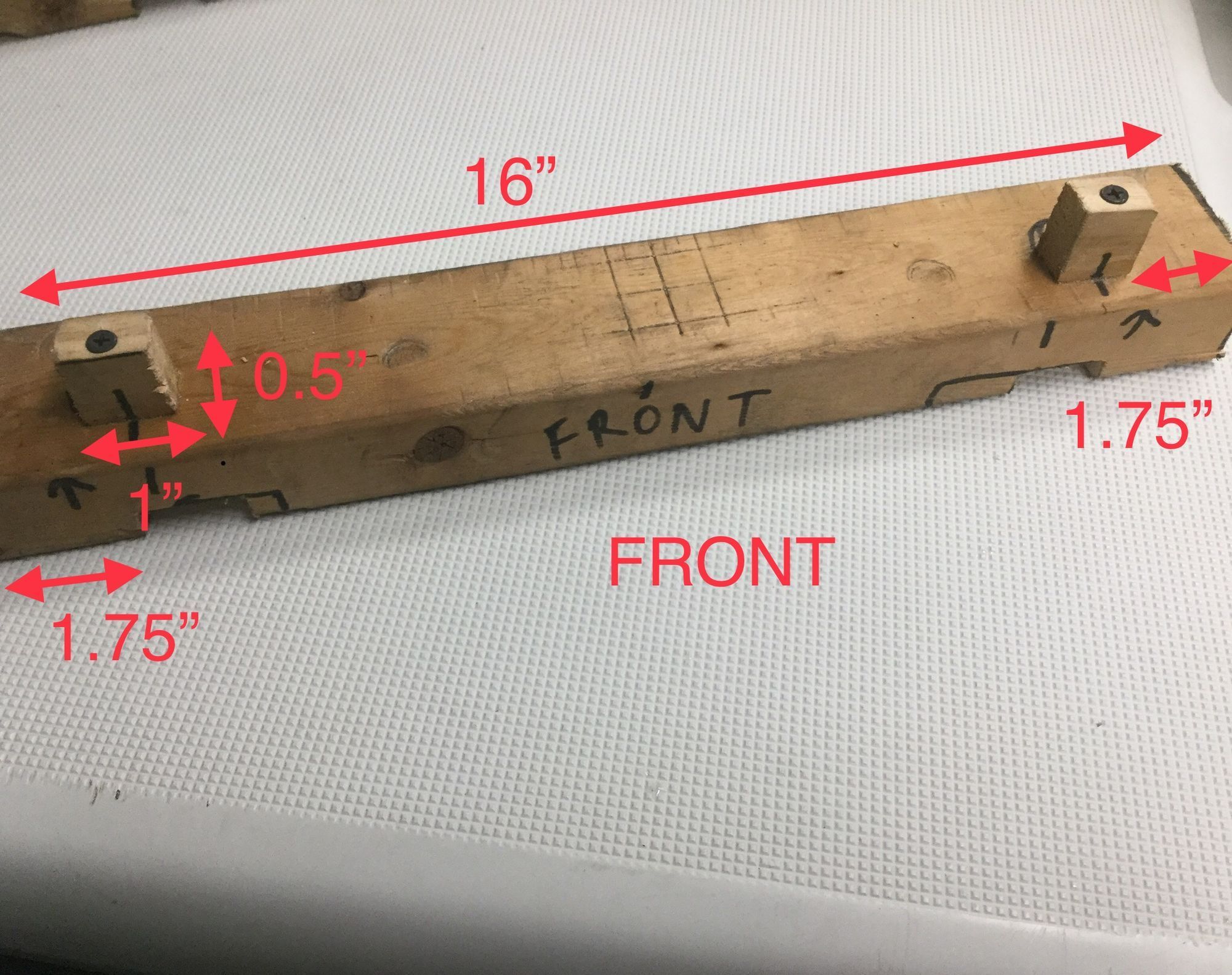

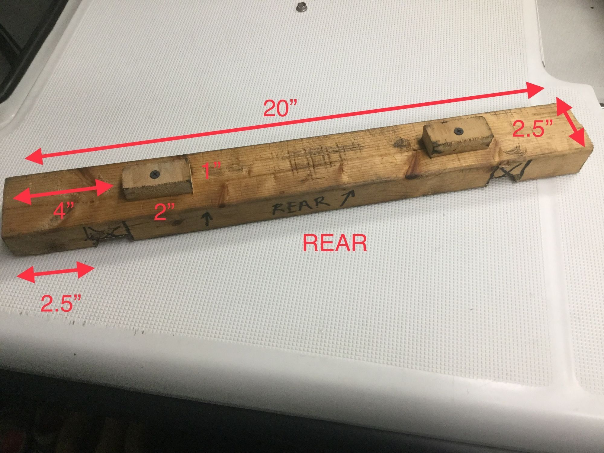

Originally Posted by Zjoe6
Did I see you post a drawing of this block of wood?
Glad you like them. Here are the dimensions... its not super detailed or precise but good enough to get you in the ball park.
The blocks on the top are just screwed into place (not structural) to provide alignment with the holes in the cradle / subframe. Unlike the puck locations there are no obvious alignment marks on the car to aid in positioning the jack stands so I used JerryU's famous drawing to get me started here. The notches were just cut out deep and wide enough to accommodate the jack head.
The first time I jacked the car I noticed the jack heads were notched for a unibody car's pinch welds, which is not good at all for the flat C7 locations. The wood acts as adapter that converts the curved jack head into a wide, flat surface which is ideal.
The main goals in the creation of these pieces were:
1) to ensure the jack stands are placed correctly in the factory locations every single time without measuring
2) distribute the vehicles weight along the width of the hollow aluminum cradle with no stress or pinch points
3) reduce the risk of the jack stands moving due to slipping, tipping, or twisting as you lower the car onto them
4) keep the metal jack stands from damaging the soft, thin aluminum cradle
Some have suggested an improvement would be putting high density rubber foam or an old tire tread on the top for addition slip resistance. What I've noticed (and you can see in the picture) is the wood is soft enough that grid pattern on the cradle digs in slightly so I don't think they could slip as is... however an extra safety margin is never a bad idea.

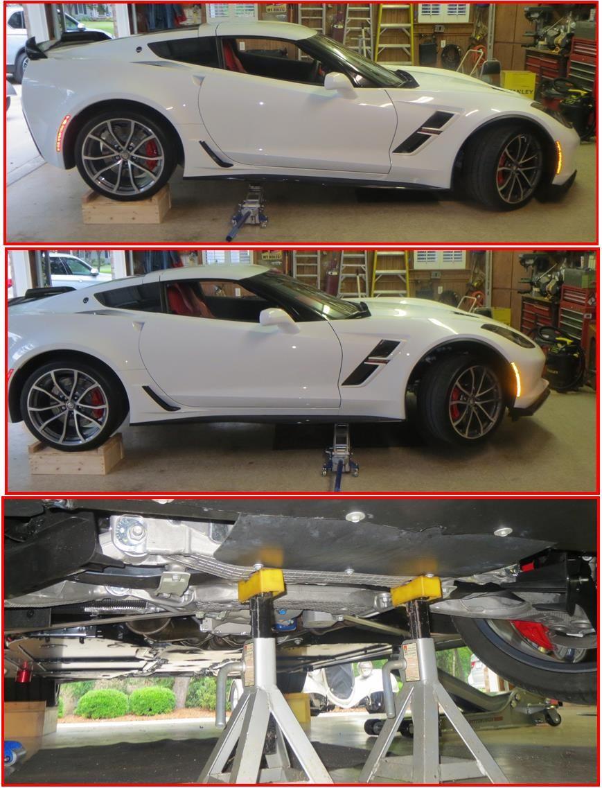

Originally Posted by Maxie2U

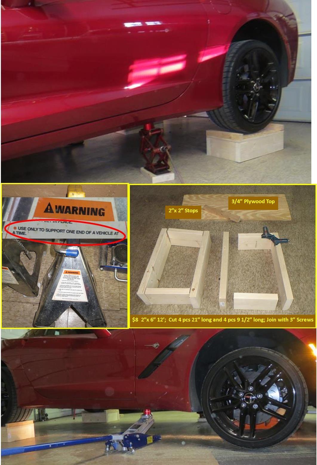

Congratulations on finding a lift at the Navy’s hobby shop . Depending on which lifts they have the lift arms “could” be too tall to get under the C7s jacking points especially if you have jacking pucks in place. That would mean you will need to jack up the rear of the car high enough to get the lift arms under the car. If you need to do that you’ll need a 2x4 with rubber pad (like the one I pictured above) which you place on the top of the jack cradle BEFORE jacking under the rear cradle suspension cross section. Why is that important? The cradle suspension cross section is a light weight HOLLOW CASING and can be cracked if jacked improbably which would be a extremely costly mistake!
Remember to use/install jack pucks in the four C7 jack points. Do not use the bare lift cradles to lift the car unless you have jack pucks in place.
Yep, as I posted that is where to lift BUT I would not get under a car supported by 4 jack stands. In fact one of my quality pair has a specific warning against doing that. If messing with the exhaust the loads placed on the car make the thought even worse.
For oil changes I made stanchions from a 2X6 and plywood. You can buy them but my wood ones weigh less than 10 lbs.Pic of my Grand Sport shows them being used for the rear tires and jack stands for the front. I now use two hydraulic jacks progressively lifting each side. For added safety I leave the jacks in place with a light load.

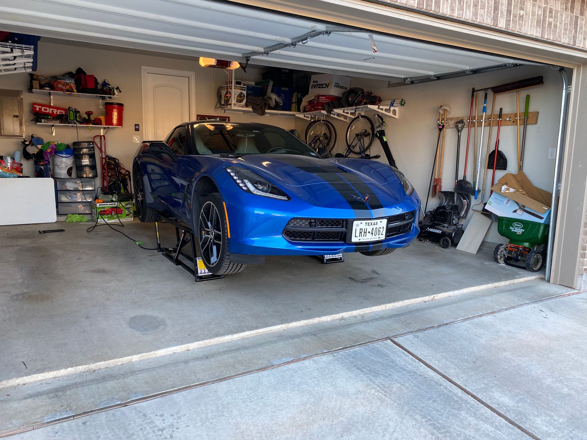

I purchased one of these on Black Friday. I received it yesterday and tried it out. It’s amazing!

I just purchased something similar from CostCo. Since the lift takes up all 4 pucks, where would be the best place to put jack stands? I don't care if I don't "need" them, I'm not getting under a car without every possible safety measure.
see the red dot locations in the diagram post #66

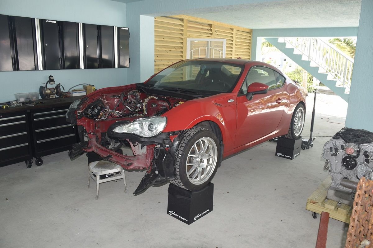

I use jack stands when needed,, but prefer Race Ramps. For the Vette,, jack up front put half blocks in,, jack up rear put full block in,,, jack up front put another half in. You will need a 24" jack.
More room getting in and out, it'll never fall,, very light weight and easy to store.

[QUOTE=Akcajunz;1600518385]I have my new AWE X-Pipe that I am very anxious to get installed. I’ve looked around to find out if anyone close by has a lift of some sort that I could rent for a couple hours.....
I installed my X pipe Saturday myself by driving up on my Race Ramps (10 inch) and had zero issues reaching anything. I have a 2019 garage queen so no rust/corrosion to deal with.
